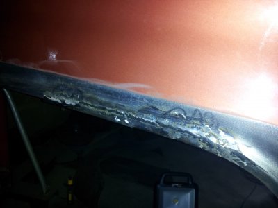

Re-doing fender lips is my absolute least favorite part. I ended up getting a "repair panel" off ebay that didn't even resemble a Charger... I mean, it was horrible! Just a rough made approximation of a fender. But, it gave me a lip to start massaging so it resembled what I needed to do the job. It took hours of hammer and dolly time and ended up looking like a total Frankenstein job when I was done. But it all works out in the end. Keep on movin' on Conv67bdere! It's looking great! :)
Glad to see your sacking up and getting after it haha. Wish we were closer, I'd be more than happy to lend a hand but it looks like your getting it just fine. Nice to see you back to work on the wheel openings and your new approach should leave you with the flare you wanted.
Thanks 747 Mopar . . . Hopefully I'll get better, the driver side is a MESS . . . slowly, I'm getting the hang of it . . .

no problem khan, you got this far whats a little fender lip repair. LOL. its only gonna make you better. keep up the good work

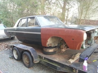

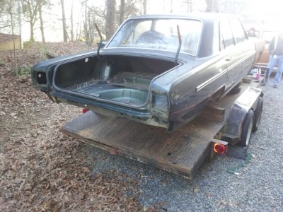

Little side trip was taken yesterday . . . found a potential project . . .

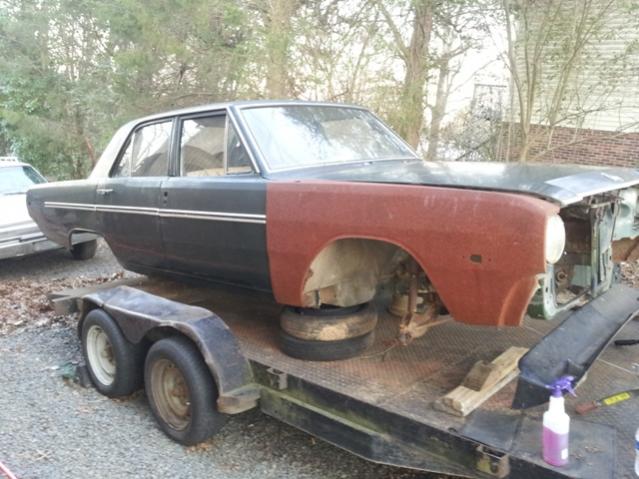

Found this nice shell on CL - the amount of rust on this car is minimal . . . I was amazed.
Thinking of picking this up for the next project . . . front fenders were replaced with a 72 Dart ( originals were dented pretty bad I was told )
Look at the lack of rust in the trunk - it's ALL painted ( very little rust in there too )
Most of the trim pieces, bumpers, grille, headlights, dash components, steering wheel . . . are gone . . .
I would advise against it Khan. You can find a nice A body that is complete and running for a very reasonable price on CL if you keep looking. When I was helping keep a lookout for an A body for Propwash I saw a quite a few complete cars for < $1.5K. A complete car will save you a lot of heartache in the long run. No/low rust is a good thing obviously too.
How much are they asking for that?
Thanks Tallhair . . appreciate the feedback . . remember, my 1966 Shoe Box is a 4-door too . . not opposed to them ( maybe make the rear doors suicide doors )
Finding a car that is not a rust bucket is becoming few and far in between, so my thought was to get while I can and get to later.
I really like the body style - what can I say ? ? Don't "need it", but I'm thinking of making him an offer to get it off his trailer so he can use it . . . we'll see.

My only advice comes from my way of thinking which is based on being broke more often then not. I won't tackle a big EXPENSIVE project unless it's something I really, really, really love so just ask yourself that. It does look pretty solid and if you get it cheap enough it could always be a great donor for a Sweet 2 door Dart if nothing else. Kinda hard to top your 67 vert
You're dead on with that advice 747 Mopar . . . I had a "max" price that I would go to obtain the car and keep it for another project - we couldn't come to an agreement on the sale price - so I'd much rather focus my attention on my Belvedere.
The dart was VERY SOLID . . . but I guess it was just not meant to be.
Probably all for the best - I've got a Belvedere that needs some love and attention to get her back on the road ! ! Oh, and my 66 Shoe Box waiting in the wings too ! !
Thanks 747 Mopar - I guess I'm kinda partial to the 67 Belvedere Convertible too - glad you like it too.

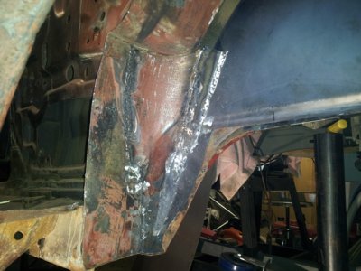

More Belvedere wheel well / mini tub work . . .
Spent most of the day ( it raining down here ) working on the wheel lip and trying to figure out how to work the outer wheel well construction into the re-building of the wheel well lip on the passenger side - the side I've been working on it seems like forever . . .
needed to get the outer wheel well in place at the same time to figure out how to get everything connected properly . . . seems to be going well . . .
Here where I've gotten so far . . . more of the lip replaced . . .
And some work on the inside - I think this will help accommodate about any size wheel that I want to put under here NOW ! ! !
The re-building of the inner wheel well is going much better than I anticipated - but - I haven't started welding the top ( over my head yet ) that is when I'm going to have a whole lotta fun - and probably end up getting burned more than I am now . . .
Hope this whole thing works out - trying to match up inner wheel wells with visible wheel flares and make it all look correct . . . oh boy . . .

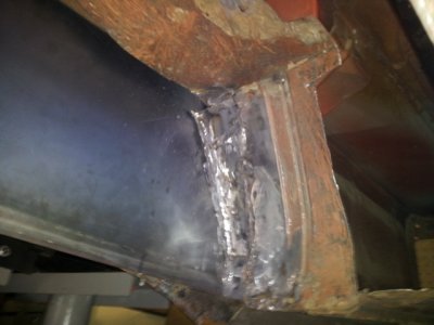

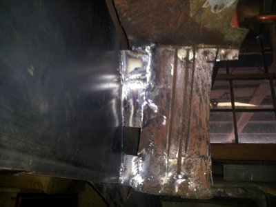

Even more progress on the mini tubs . . .
Thanks to the rain that we've had all day, I've been able to focus my attention on the Belvedere . . .
The front side . . .
And I finished off the back . . .
I think we'll be able to have a party in here - there's plenty of room . . . ( smile )
Once I get the top welded in, then the inside can be welded to the frame rail, then the 3 inch patches get welded in after that . . . think I've got this thing figured out . . . at least in theory . . .
