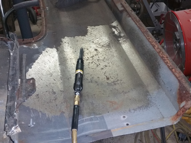

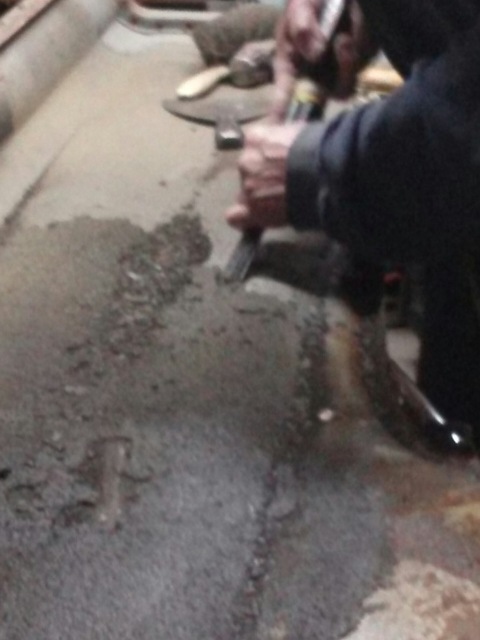

( ARGH . . . thought I was done with the undercoating removal ! ! ) It was pretty thick on this panel in places . . .
But the needle scaler did pretty fast work of it . . . plus not being under the car and having it all fall in my face was a nice change of pace . . .
After about 10-20 minutes of work . . .

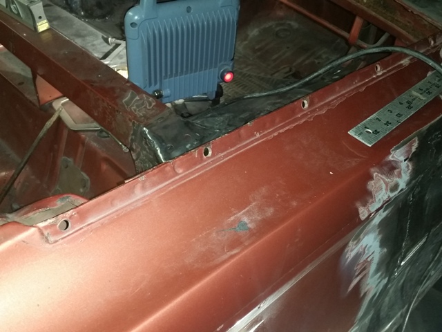

The edge of the trunk has been completely separated from the rest of the car . . . it turned out very nicely . . .
Another shot of it - further back on the car . . .
Need to figure out how to cut and weld this in as this area on the convertible is very different from the donor car that I got . . .
Think I may have to cut midway across the top of the panel to behind the rear window . . . and then use the truck lip all the way back . . .
I think I have a plan, but still got some parts to remove off the panel before I can check fitment . . . but it is going well so far ! !

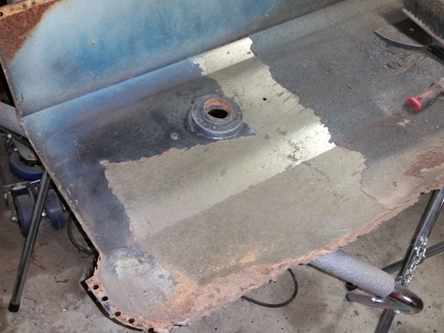

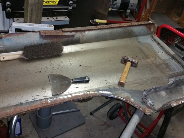

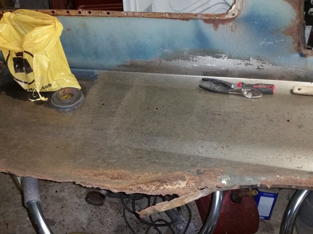

So I got out to the shop tonight and got all the rest of the undercoating removed from the quarter panel . . .
This thing is so loooonnnngggg that I can't get it all in one picture . . .
This panel is in really good shape, but still has areas that I will need to patch . . .

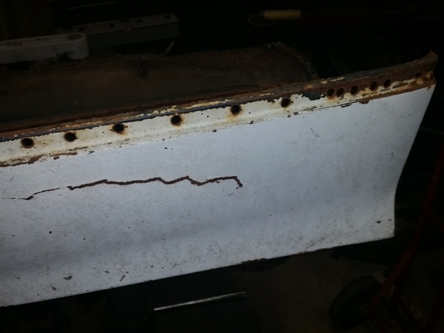

Ok . . . not really forgot . . . but it is all relative . . .
when I first got it and compared it to what was on the car I asked WHY did they get this, the one on the car looked WAY better . . .
That is, until I found out how much bondo was caked on the side of the car . . .
So . . . now looking at the donor quarter panel - it is really looking a whole lot better then when I first saw it . . . depends what you have to compare it to ? ? ?

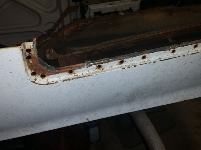

Finally got all the non-quarter panel metal off the donor panel - that was not playing nicely with me, but I was not going to let it win . . .

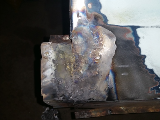

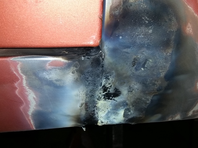

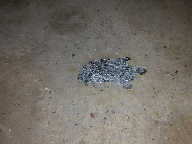

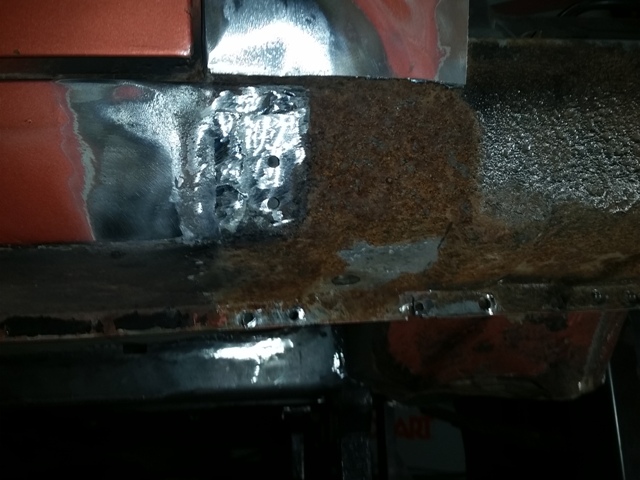

Here is the progress . . . first sweated the lead off the donor panel . .
I was surprised at the amount of lead in the panel . . .

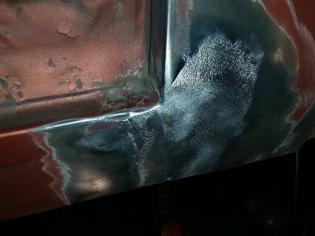

Then I had to get the paint off the car and get it down to the lead . . .

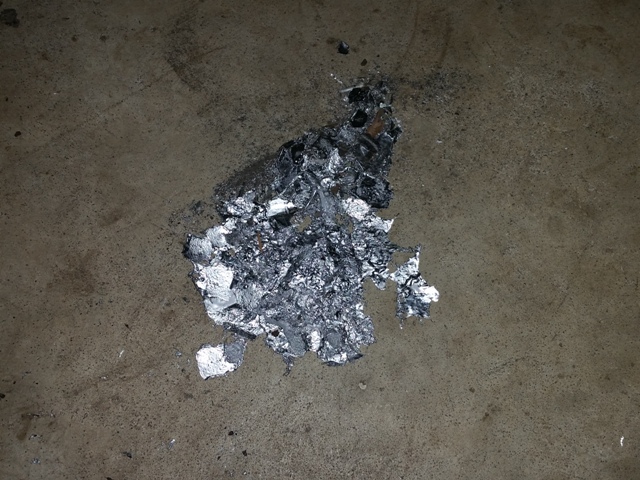

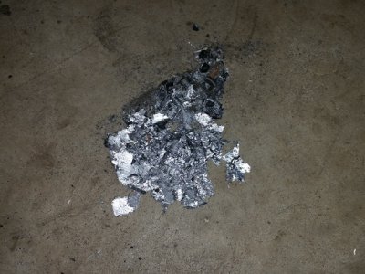

Then it is time to sweat the lead off the panel on the car . . .

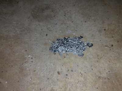

Once again . . . a nice pile of lead on the floor . . .

Now I have to drill out the spot welds up the door edge . . . and across the back and trunk areas of the car . . . it it coming off this weekend . . .

My daughter stopped out to the shop and took this picture of the needle scaler doing it job removing the undercoating from the back of my donor panel . . .

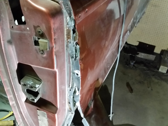

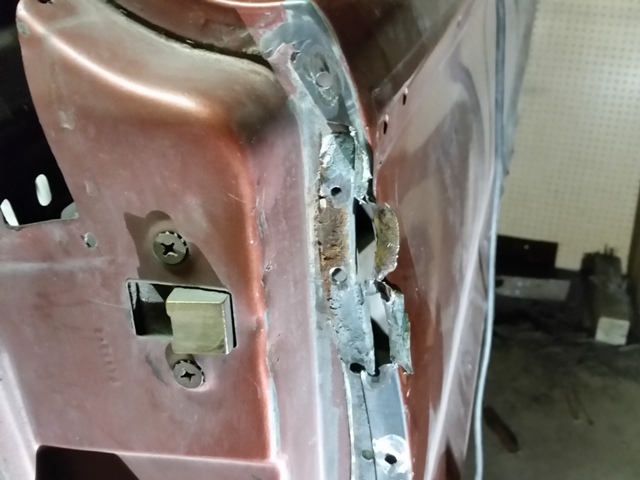

started at the bottom, drilled out the spot welds, and then pried the panel out . . .
Worked my way all the way up to the top . . .

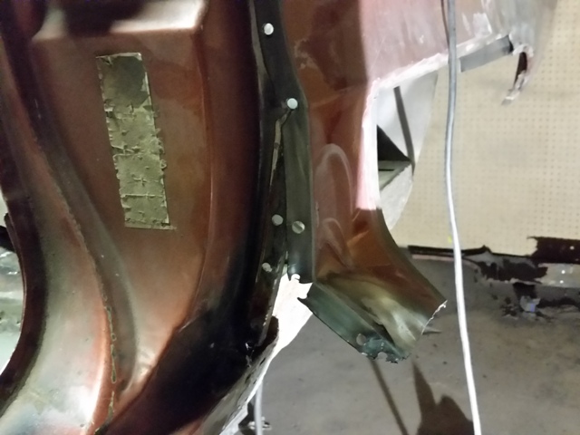

And now I've got the panel detached from the car at the door jamb . . .
Now to move to the back of the car and get the trunk seam and the rear seam . . . the bottom is all rusted out and nothing to cut free . . .
A little easier way to get them off is to remove the majority crudely (only leaving the spot welded areas) and then come back and peal the spot welds loose. This makes it easier to work the welds loose instead of fighting a stiff panel. Glad to see your getting her

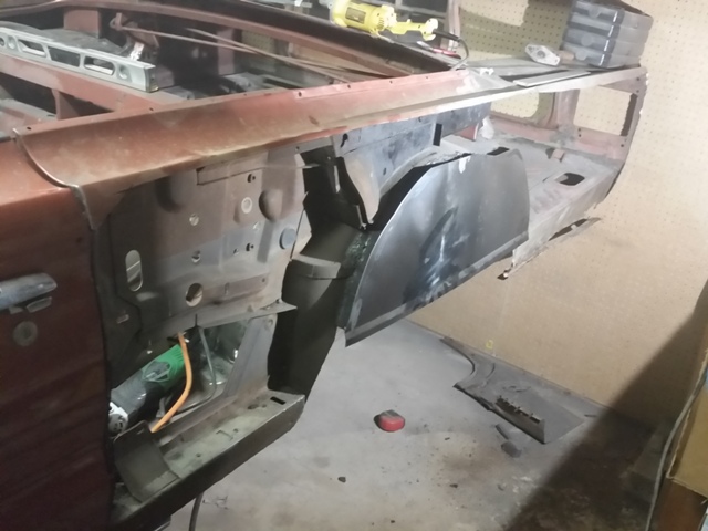

Now my car looks naked . . .
Took to the shop tonight and decided it was time to remove most of the old panel . . . and now my car looks naked ? ! ? ! ?
Now to work on figuring out my lines for cutting and attaching the new panel . . . getting there ! ! !

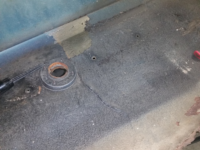

More quarter panel removal and cleanup . . .

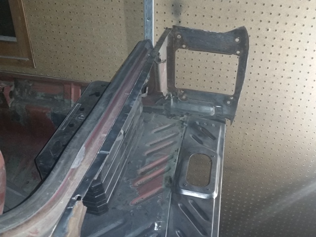

Got a little more done on the removal and clean up . . . and it is coming along quite nicely too . . .

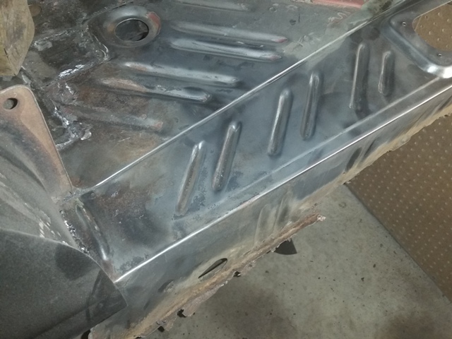

And some work on cleaning up the floor of the trunk while I can get to the areas, the metal is in really good shape . . .
Still got some metal to remove from the outer edges of the panel on the back - but the car is so close to the wall I can't get to it ( yet ), will have to get the car moved forward to get the metal removed.
