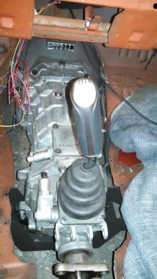

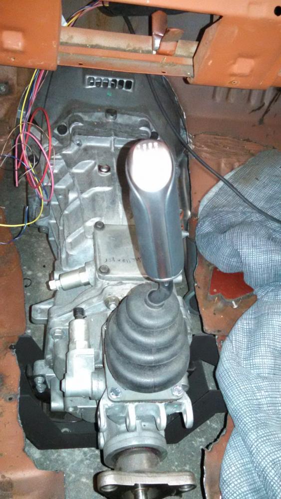

wow that interior setup will be awesome. on my six speed setup khan i found the short throw shifter on ebay and is a direct bolt on in place of the rear top plate on the trans. then i found a 2013 modern pistol grip out of a challenger. it was brand new for $75 bucks and the shifter was $120. they way your welding now you can just do about anything. i looked at a new viper the other day and i think those rear tires were like 345 or 355. i was like oh baby i know someone that can stuff those in the khan-vert. lol

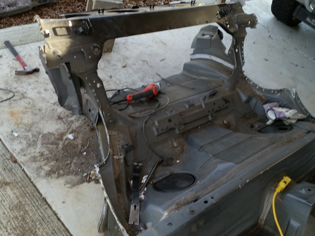

Dissection continues . . .
the work to get the needed metal from the rear section of the 2013 Challenger continues . . . and it's making good progress . .
I thought this would be a quick and easy process to get the metal separated that I needed for the rear seats . . . WRONG . . . but it is an interesting process and I get to see how the new cars are put together . . .
Then the re-installation in the '67 Belvedere will begin . . . and a whole lot more fun to boot !

Rough cutting is completed . . .
The rough cutting of the seat metal is complete . . . after (3) days of working on it, my neighbor came over and asked "What are you doing ?" . . . so I explained it to him, and he said you're taking a long time - he lent me his sawz-all . . . and that kinda helped . . . then he said you need to use my plasma cutter . . . Well, I don't have one but I'v used one in the past . . . in less than an hour, the rest of the rough cutting was completed and it's ready to go into the car for the fine tuning . . .
So the lessons learned from this . . .
1 - a sawz-all can be a great help
2 - a plasma cutter is THE BOMB ! ! !
It made easy work on the most difficult part of the rough cleanup process . . . once again, my neighbor comes through ! ! ! He's probably forgotten more about cars then I'll ever know . . . except for one thing . . . I don't think he's forgotten anything ! ! He's amazing ! !
I got a picture, but it was late, and dark . . . and the pic didn't turn out very well . . .
and now I've got to figure out how to get the thing into my car ? ! ? ! ? ! ? . . . and I still have some fine tuning to do on it too . . . OH BOY ! ! !

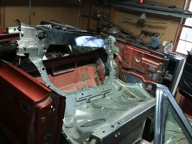

Let the "fun" begin . . . now it's time to try and make it fit . . .
Got the rear seat section moved into the car, and tried to get it into position . . .
Now the fun begins . . .how do I make this fit seamlessly . . . and look like it was part of my car . . .
FUN, FUN, FUN . . .

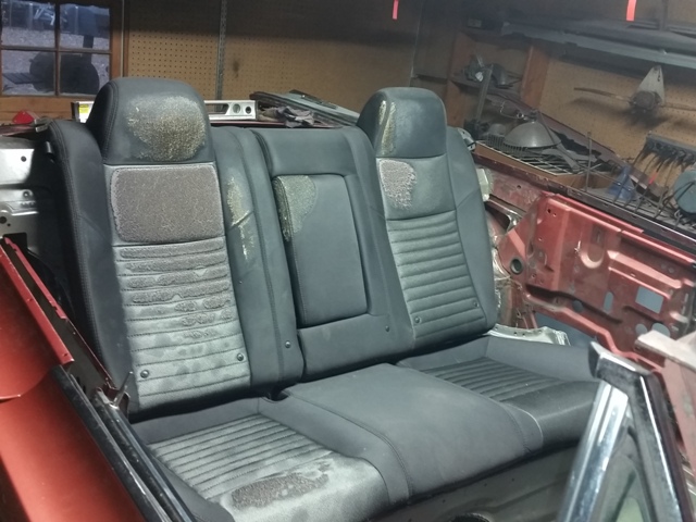

More progress . . . the seats are coming together nicely ! ! !
After 3 hours of gentle "massaging" of the seat metal frame ( yeah - BFH ! ) the frame has been somewhat fitted into the back seat area and the seats will look like this . . .
The fine tuning is not done . . . there is still more adjustments that will meed to be done . . . but I like what' I'm seeing so far ! ! !
Now to continue the "adjustments" to the seat frame . . . ( smile ) . . .
Those seat look badass in there, me likey! Don't forget to get the fronts in and check your rear view mirror, the high Chrysler 300 rears in mine totally blocked the rear view mirror to where I had to lower the middle. Very nice addition
