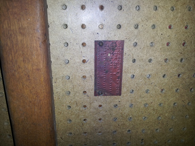

going back to your question, just take the two screws out and remove your fender tag. nothing special really, its just a stamped metal tag screwed to the car. I screwed mine to the wall for 2 years while I worked on the car and then came back, cleaned it and painted it while it sat on a piece of cardboard.

Thanks KB . . . sounds like a great idea - screw it to the wall ! ! ! Works for me.

Well KB . . . like your idea so much that :

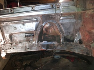

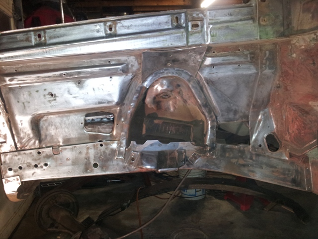

And pulled out the tools and attacked the driver side inner fender . . . got a great start on it tonight . . .
Getting closer to getting this whole front clip cleaned up so I can get it in primer . . . looking forward to that . . .
You are doing a fantastic job, looks really clean and your patience doing this is showing as nice as that looks!

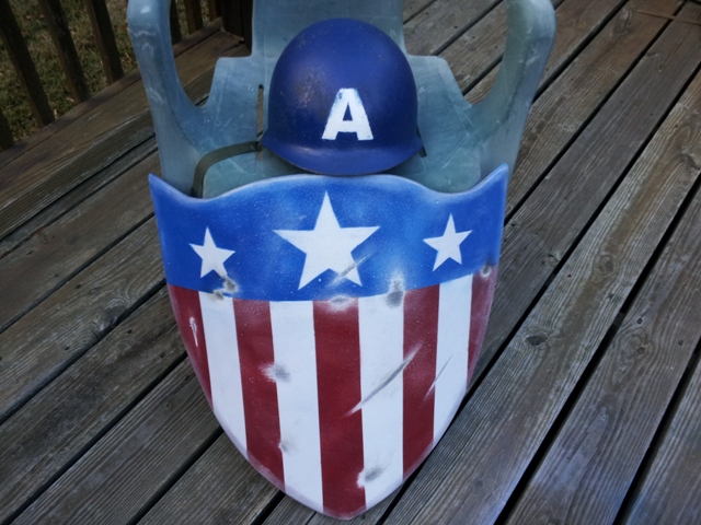

So my daughter is working on a Captain America costume, and I needed to assist her with some of the details - I won't take credit for the painting and broken in look of the shield - she did a great job on it all by herself.
I think the results of the costume look fantastic ! ! !
She sure did do a great job, my boy wants to be a trash can "really".

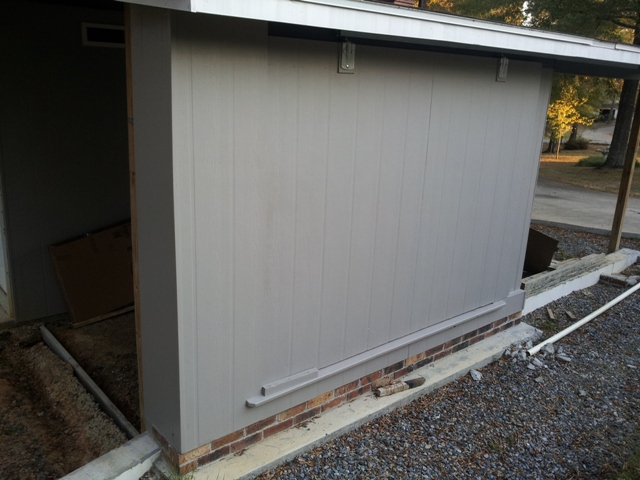

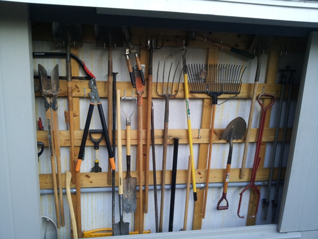

In addition to re-building my Mopar, I've got another project that I'm working on for the house. It's a combination of my well house, that has been extended to not only contain the well pump, but it's got additional storage - we always can use more storage ! In addition, I've created this neat little "shallow" storage area . . . and if you look at the picture I'm sure you'll be wondering - why would one make the storage area so shallow ? ?
Here's the picture of this area - as you can see, it's only about 1 foot deep:
Well - it really comes in handy and organizes my stuff so I'm not tripping all over all the time - and all within easy reach:
Storage for all my lawn and garden tools for around the house:
Works very well - just thought I'd share this little idea with the group.
That is so cool. I didn't even know what 1 foot area you were talking about until I saw the open picture. Very cool idea / use of space / organization.
Thanks TALLHAIR - I needed to do something to keep that stuff organized and easy to reach . . . and was going to put it in the storage area of the carport ( I didn't show a pic of the whole carport - guess I need to do that ) but then it would still be sitting there and in the way - came up with this idea and made it work - LOVE the result ! Thanks for the compliment - very much appreciated ! !

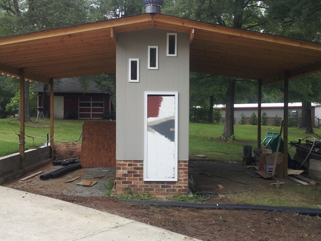

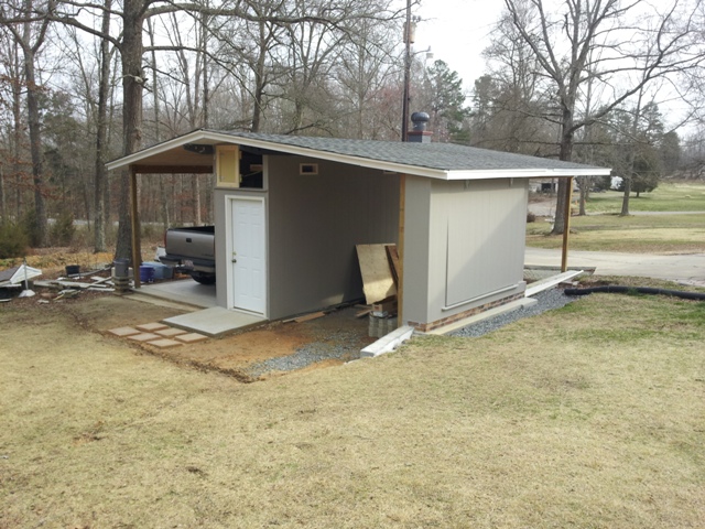

Here you go Tallhair . . . additional picture of the carport. The center section is built around my well house, so I just extended it all the way back, added a door, and made it for storage too. The door on the top holds the canoe - easy access for getting to it and storing it. The tools "were" going to go in there, but they would still be out of reach, so that's why it got moved to it's new location.
Still got to get the upper side of the carport poured and ready for car parking:
In addition, I've run a 50 amp plug in the tool area, accessible from the car side, to be able to plug in the welder and work on projects.
This is still work in progress, but it's getting there.
Thats the coolest car port ive ever seen! Mine looks nothing like that.. I like it!

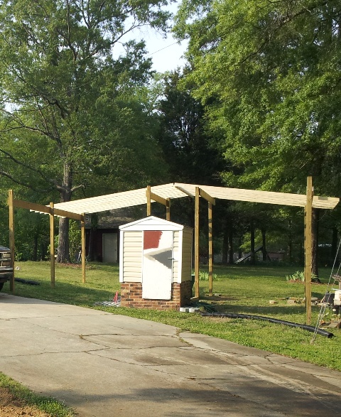

The carport . . . part of the reason . . .
The honest truth of the matter, is the carport was started, not only to protect my vehicles, but because the original well house looked like an outhouse sitting at the top of my driveway ( and I got tired of it ).
Here's the start of the process . . .
Then I worked the well house into the design of the carport as follows:
Now you can see how the outhouse vanished, and the carport replaced it . . .

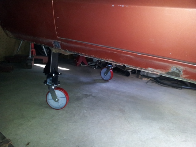

Alrighty . . . I've got a roller ! ! ! ! ! well, sorta . . .

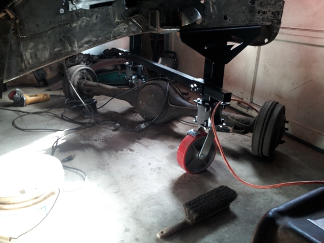

Finally got this job done and got my casters installed on the Belvedere this morning - now I'll be able to move the car if needed.
Here's what I've got - the rear caters:
And the front casters ( yeah, my rear end is in the way ) . . .
That may help a little - seems to help with more room under the car . . .

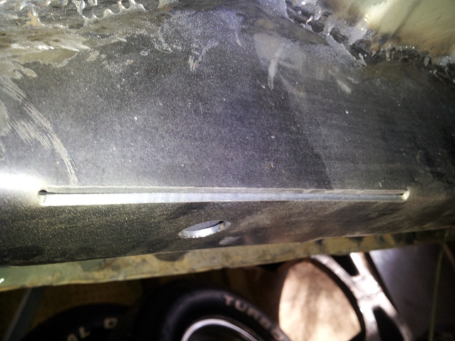

Back to finish up frame connectors . . . forgot something . . .

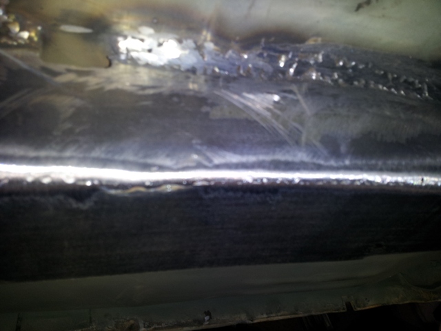

Turns out the the frame connectors from US Cartools needed one additional piece of work to complete them, and I missed it. The connectors come with some reliefs at the bending locations, probably simplifies the bending process. After installation, the reliefs need to be welded up - to make them continuous and probably make them that much stronger too.
So, the reliefs look like this:

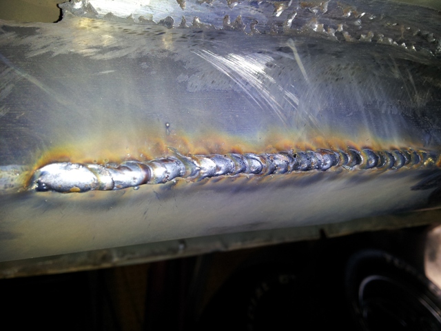

So I've welded all of the reliefs on both frame connectors ( 12 of them in all )
And gone back and done some initial sanding of the welds to clean them up . . . more sanding will be done to blend them in to the rest of the frames.

Those casters look like they will for sure make moving your car around easier. What's the weight rating? just curious. I could've used something like those before I put the motor in mine.

I'll have to go check them, not sure they say on them . . . but I'd have to guess they're more than 1000 pounds rating - they're pretty stout ! ! And HEAVY ! ! !

Good looking weld on those connectors...somebody is learning!
