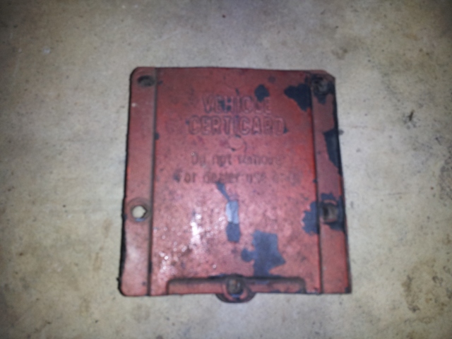

Alright . . . so I'm in the process of cleaning up the engine compartment - I'm shooting for the clean look under the hood. So I'm removing all the pieces and parts that can be removed and welding up the holes.
Including this part that says " do not remove " . . . ruh roh . . .
So, the certicard holder is in the engine compartment - but nothing in it . . .
I assume it's "important" for pure restorations - but if I'm aiming for a driver, then suggestions ? ? ?
Is it strange that my holder either never existed or was long gone? It was a one owner car too, I have to original title they received after paying off the loan.

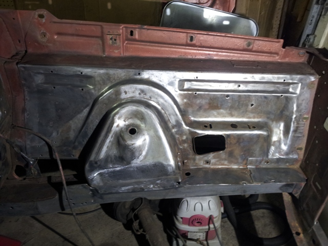

But I did spend a little time working on removing more paint from the engine compartment side of the passenger wheel well . . .
It's coming along . . . slowly but surely . . .
Maybe for the "pure restorations" but you can always keep it for a later date. Honestly as a driver you could clean it up and paint it, would look good in there i think! Just sayin...
Thanks for the input . . . trying to decide what to do with it . . .
Interesting KB . . . might leave it off, so that it can be offered to someone else ( if they need it for a complete restoration ) . . . that could help someone out.

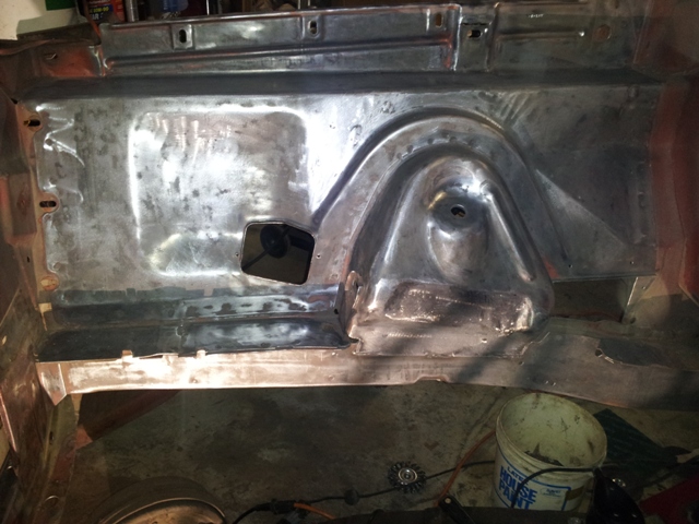

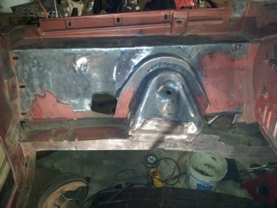

Got a little time in the shop tonight ( wish I was welding now and all Summer when it was HOT ! ), and got a chance to dig into the engine compartment side of the passenger fender - so I can have both sides completed.
This is how it looks now:

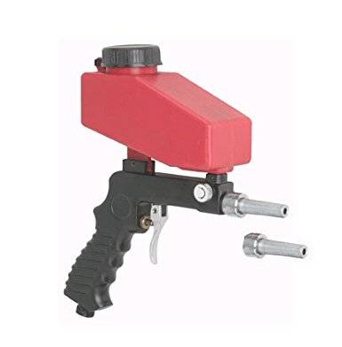

The hand held media blaster looks like this:
It was only 10-20 bucks, so I thought I've give it a shot - got friends that have been wondering how well they would work. So I guess I'm falling into the product review category on this one and I'm curious myself. If this doesn't work too well, I might have to step up to a much larger portable unit. My plans are to try and build a plastic enclosure around the area to "try" and contain the "royal mess" ( does that beat a "full media storm" ) . . . and allow me to recapture the media and reload the gun.
Don't know how it'll work yet . . . I'll let you all know when I get the product reviewed and the enclosure tested out. ( could be a disaster )
That should work good, The biggest thing is your air compressor, if its large enough to keep up with the blasting you'll be ok.. Mine is small, i mean for blasting and i still use it but i have to wait until it catch's up.. Pain in the behind but i cant get another larger one right now, to many other irons in the fire thats expensive.. Good luck with it!
I used that same handheld blaster a couple of times on my project. Its only good for very small light blasting - and it will make a mess. The volume control leaves a lot to be desired. Doesn't take long to empty out the small hopper. It did work though on spots of parts that were to big to get in my cabinet. So it does have its place, but don't have too big of expectations for it.
I bought the 30# unit from harbor freight and that does a great job for $50. Hint...the media can be bought cheap at menards...real cheap $7 for 50#.
I do have to strain it though...literally use a kitchen strainer as I load it.

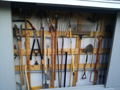

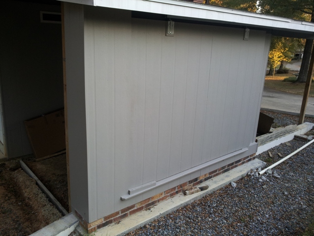

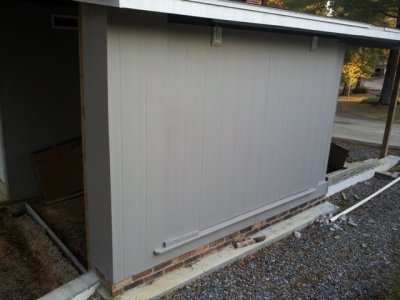

In addition to re-building my Mopar, I've got another project that I'm working on for the house. It's a combination of my well house, that has been extended to not only contain the well pump, but it's got additional storage - we always can use more storage ! In addition, I've created this neat little "shallow" storage area . . . and if you look at the picture I'm sure you'll be wondering - why would one make the storage area so shallow ? ?

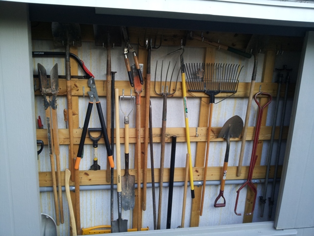

Here's the picture of this area - as you can see, it's only about 1 foot deep:
Well - it really comes in handy and organizes my stuff so I'm not tripping all over all the time - and all within easy reach:
Storage for all my lawn and garden tools for around the house:
Works very well - just thought I'd share this little idea with the group.
Thats a pretty cool idea. Great use of a small space there! I just hung mine on the wall when I built my storage shed. Now if I had only built that shed as a 2 story....

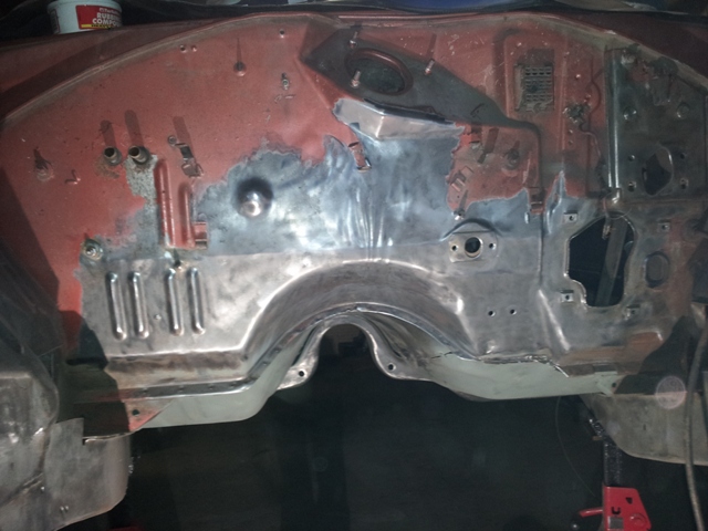

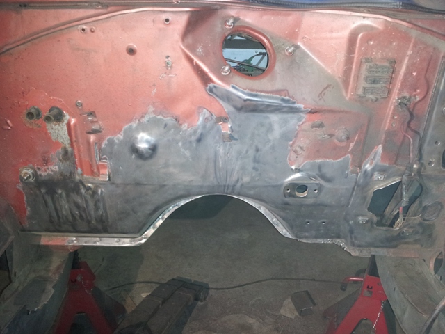

First the driver side engine compartment needs to be stripped of paint:
And while were in there ( making engine sounds and pretending ) might as well work on the firewall too:
And another look at the firewall cleaning process:
And the questions:
On the fender tag, can it be removed to work on cleaning up the engine compartment ?
The fender tag has been painted - should it be cleaned ? Painted with the car ?
The fender tag indicates that this is a HP 383 car . . . uh, there's no motor . . .
Any helpful pointers on how "not to mess up my fender tag" would be most appreciated ! ! Thanks in advance.
