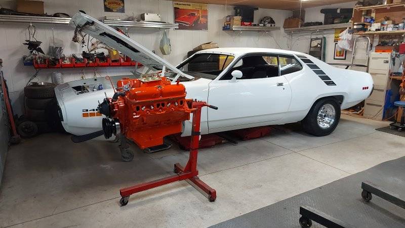

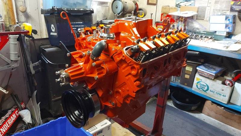

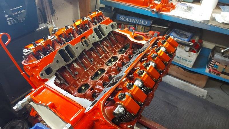

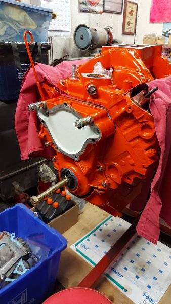

With that big task out of the way, it's back to working on the engine.

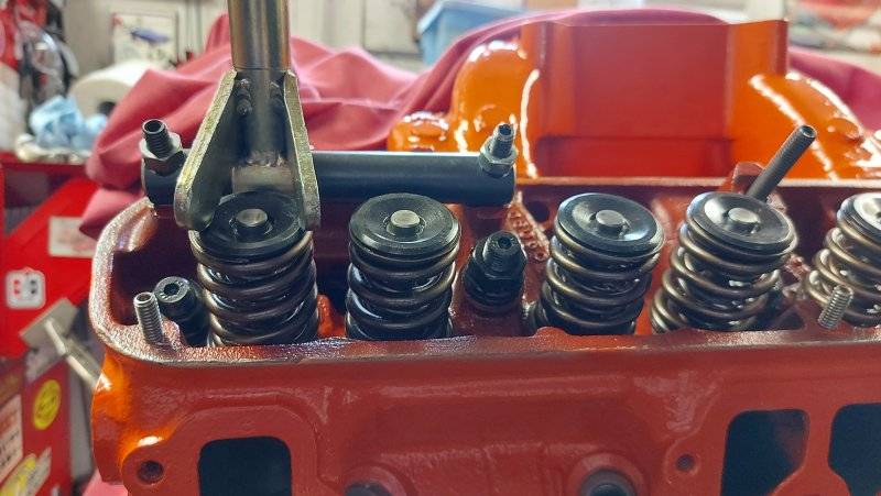

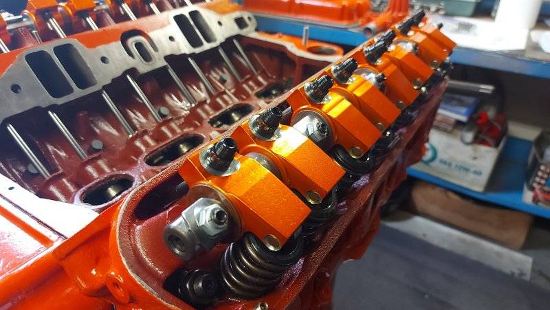

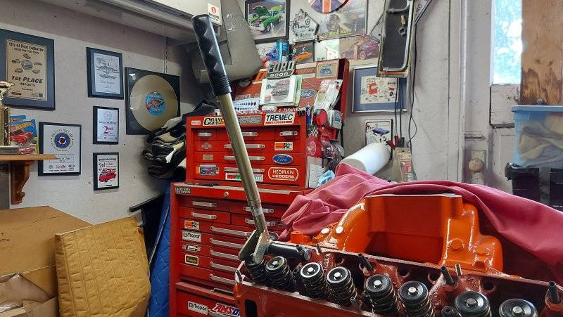

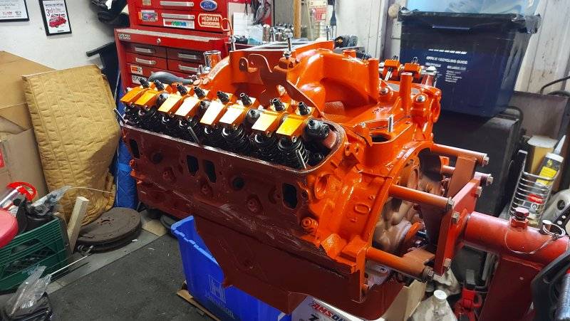

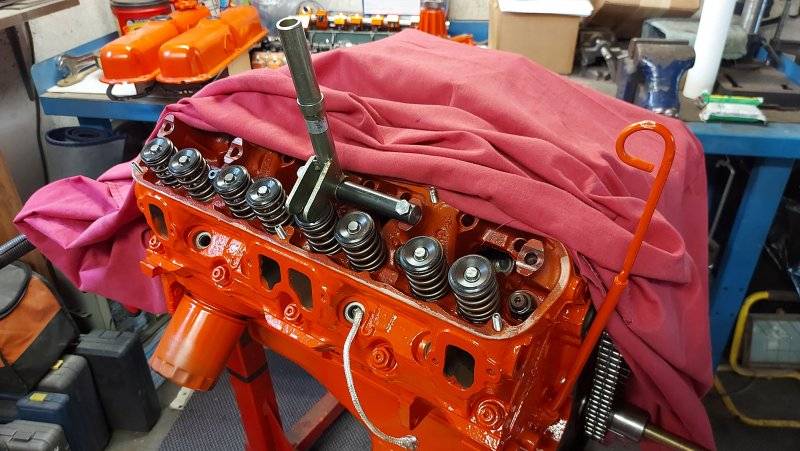

First order of business is to remove the inner valve springs.
A little tweaking on the tool helped to keep it centered on the retainer.
Since I have a new Isky cam and Crower solid lifters installed....(after the Hughes cam debacle...
) the inners have to come out and I'll have to do a cam break-in with the engine in the car.

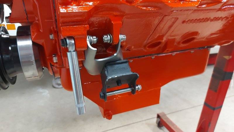

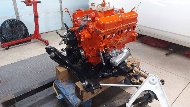

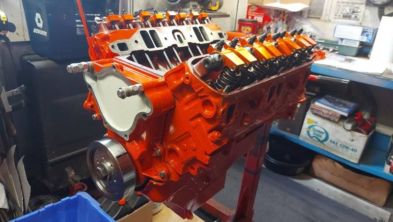

Then it was timing cover install.

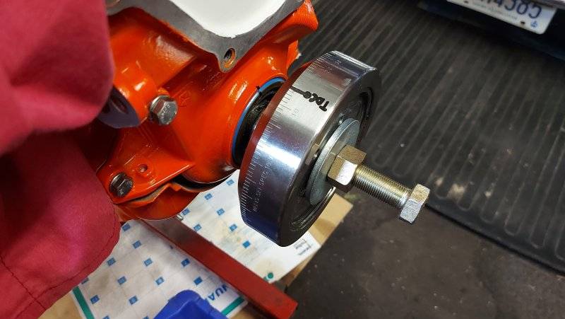

Next it was the Romac harmonic balancer install.
I had to buy the hardware thru McMaster Carr as the balancer is an interference fit so I didn't dare just whack it on with a sister sledge....

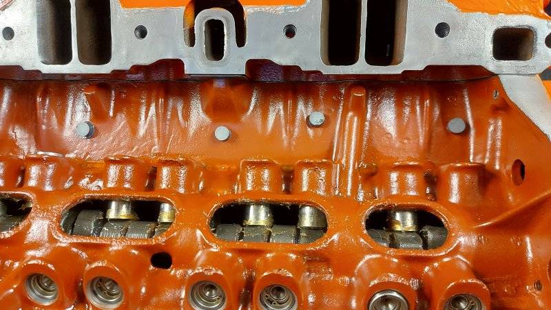

Next, I installed 8 magnets in the lifter valley.
My engine machinist does this on all the roundy round engines he builds - he says it keeps some of crap off the cam and lifter faces.

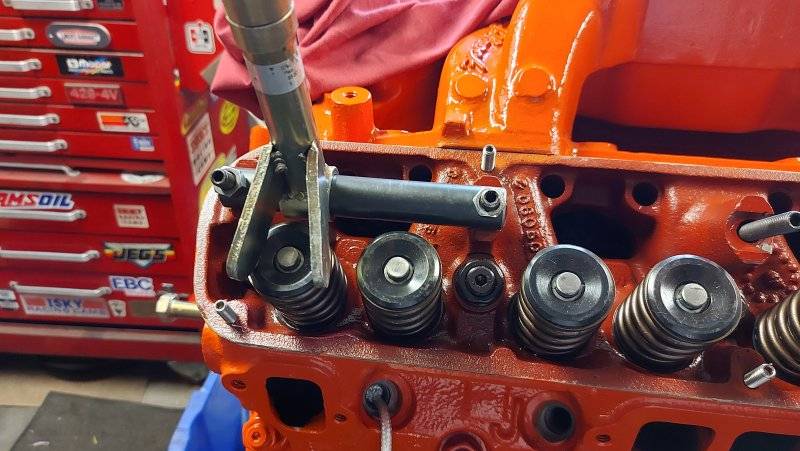

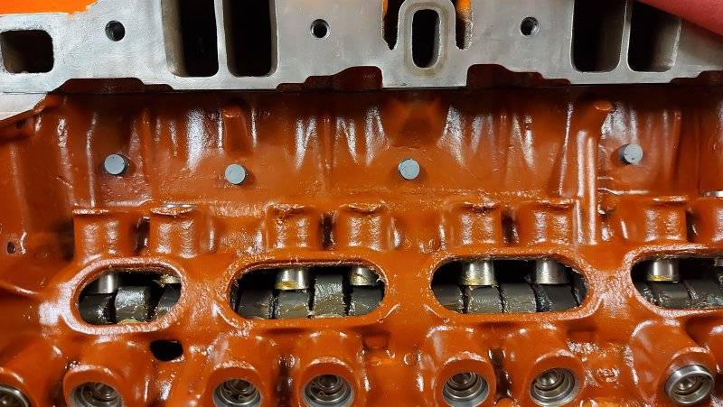

) the inners have to come out and I'll have to do a cam break-in with the engine in the car.Then it was timing cover install.
