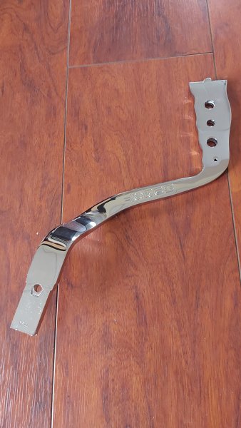

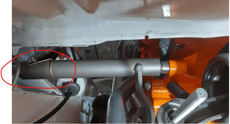

Do you mean this one?
I spy something I know I’m missing off my car. That white busing dealy. Is that a bushing for the inner steering shaft? How the heck would that not be there? Broke off?Thanks whayden - I also got the trim ring installed.

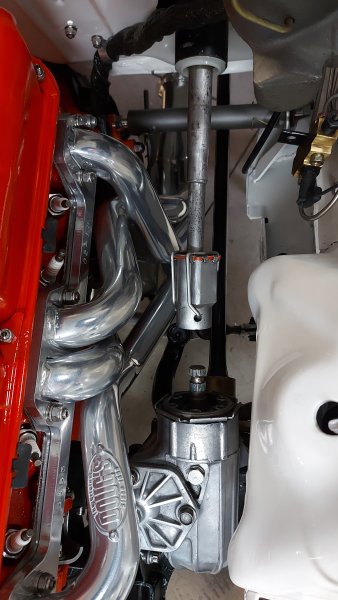

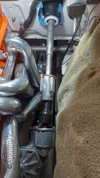

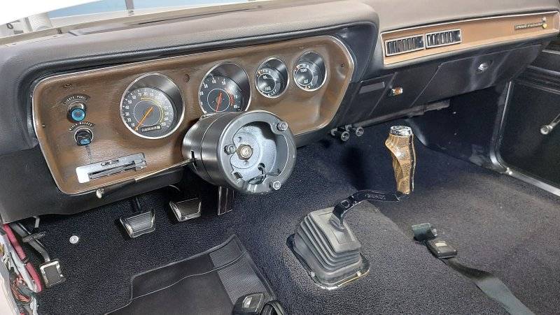

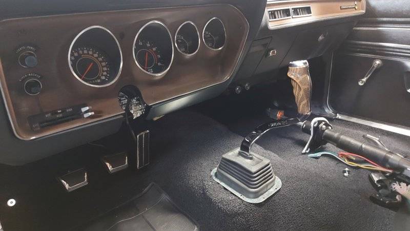

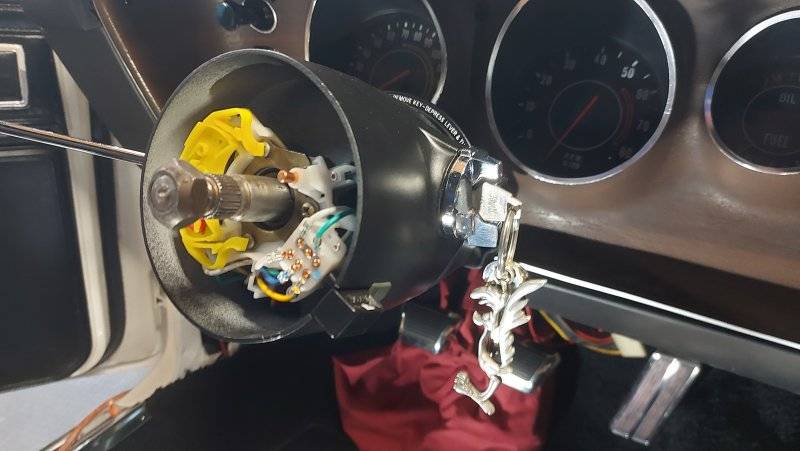

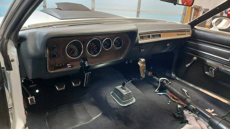

The next item on the agenda is to install the steering column.

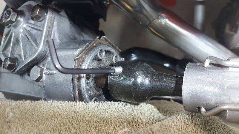

I stab it in the car and have this on the other end.

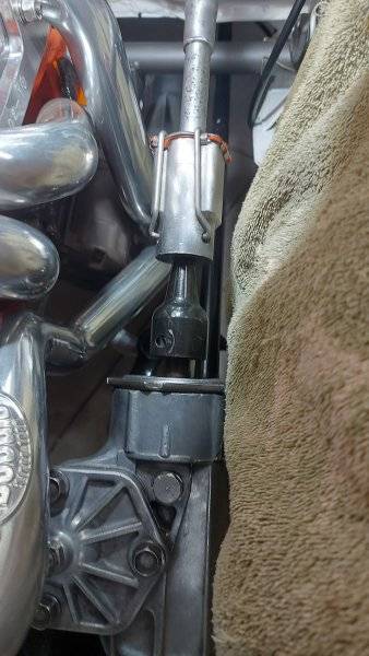

View attachment 1586746View attachment 1586747

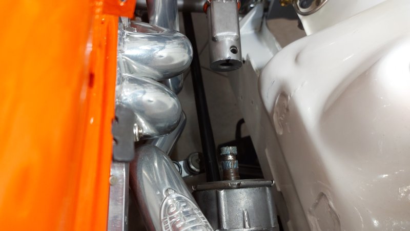

I think to myself easy peezy just have to push the coupler on to the steering box right??? WRONG
It wouldn't go on at all.
So upon further investigation it turns out the new coupler I bought is for a power steering box which has smaller splines.
No wonder it would not go on this steering box.
Luckily for me I have the coupler adaptor that goes from a power steering shaft to a manual box.
Put it on this coupler and try it again.
The result.....success!
View attachment 1586751View attachment 1586752
Now, I have a tech tip.

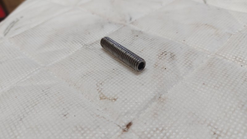

Instead of using the roll pin to secure the adaptor to the steering box I used a 5/16 UNC stainless set screw.
I ran a tap down the opening and applied some blue Loctite on the set screw.
In future if I ever have to take it apart, it will be alot easier unscrewing that set screw than trying to knock out a seized roll pin....
Done deal.

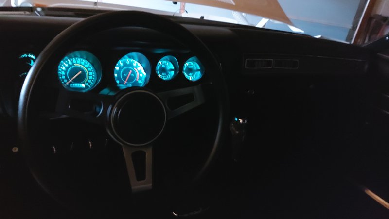

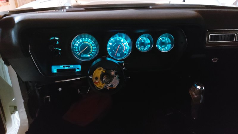

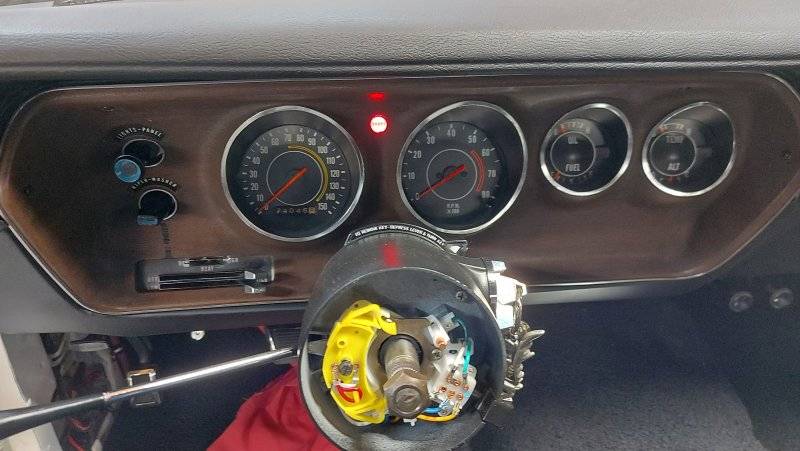

I plugged in the 2 wiring harness' from the column to the main wiring harness and finally put the ignition key into the cylinder.
I'm happy this hurdle was cleared.

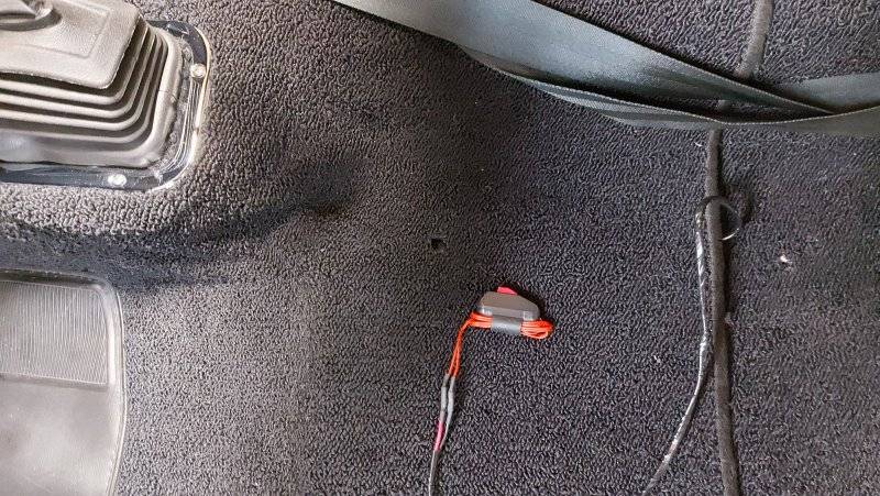

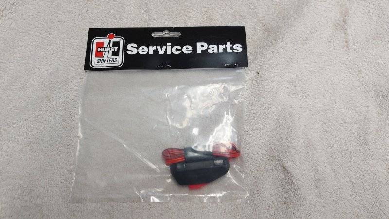

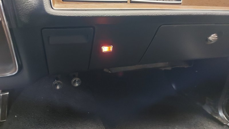

On to other stuff, like installing the line-loc button.
View attachment 1586757View attachment 1586758

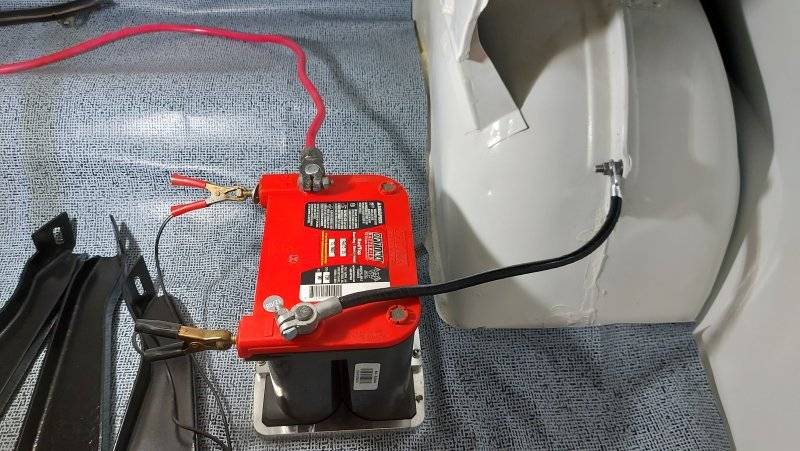

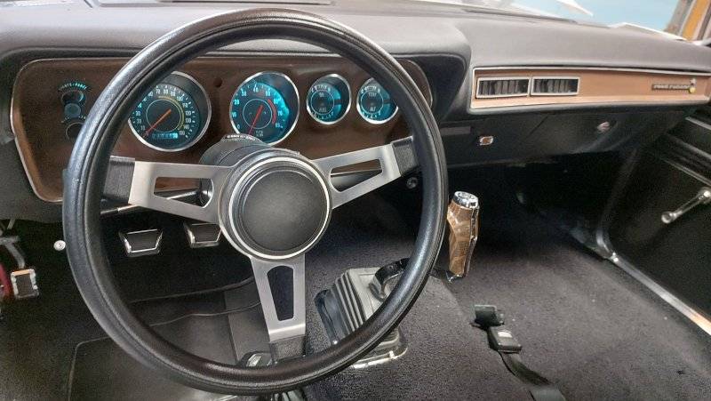

Next step will be to hook-up the ground wire for the battery and put some power to this car before putting the steering wheel on.
