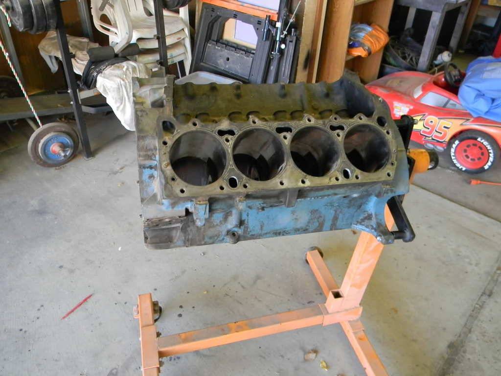

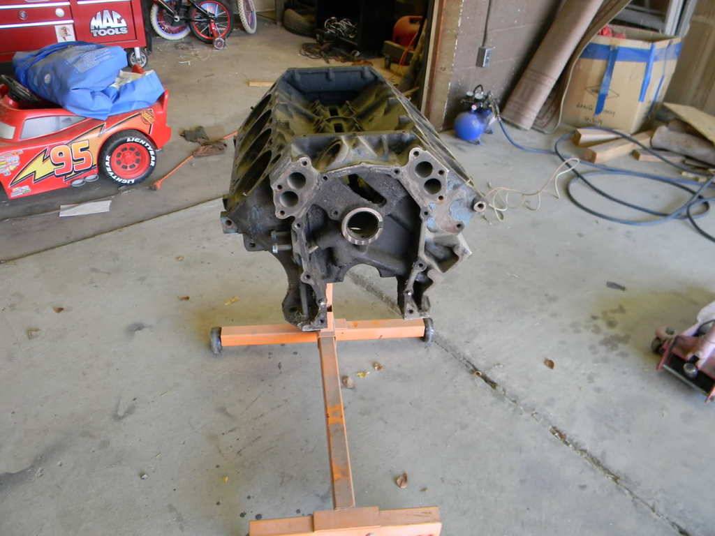

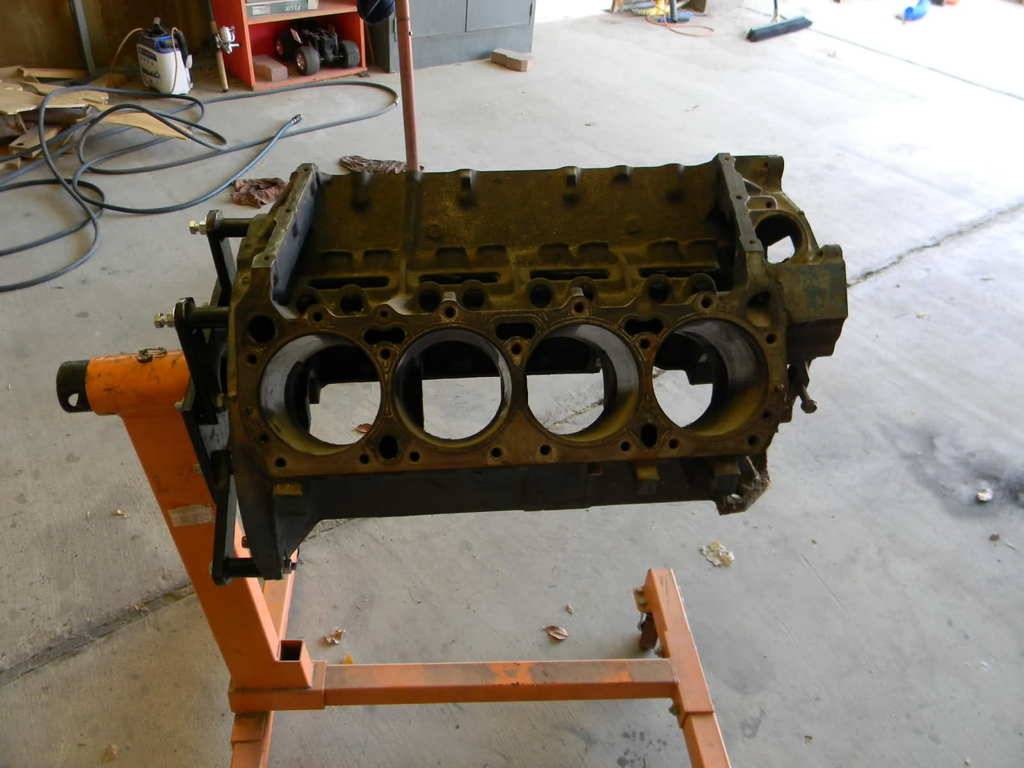

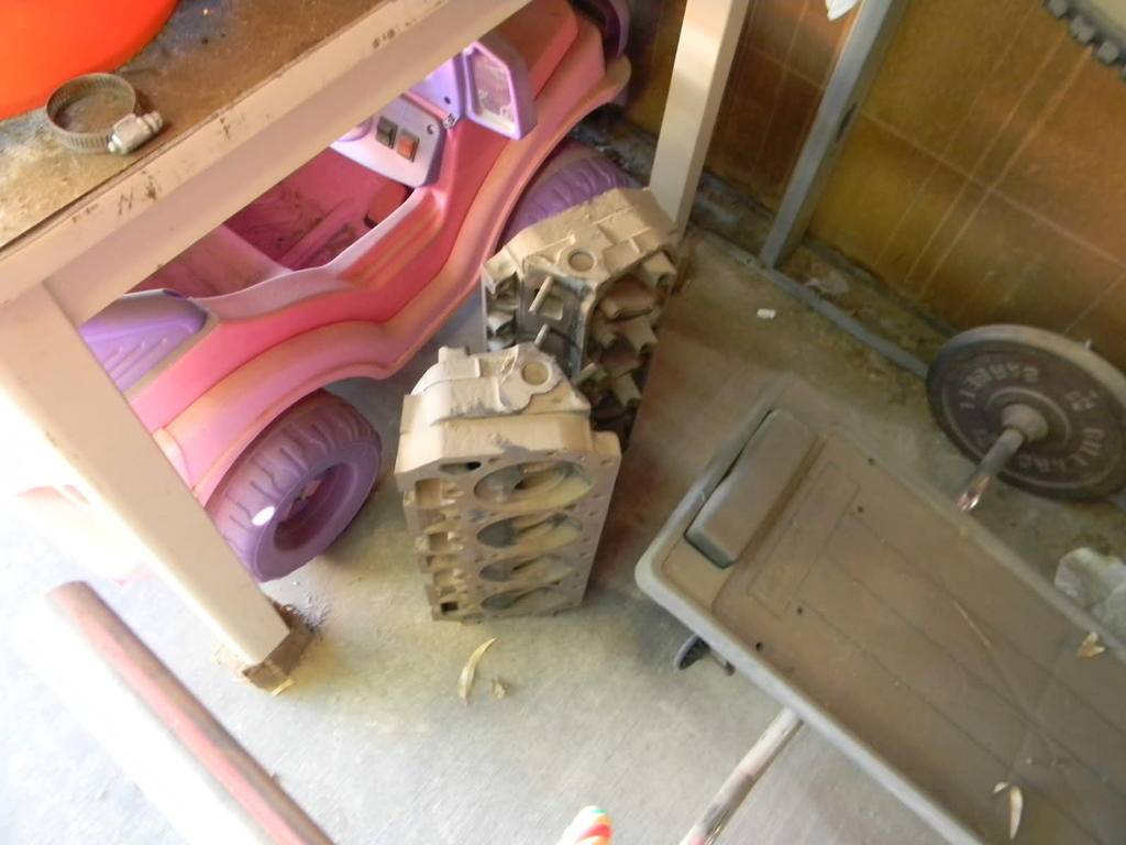

So I have decided to start building my stroker. the first step was to pull the old worn out engine. Done, check. now years later I am doing it. I got the engine back on the stand today to clean it up check it over and then we'll send it out to the machine shop.
Sorry for the large images.
I will have plenty of questions, so any input is well appreciated.!!
