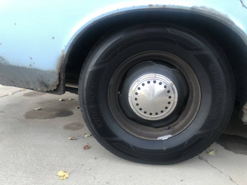

I've been sick this week, so I've not felt good enough to be out under the car. I did, however, buy some new tires for it, and I must admit I love the way it looks now, and also how much better it drives!

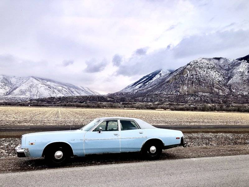

During all this, I've had a few chances to drive the car, and to me that's the most important thing. What use is a car that just sits. It has to be said, once she's warmed up, she drives fantastic. Straight and true, everything except the horn works perfectly, and she really is a joy to cruise around in. Here are some random pics from those little cruises, for your perusal...

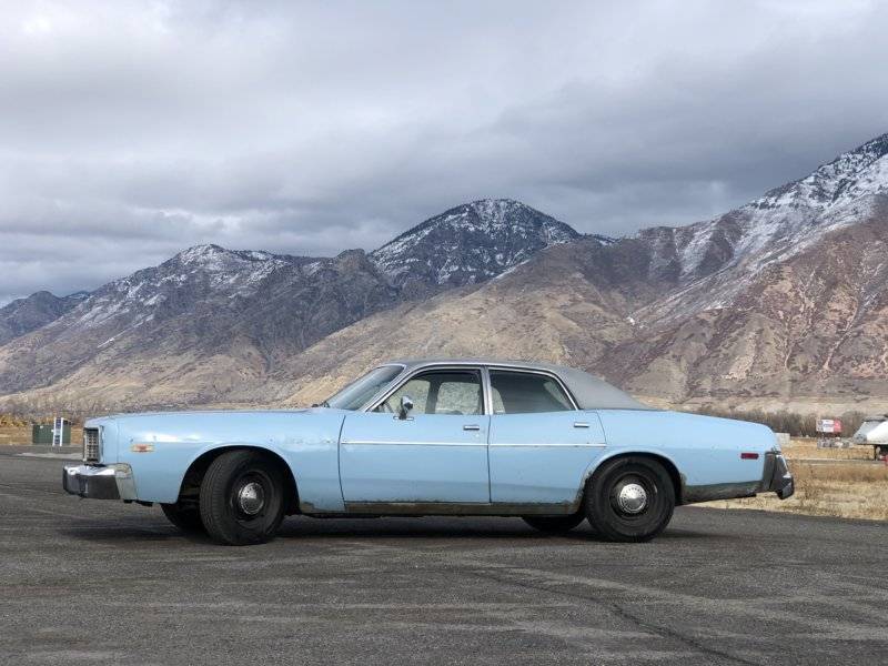

As you can see, my police hubcaps are on and looking good. (Don't look at the rust!! I'm very excited to get on with cutting that out and welding in fresh steel)

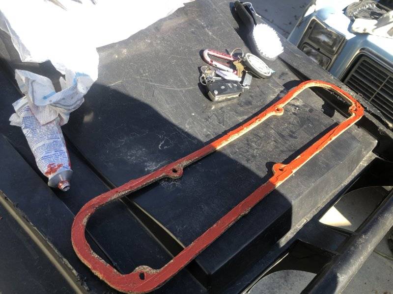

I changed out the valve cover gaskets finally

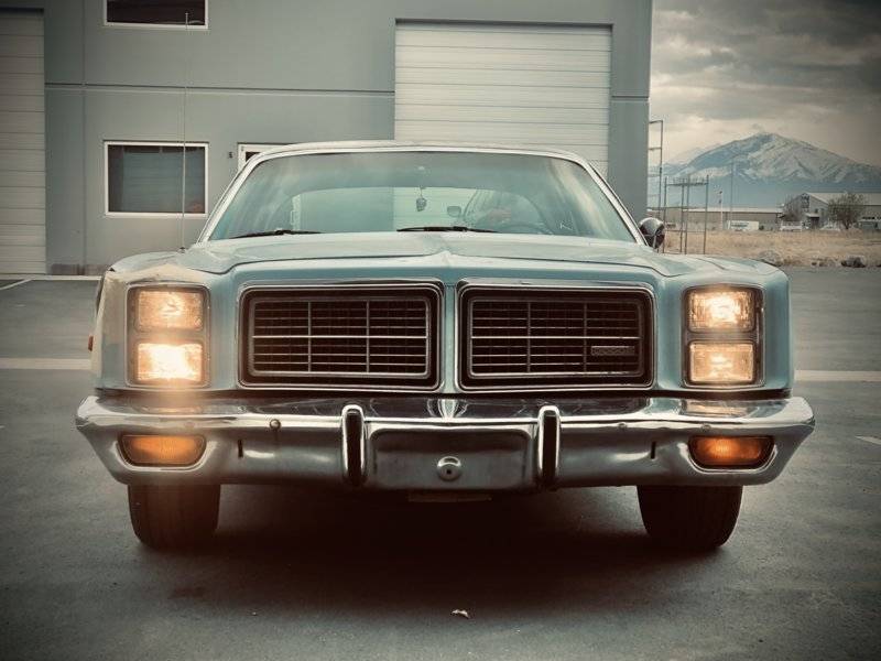

Gratuitous front end shot...

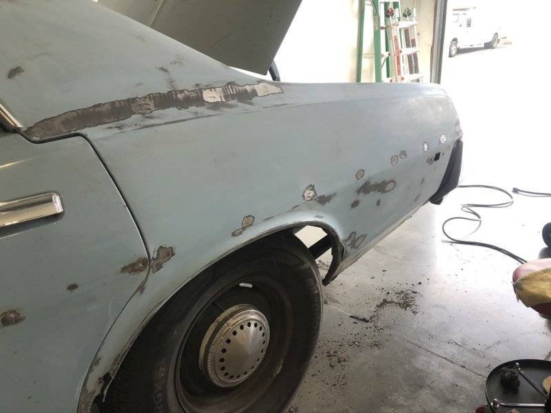

As you can see, I began grinding the trim pins (if that's the right terminology) down and/or welding the holes up. I bought a couple of sheets of 16 gauge steel and set to work rebuilding the rusted out wheel wells.

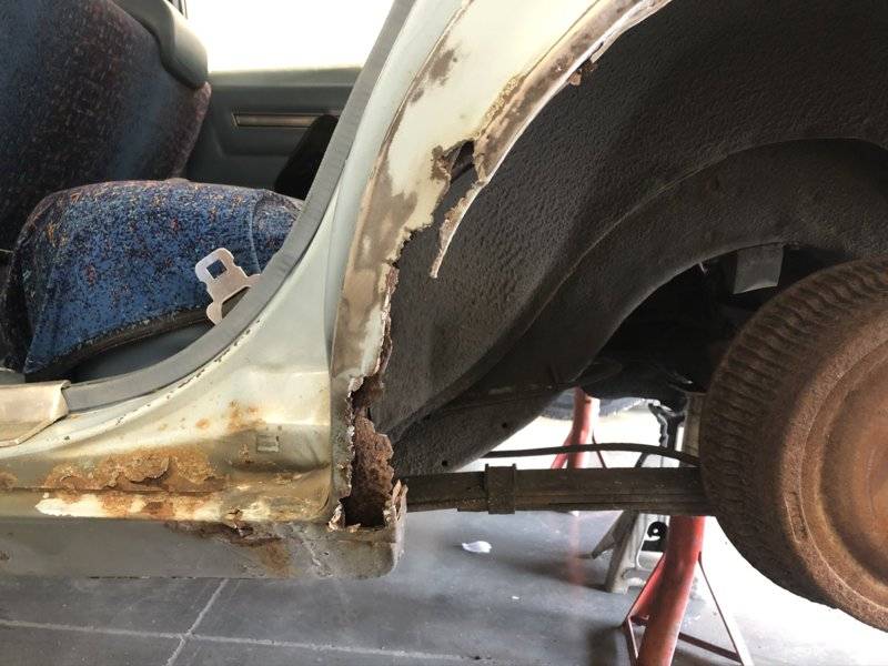

I cut that nasty-*** lower quarter out and made the new piece from cardboard first. Once I had the new bit ready to weld in, it suddenly dawned on me...weld-thru primer!! The new bit needed to be painted in weld-thru primer because these quarters are double skinned and I can't get to the back of it once it's installed! Doh!!! So this quarter panel progress came to a stop while I ordered said primer.

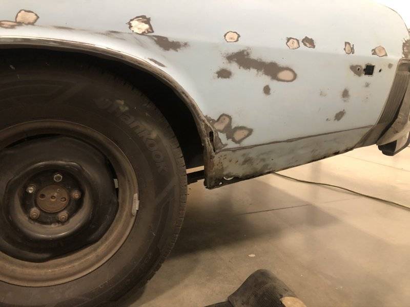

I'm happy with the wheel well rebuild. There's a little hammer and dolly work left to do still.

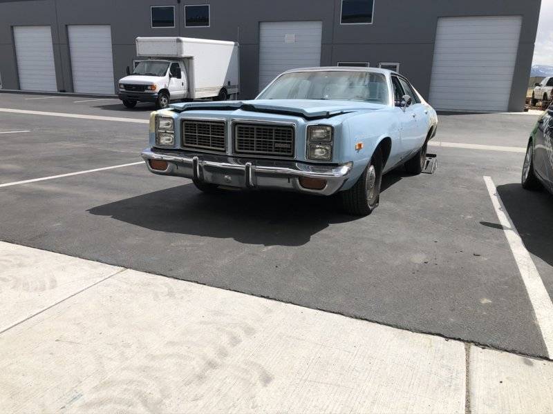

Here's the car, on a little slope outside the shop, with a dead battery. There was nobody around to help me push the car back inside (up the slope) so I had to do a little bit and chock the wheels...then a little bit more and chock the wheels....4000lb sedan + out of shape 43 year old = hernia.

I did a little more bodywork and spread some filler. I don't want to sand the filler inside the shop as it's supposed to be a graphics and wrap shop - filler dust would ruin everything - so I'll wait for a nice day outside and sand the filler out there.

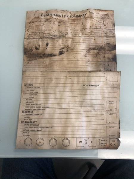

Today, I found this Inspection Sheet under the insulation in the front foot well. Super cool to find anything of historical significance in old cars. It doesn't say much but it did have my VIN and a date stamp of Fed 13th 1978.
All the excitement of the Inspection Sheet sent me into a frenzy so I pulled the front bench seat out and pulled the carpet up to look for the Build Sheet...
It wasn't there. I looked in the headliner, the seat springs, the glove box insert, and under all the carpet. It's not there, which is a shame because I wanted to see that. Oh well. There was a nice rust hole in the floor though. So yeah, that.

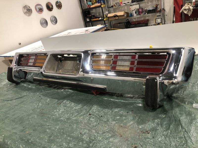

Later that evening I renovated the rear bumper. The chrome was in pretty good shape but the back side of it was orange.
Lots of surface rust but luckily no rot. I used my trusty POR15 and painted the back side, taking out the lenses carefully and cleaning those up good too.
Then on the chrome, I used Nevr Dull Wadding Polish and 1500 grit sandpaper, which removed all the orangey pitted bits and all of the ground in dirt really well!!

While you have the rear bumper off, see if those bumperettes will come off.
The bumper will look better with them gone.
That's a very good point. Thanks Beeper, I'll see what lurks beneath...could be more shittiness hahaha
