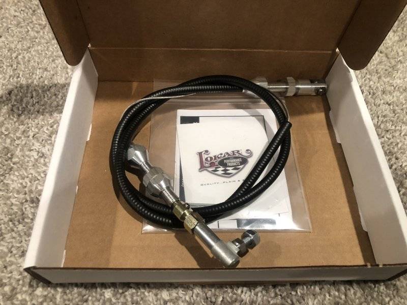

Update: This exciting looking box arrived this evening. Excellent shipping time from Summit Racing...
...and inside...
...the Lokar throttle cable...
and the Lokar kickdown cable for the 727...
The "kickdown/throttle cable bracket" was shipped out of Texas which will be another couple of days. All this came out of Sparks NV and was very quick for free shipping!
I'm impressed with the packaging of this Lokar gear. More impressed by the feel of it. The braid is tight and beautiful, all the fittings are machined in a gorgeous way. Very impressed with Lokar. It's still a bit spendy if I'm completely honest, but now that I see and feel the quality of the product, I think it'll be money well spent, no doubt.

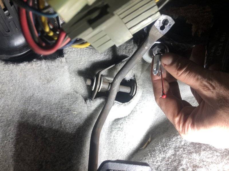

Then it was time to install the Lokar throttle cable. The factory cable came out, with it a stupid shaped grommet that, of course, exploded into a hundred bits because, you know, Chrysler, old, etc. And left me with this shaped hole to figure out...
Some washers and some silicone to seal off the firewall is what I decided on. But I'm not going to seal it up until my throttle/kickdown bracket arrives. Below, you see the nice machined "pedal end" (with the red paint), the firewall to be clamped between the large washers. If that makes sense.
It's extra long, this cable. It's fully adjustable, but I won't guess, I'll wait so I can get the bracket on, then trim the sheath and the end of the cable. That'll be Wednesday when the bracket arrives.
Buuuuuut, because I am a moron, I managed to wedge my 6'3" 240lbs frame into the footwell somehow, and find out that this end with the nice billet end piece...
...will not work with the hole in my accelerator pedal, as you can see.
But this ball-end will...
So with a max score of 100,000 for swear word combo's, I extraced the cable, took off the end piece, and slid the cable back in. More complcated that it sounds but the parts are excellent and it only takes a sec to figure it out.
A grommet goes back in the other hole to stop the cable slipping out, and its done. That seemed to take an awfully long time considering the actual task - but I did take my time, and enjoyed knowing I had some success today. Didn't rush, and took deep breaths. Has been ages since I've enjoyed success on the car so I really did relish it.
