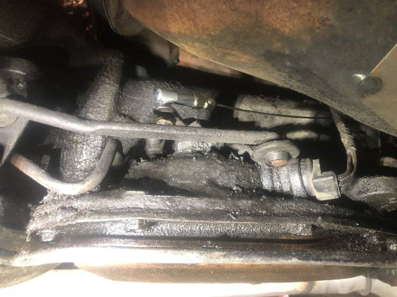

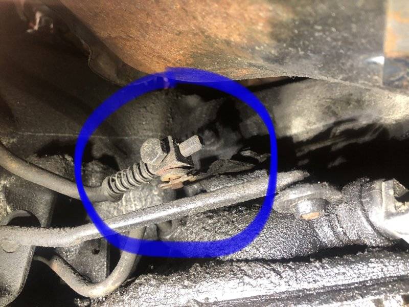

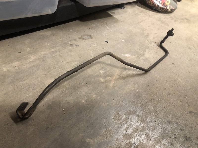

Poked my head under the car, and spotted the end of the kickdown linkage/rod. The factory one is attached to this arm on the trans here...
Alarmingly, I pulled that split pin out and it practically fell out of the engine bay. Here it is...
Bye bye factory kickdown rod *waves*

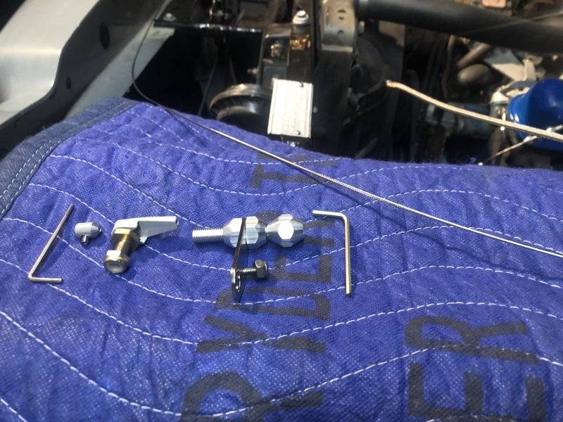

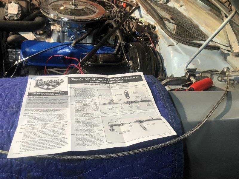

Today was strange. Not only was it unusually warm, but a man (me) actually opened some instructions, and even stranger, actually read them!

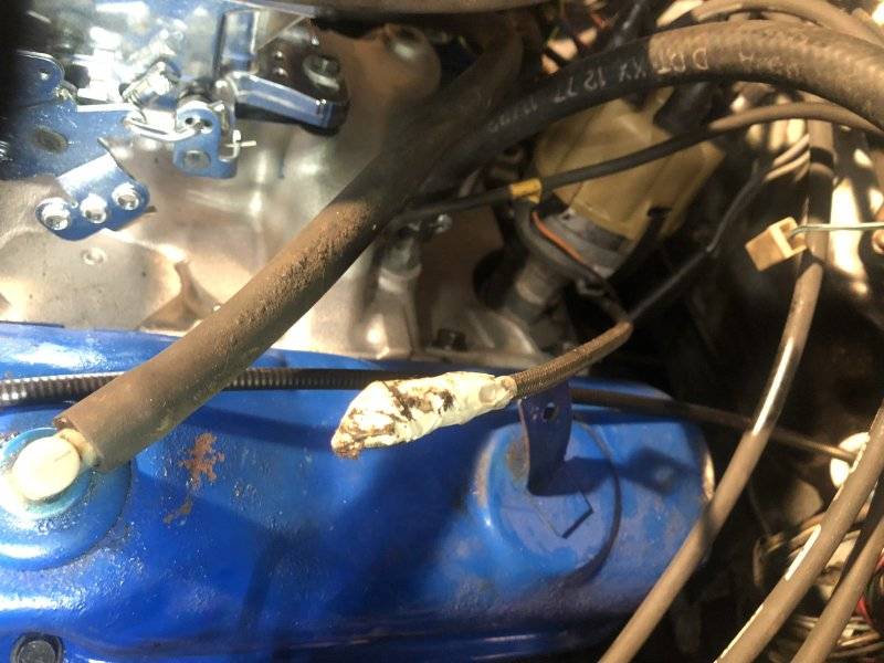

After reading the thrilling instructions (definitely not translated from Chinese, for a change!) I removed all the stuff being careful to lay it out as it came off the cable.
Lokar tell you to install the braided sheath first, and after pissing with this for a while too long, I understood why. The cable bolts up to the trans arm, and does a 180 around the back of the trans and up to the carb - I was so confused up to this point as to how the throttle linkage would move the kickdown cable the correct way....then when I routed it around the back of the trans, doh!!! it all made sense to me. Thanks Lokar.

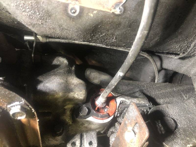

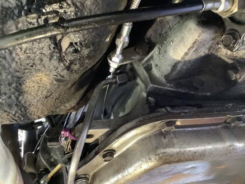

The bracket sits under the factory lower left tailhousing bolt on the trans, as you can see here...

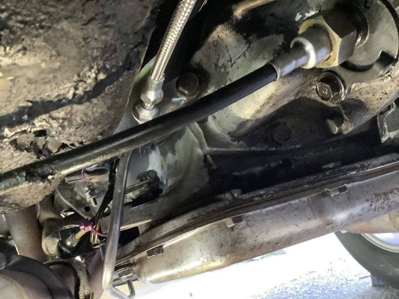

Occasionally I will have a good idea. Maybe once or twice a year. Today, I decided to tape off the end of the braided sheath so it wouldn't gather a bunch of grime as I slid it into place. Glad I did, it's messy down there...
And that was that - waiting for the bracket that clamps this and the new throttle cable in place, to be delivered. But I thought I'd try and replicate it and see.
You can see way down there, the trans arm is moving smoothly. Excellent!

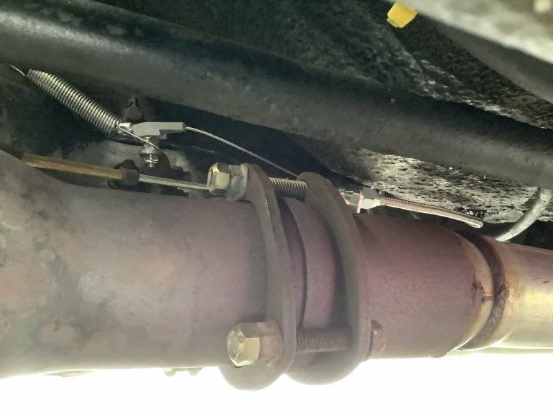

7th December around 6:30pm saw the arrival of the bracket I've been waiting for! Yesssss!!!

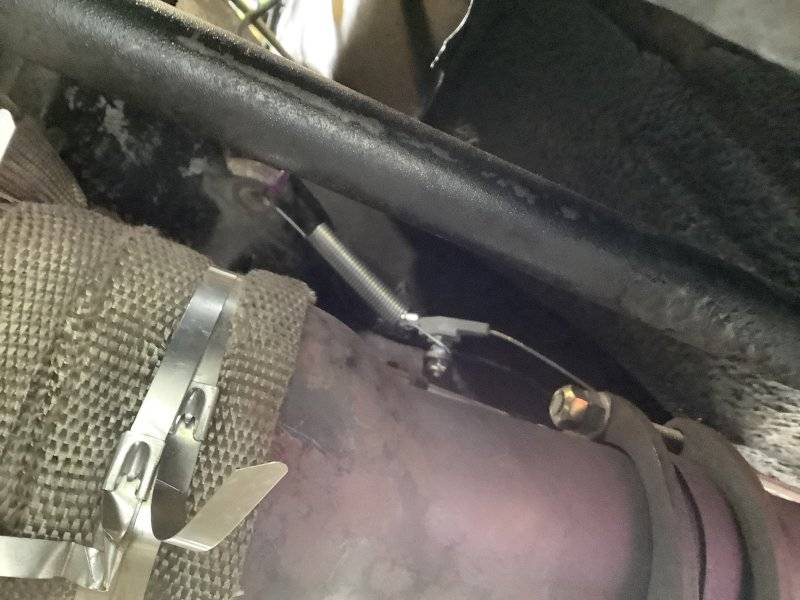

So I ran out to the garage, cranked on the heater, and got to installing it....not before spending the time to read the instructions (which were very good across the board with Lokar, I must say)
This bracket is a nice piece, and is very light, has barely any weight to it at all. It is installed using the rear carburetor mounting bolts, and has about 1/2" lateral adjustment...
After measuring the length of the throttle sheath (keeping an extra 1-2" bend for "engine movement"), I was then faced with the task of chopping the black rubber and aluminum sheath cleanly.
BUT FIRST, slide the cable all the way out, into the footwell, because we don't want to cut that off at all...
I remembered I had various metal snips, so I tried a little piece off the end of the sheath. They were all dull. Then I remembered in my drawer labeled "Big *** Stuff", I had these...
Those big old Bertha's made quick work of that, and the end of the sheath could be slotted into the bracket clamp thingy...
I then tied up the end of the cable with the awesome Lokar cable pieces, and had to make a few marks on the cable to see if I'm getting full throttle, and idle settings on the cable, from stomping on the gas pedal. Of course, I couldn't tell what was going on being in the car standing on the pedal, so I wedged my phone in there, and did a little video so I could see what was happening.
That looks perfect to me. I have full throttle and idle position, and the pedal feels much stronger too, due to the carb springs and the springs Lokar supply in the kit. Excellent!

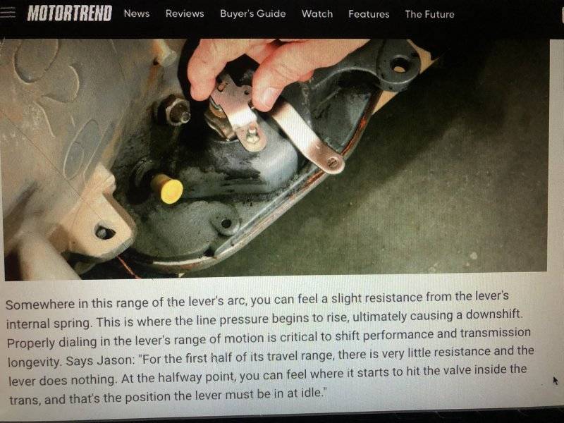

Sat 10th Dec '22 tomorrow, first thing in the morning, I'm going to attempt to adjust this kickdown cable. I've read so much and watched so many videos I almost gave up, until I read this article here...
The LowDown On Stock Torqueflite Kick-Down Linkage
...in particular this paragraph which makes complete sense...
Seems simple enough right? As @64fury74charger says above, a spring on the trans lever helps too.
I am hoping for a dry day, and a successful adjustment and road test before the England v France game at 12pm...eeeek!
Wish me luck!

The tricky part for me was finding that sweet spot for the lever at idle position. The other part is adjusting the cable so this lever is almost fully back, but not quite bottomed out. This gets less frustrating with practice. I had to make very small adjustments then test drive numerous times.
The other important thing is to measure the travel of both cables through wot and the amounts of travel should be very close. In other words the throttle cable pulls the kick down cable the same distance. This should be in the lokar directions that you have.
This last part confused me at first, but once I looked at the whole system it made sense. The cable set up is great for very small length adjustments. I hope this helps you get this dialed in. Looking forward to seeing your updates.
