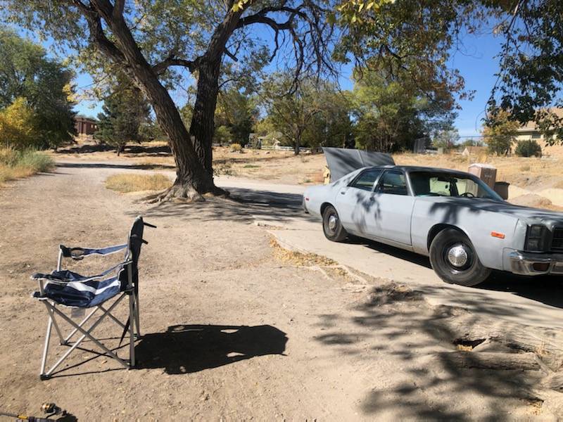

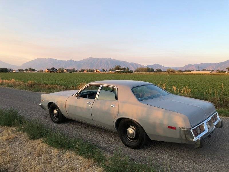

Here's a couple of older pics which were both taken in warmer climes - to inspire us and give us hope :-D

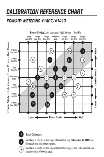

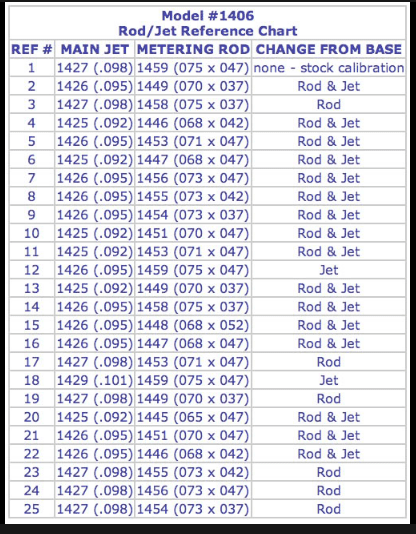

Various opinions came my way this weekend but the one I value a LOT is the legendary Hawk Rod again taking time from his own stuff to help me from so far away - suggesting my jets should be smaller. Makes sense and a few videos on youtube kinda confirmed that. So, another $108 for a jet/rod assortment kit and I'll have the unenviable task of trying to change them. Wish me luck there :-D
(and truth be told, I am not an expert carb tuner
That could very well work. I am not at all familiar with a Demon carb.Hawkrod, wouldn't Gary have better luck going to a fatter metering rod and a stiffer spring.
I assume that is the setup on the Demon carb...no?
