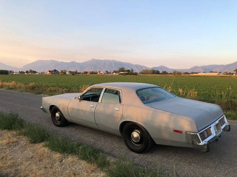

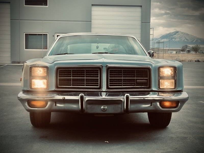

Hi guys - just wanted to check in and say hello and that, according to the news sites, we are all encased in ice and have unusual snowfall nationwide - so I hope you are all safe and well. Spring is almost here guys, just a few more weeks to power through.
I've not been out in the garage at all, too cold here in Utah. Work has taken over but that's ok for now.
Here's a couple of older pics which were both taken in warmer climes - to inspire us and give us hope :-D
Be safe guys.
Gary

You are doing a great job learning about your mopar and it’s definitely becoming quite a cruiser. Lots of people here are really helpful and have all kinds of great advice.
