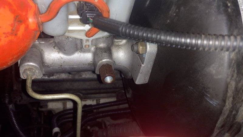

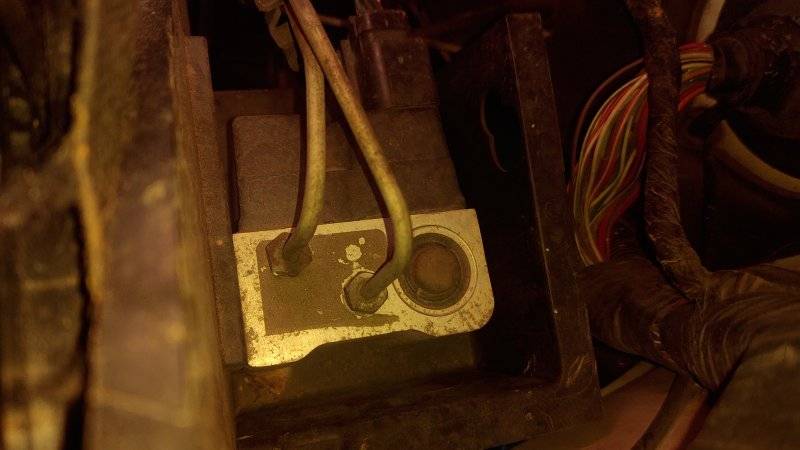

For my good friend @khryslerkid , I went back out and took a couple more pics:
Master cylinder, showing the now-vacant rear port where the hard line in
question was connected.
Top view of the ABS unit, with two lonely lines connected...and a
possible reset button or some such?
The second line your seeing probably goes to the ABS unit... They bleed off pressure to release the brakes... Some early Fords had two lines to the calipers & thats how they were done....
Perhaps, but if that's the case - how does the right front get fed then?
NAPA will likely have pre-made lines with ISO flare ends... Plus adapter fittings to work with assorted size fitting on the truck...
Oh yeah, I'm gonna wear out the town looking to match stuff up for sure.

This morning doing some more research on the thing, it's now confirmed I have two wheel ABS;
the ABS unit and types/numbers of lines on the truck say so.
I just find that odd for some reason, but ok...
