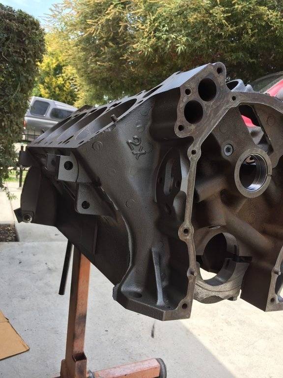

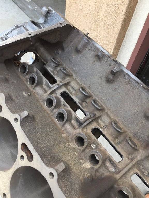

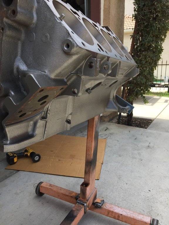

Got the block back late this afternoon. He got the cam bearings installed, said they were a pain in the ***. Also he installed the brass freeze plugs, oil galley plugs and oil pump shaft bushing.
I finished painting the block this evening, I'll post pics in the morning.
Pics!
I did get rid of the casting flash in between the lifters and up front by the oil pump drive. It's painted cast iron gray. Should look good with the light argent silver.
