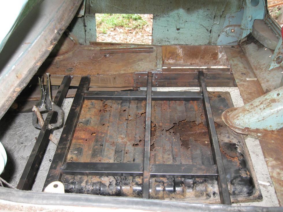

updates

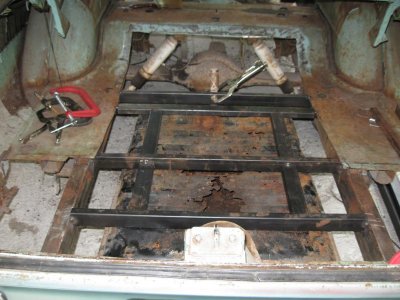

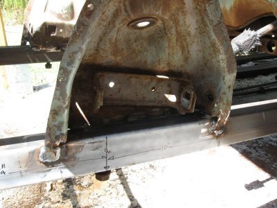

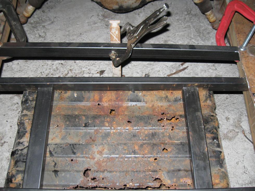

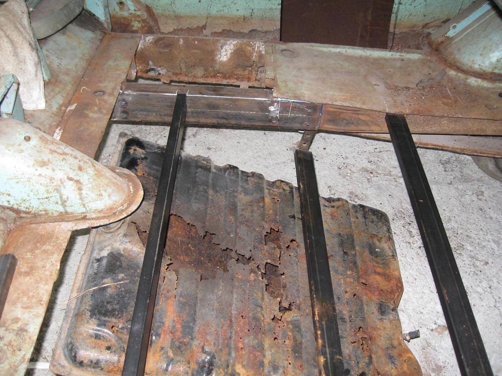

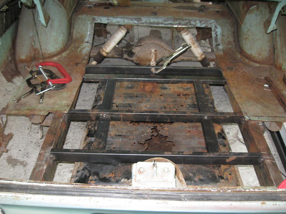

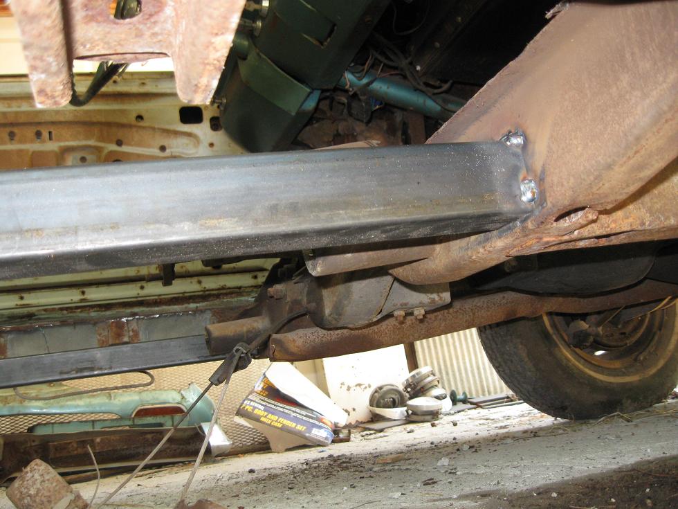

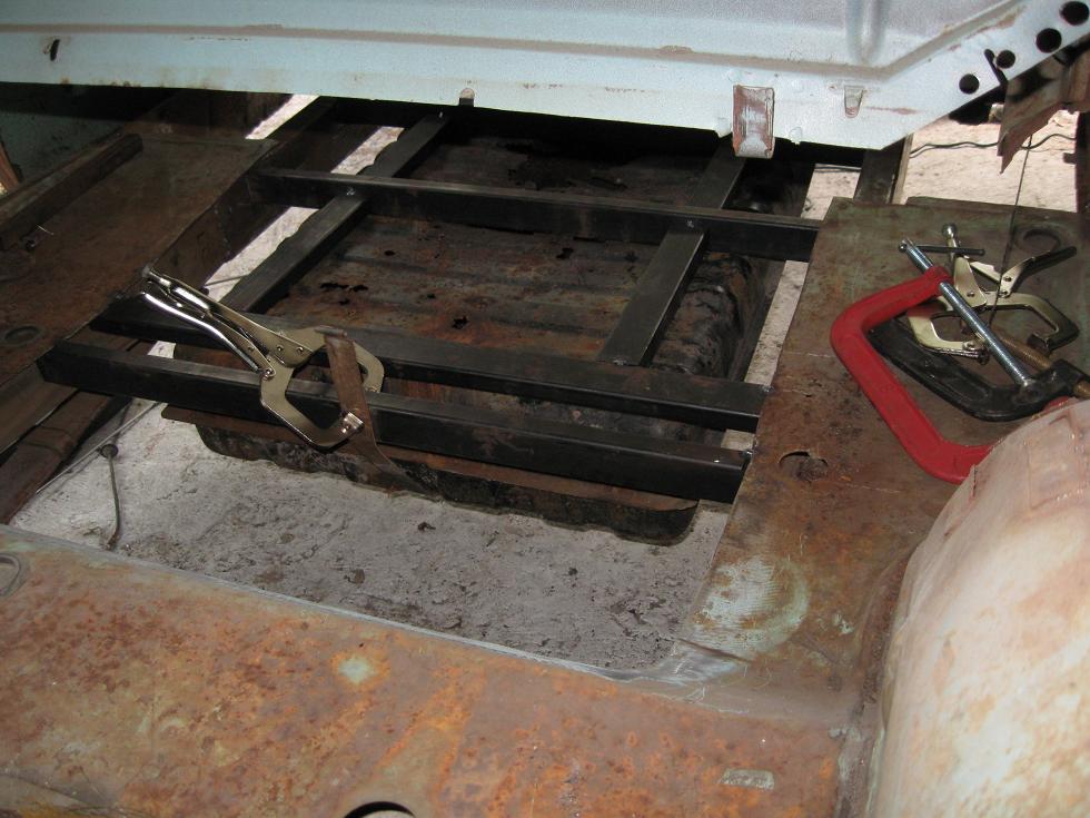

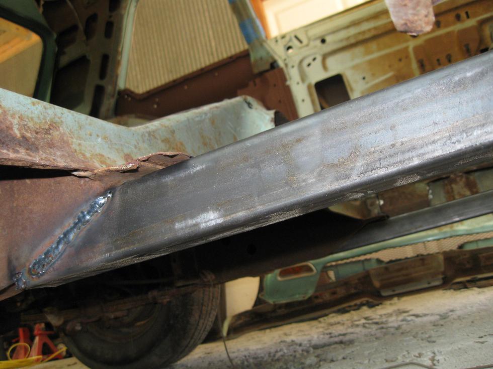

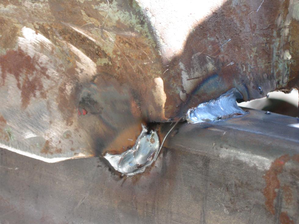

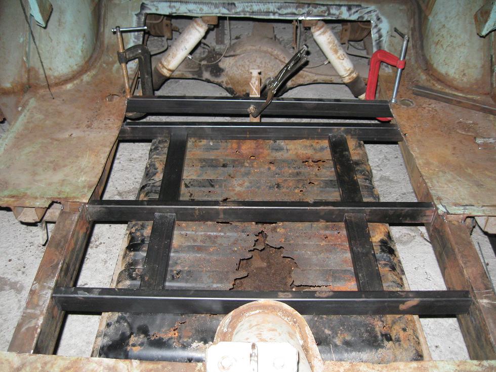

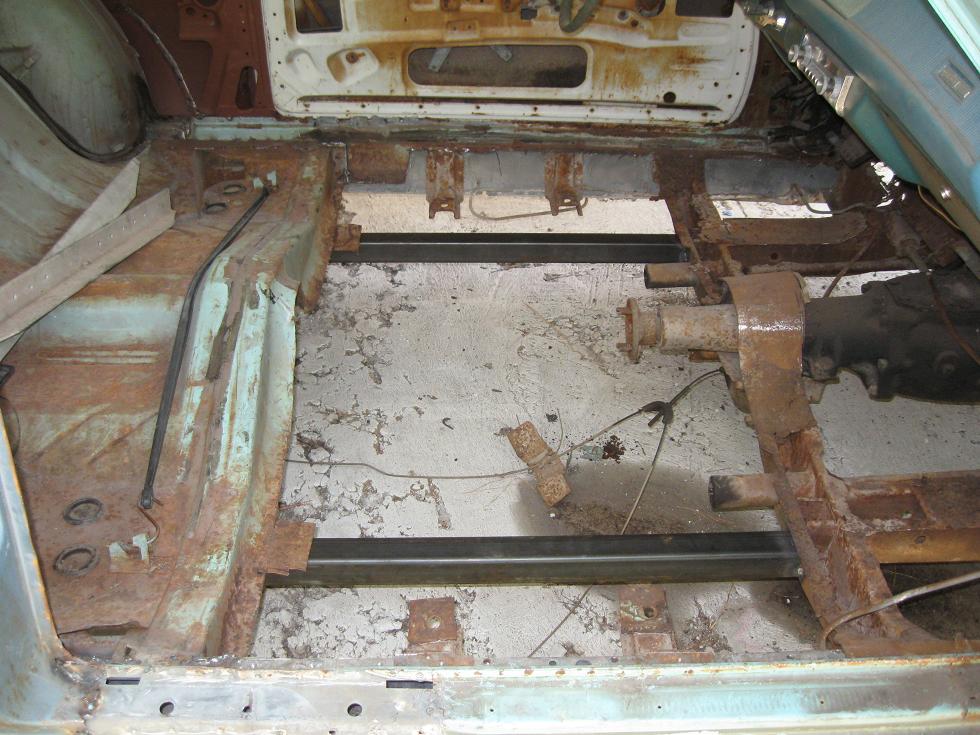

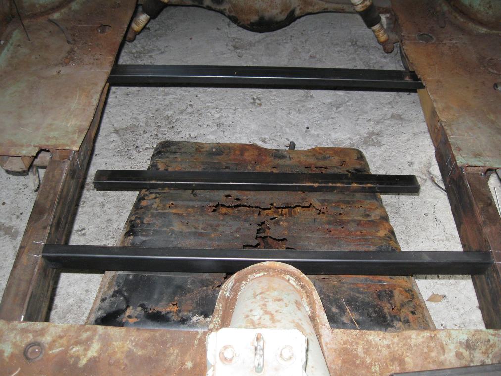

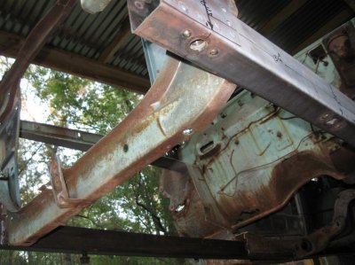

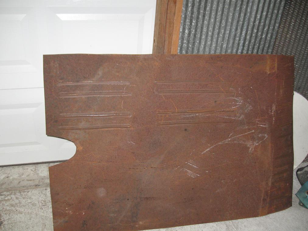

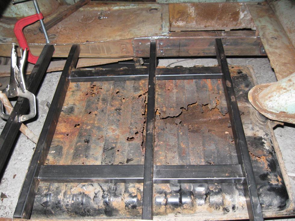

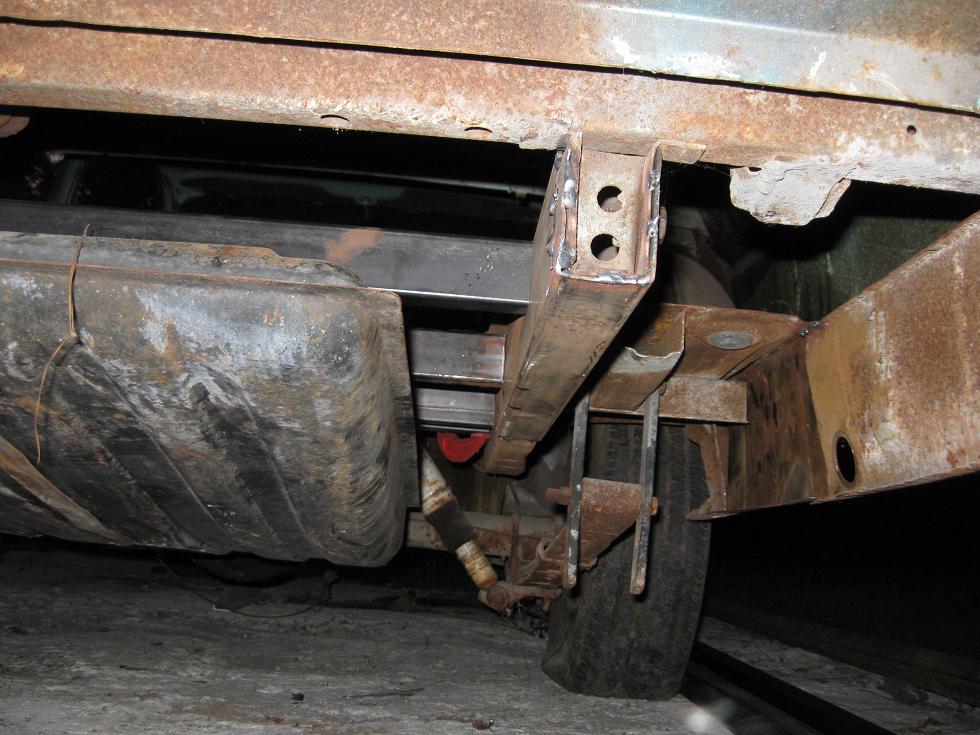

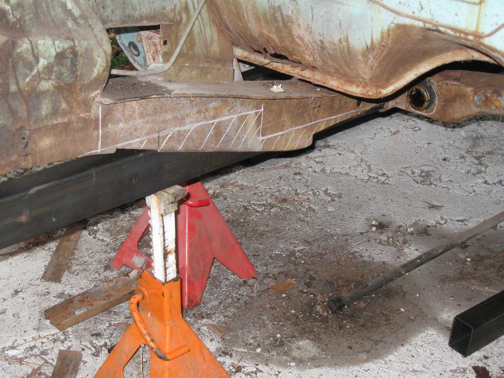

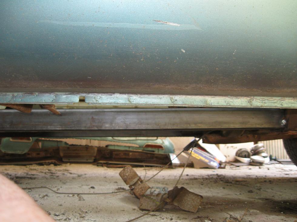

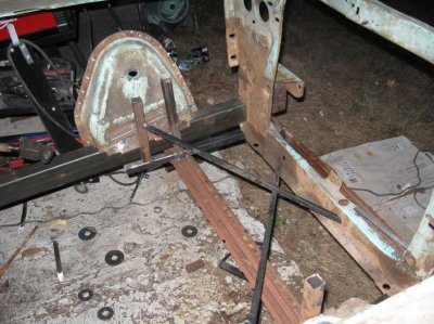

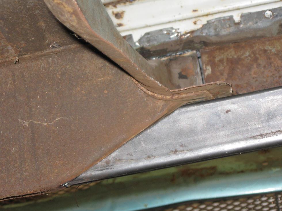

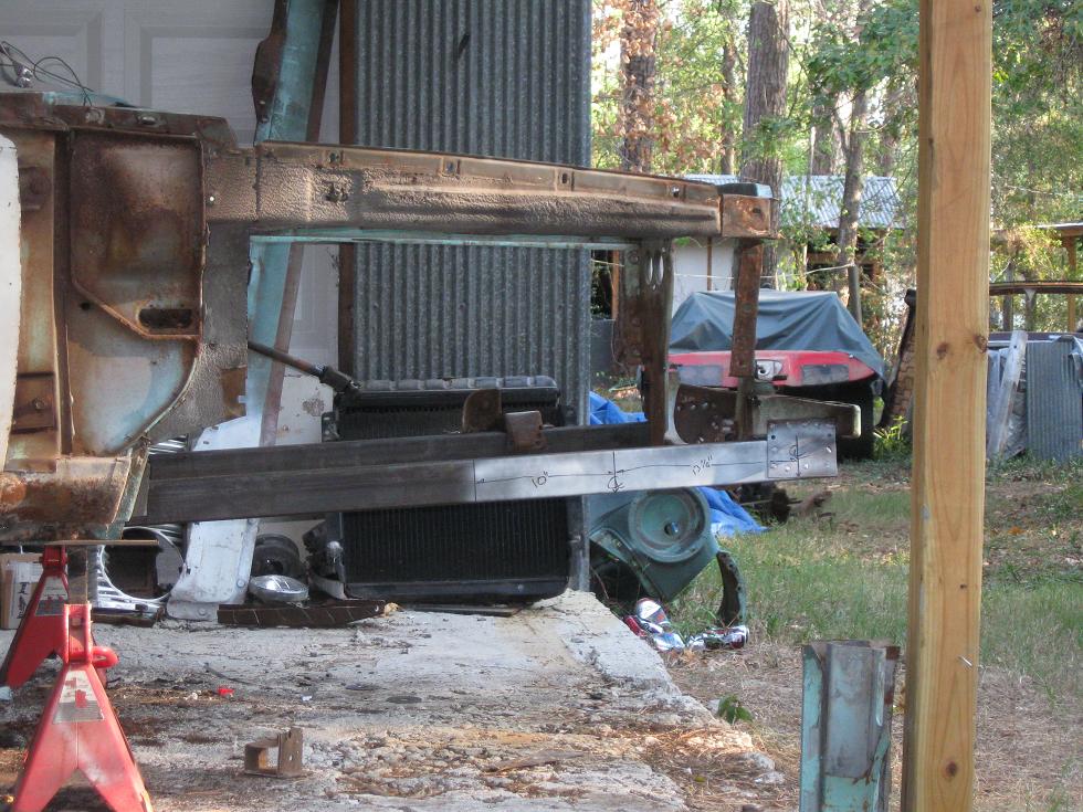

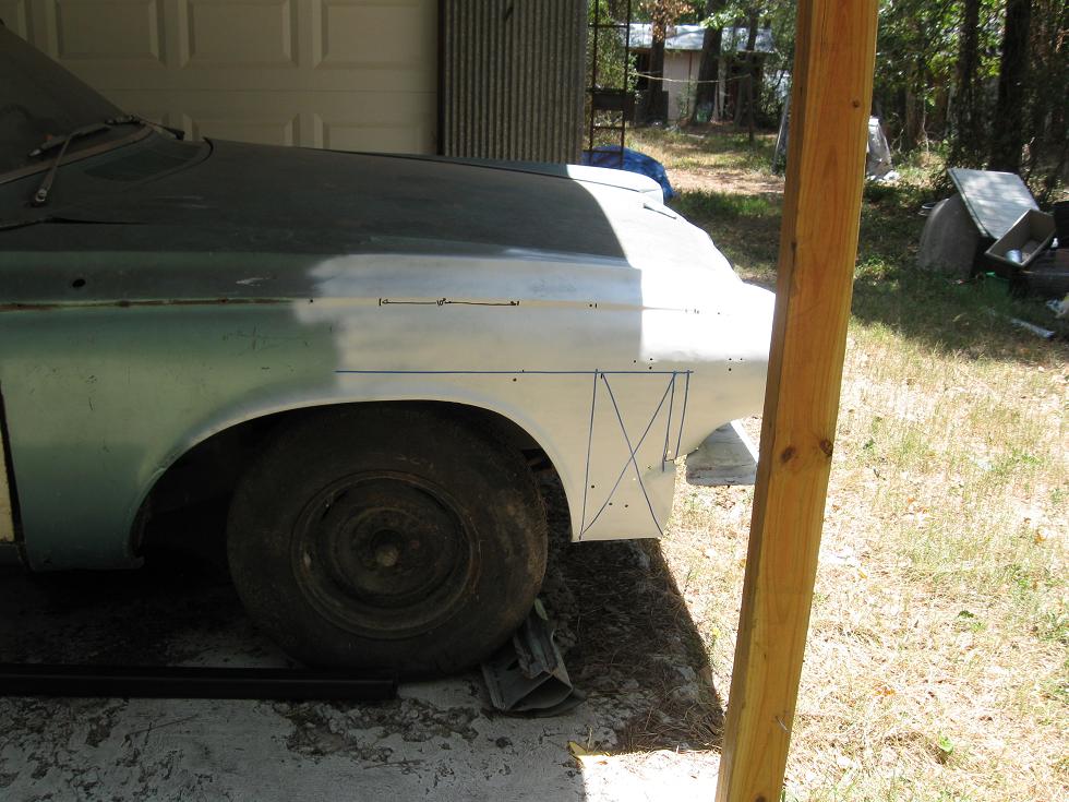

:glasses1:ran out off welding gas again and my first attempt at bead rolling . mounting the gas tank using the old one to fit cross bars . it got to hot out so thats it for this update. next gonna be workin on frame connectors

have been watching your work and it is great to see your progress.nice work on the fender,can't wait to see it in primer also.

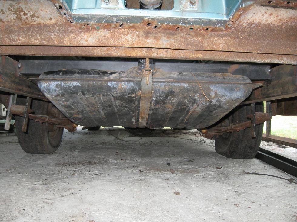

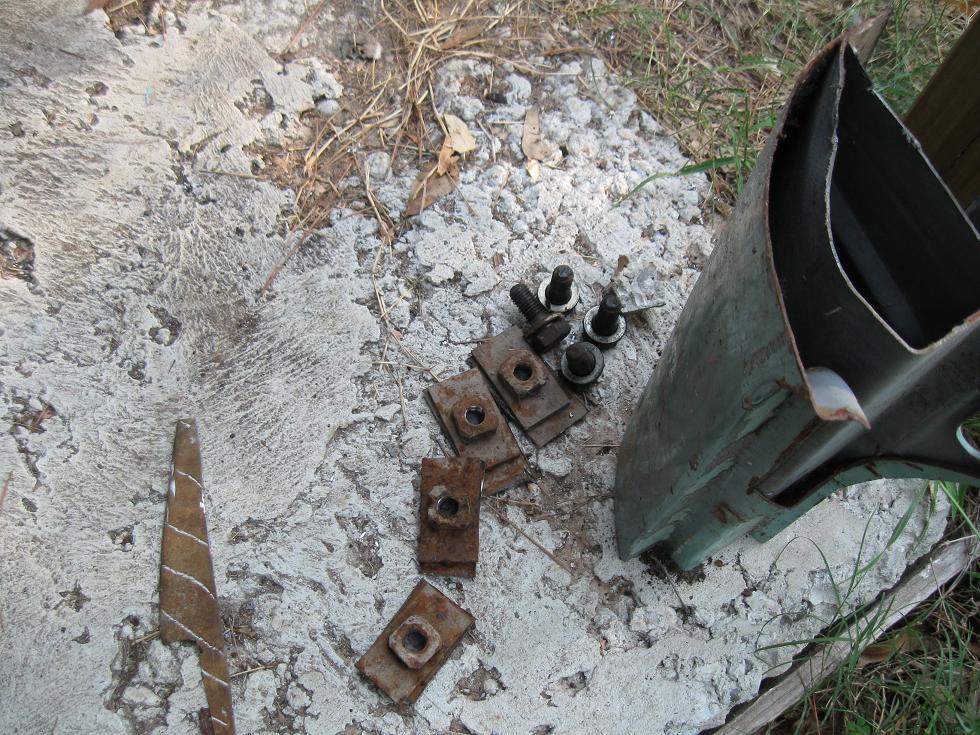

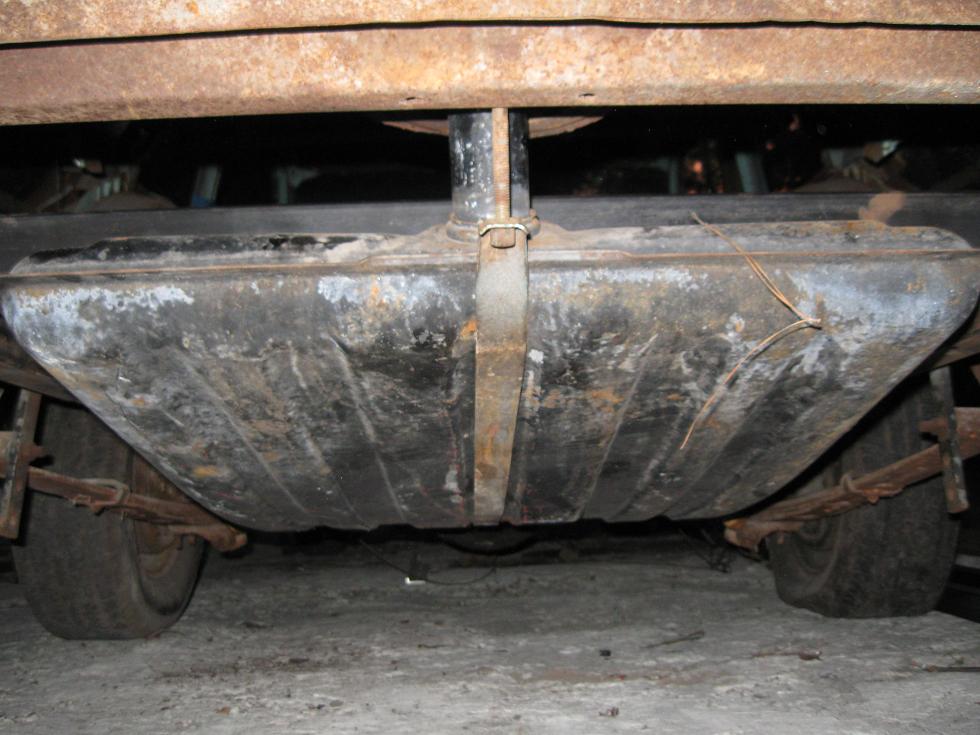

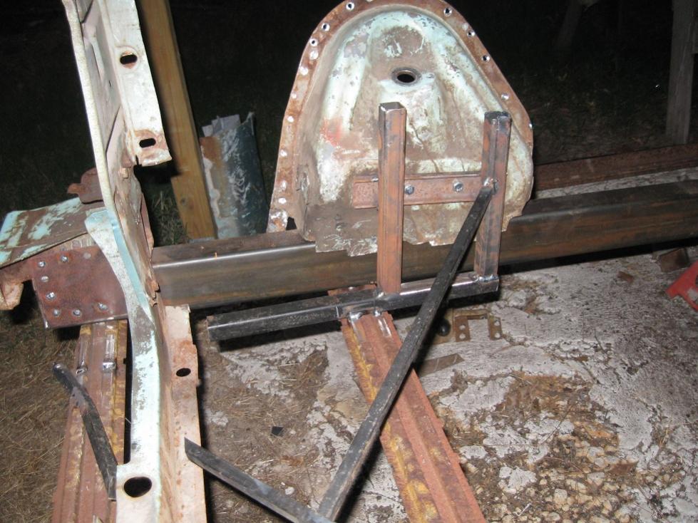

gas tank

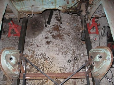

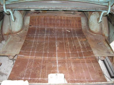

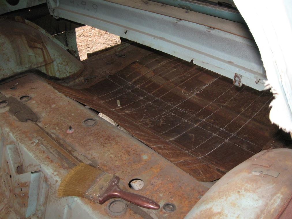

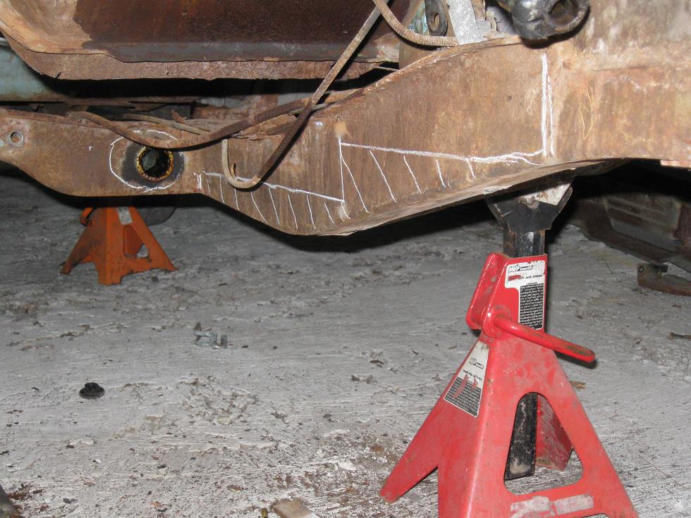

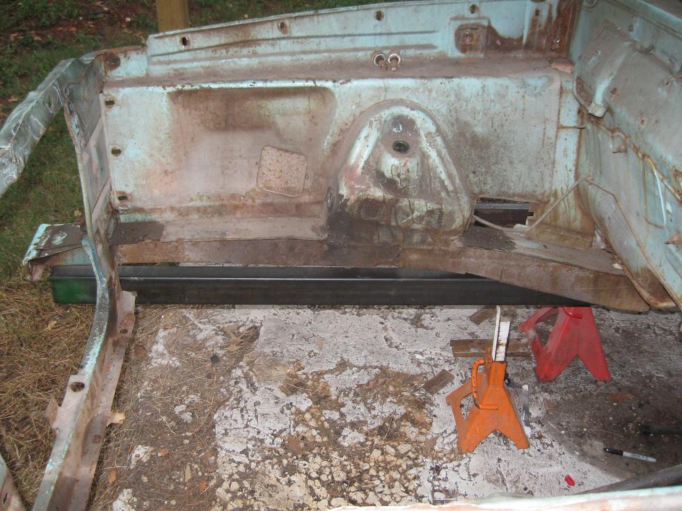

i cut the pieces tank looks kinda low got to make adjustments and i found out why iam getting alot done its gotta be the bull lol :hello2:
Picture 084.jpg Picture 082.jpg Picture 081.jpg Picture 080.jpg Picture 079.jpg Picture 078.jpg
Sorry to hear about your son.....and I know what you mean about the heat setting in. I'm not very far from you in nice and humid Pasadena. Also, you look familiar....maybe we talked at the Mopar show at the track in Baytown? I go by DJ. Your 63 is looking good! I have a 66 2dr post....well had 2 of them and had a 67 Dodge Coronet 4dr that I was thinking about converting but had just too many irons in the fire. The 67 was solid through and through but I gave it to my nephew to convert over :D and sold the other 66. It was pretty rusty.

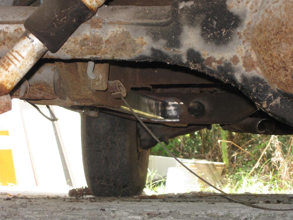

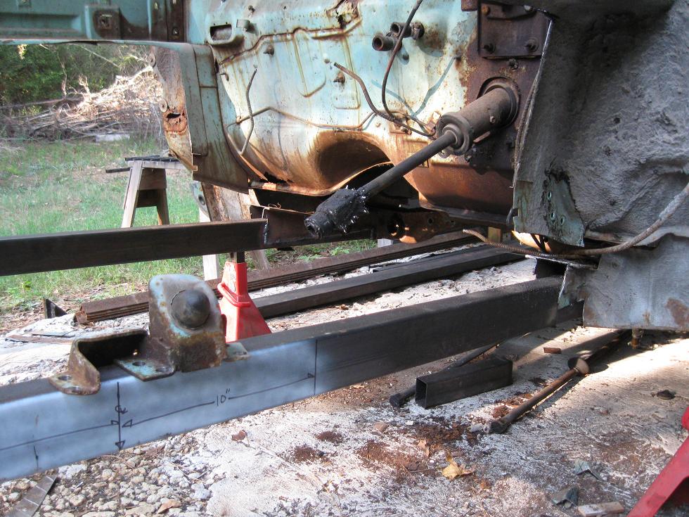

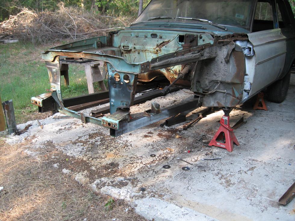

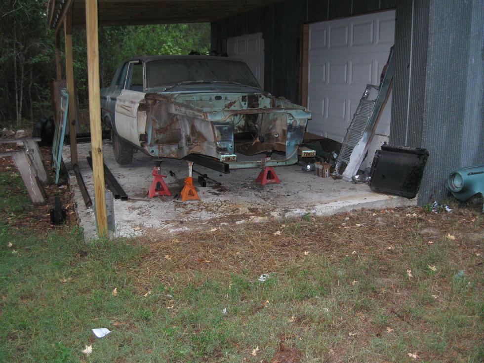

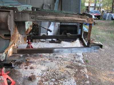

update

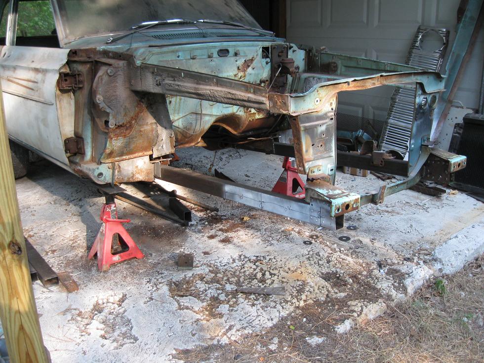

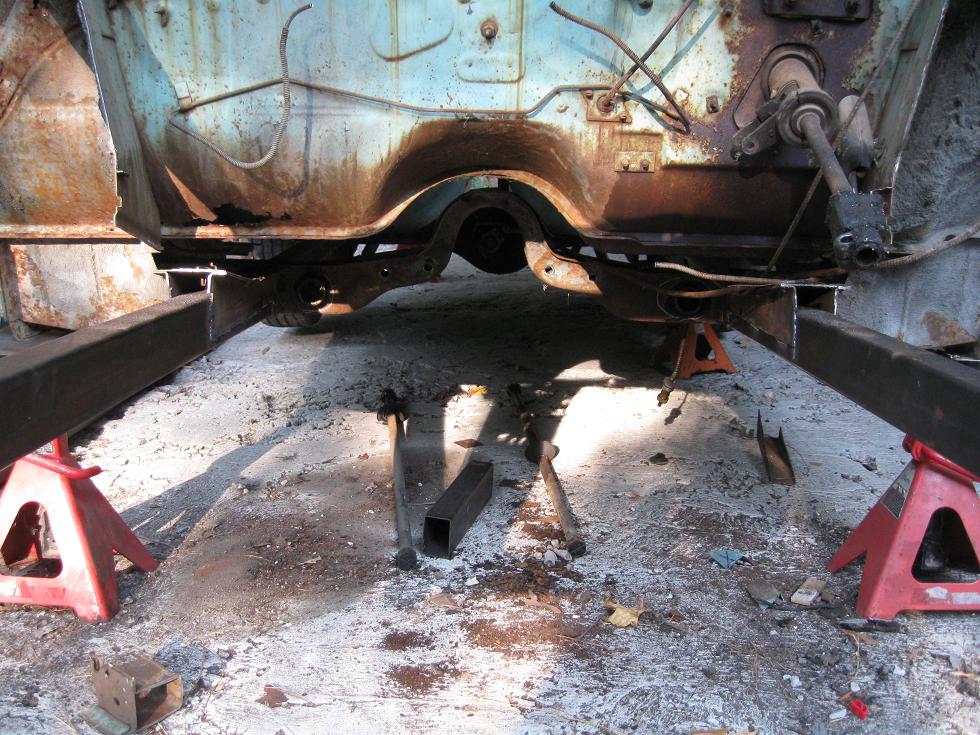

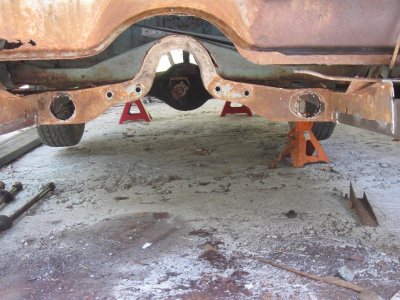

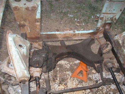

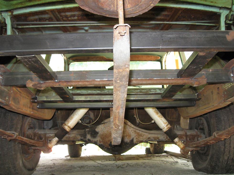

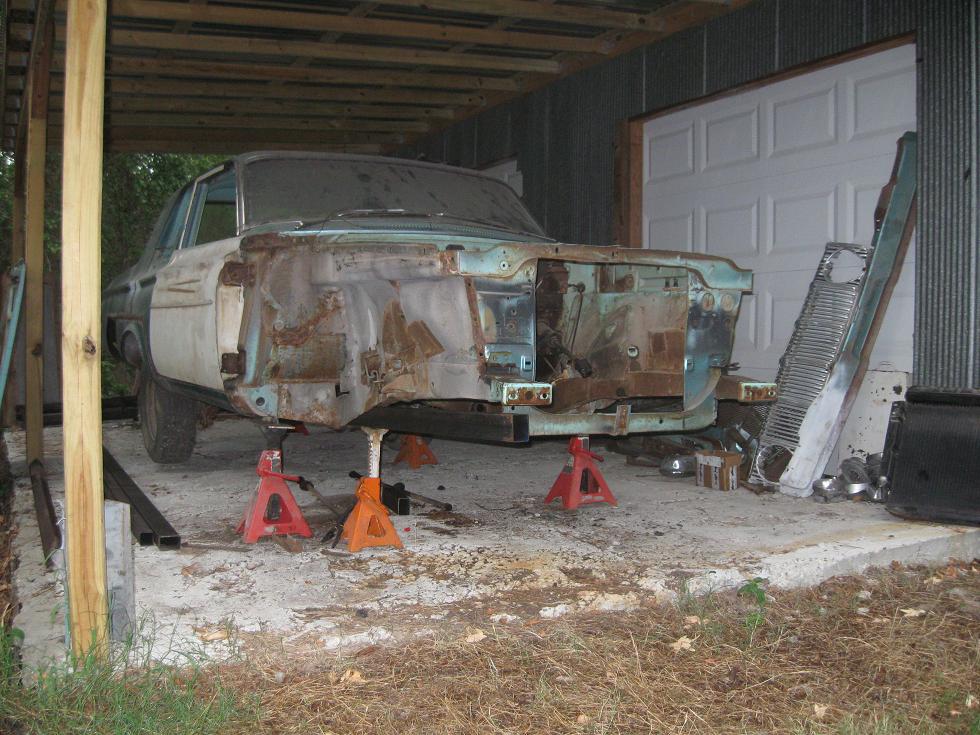

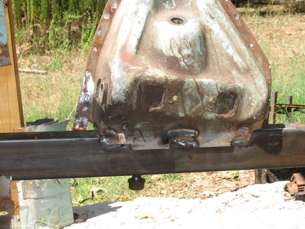

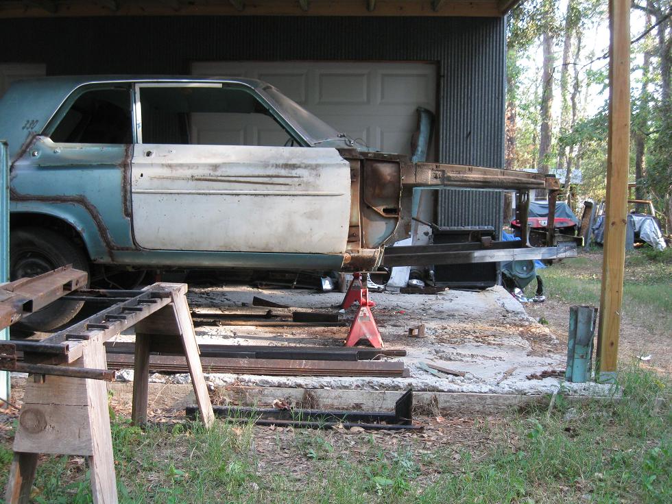

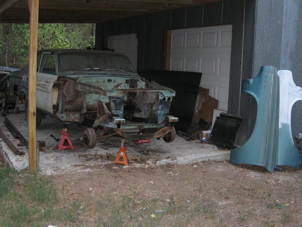

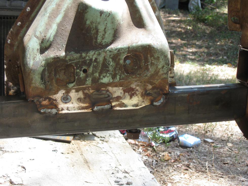

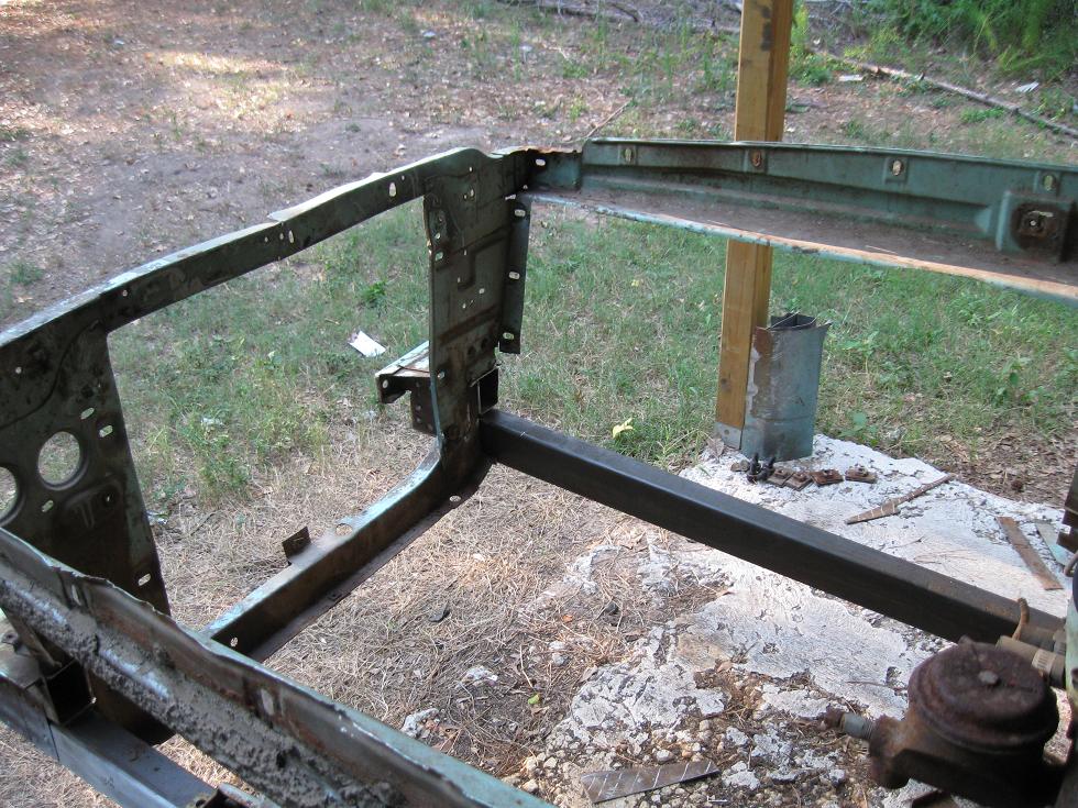

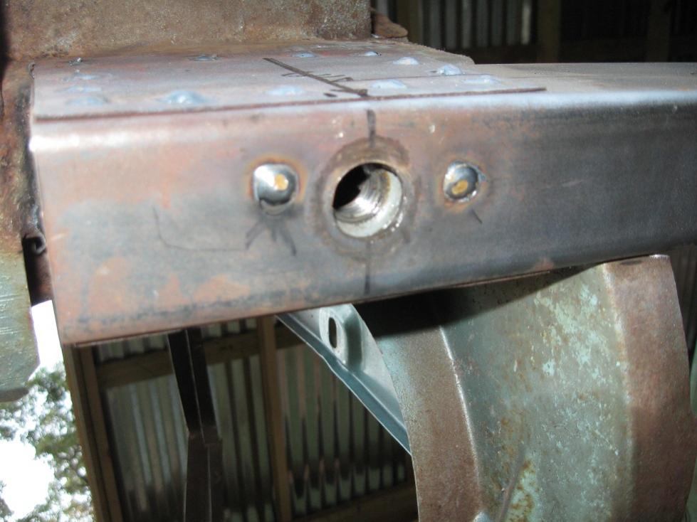

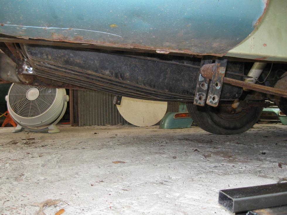

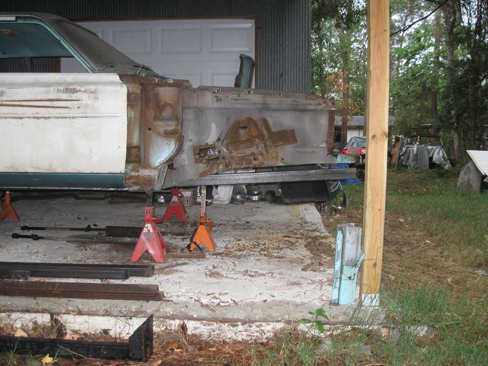

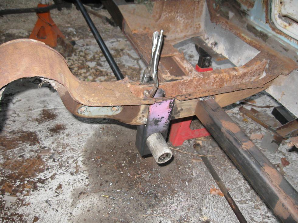

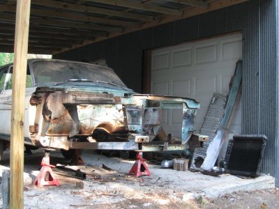

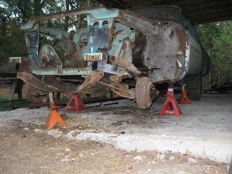

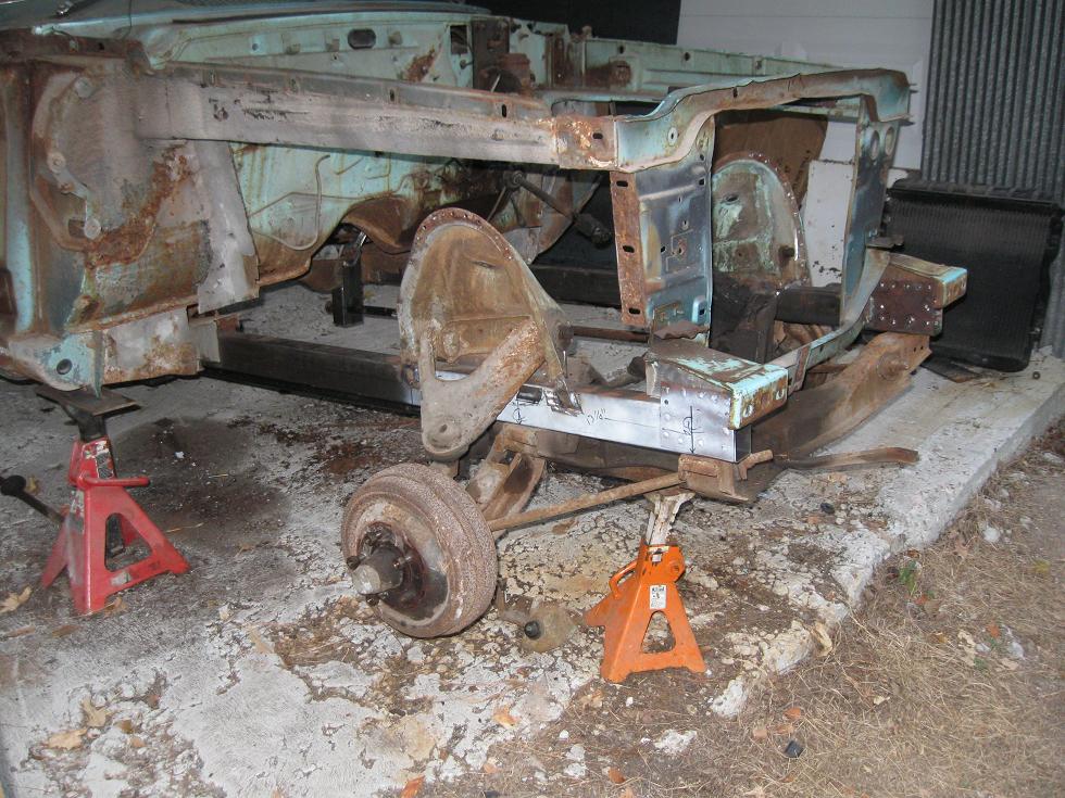

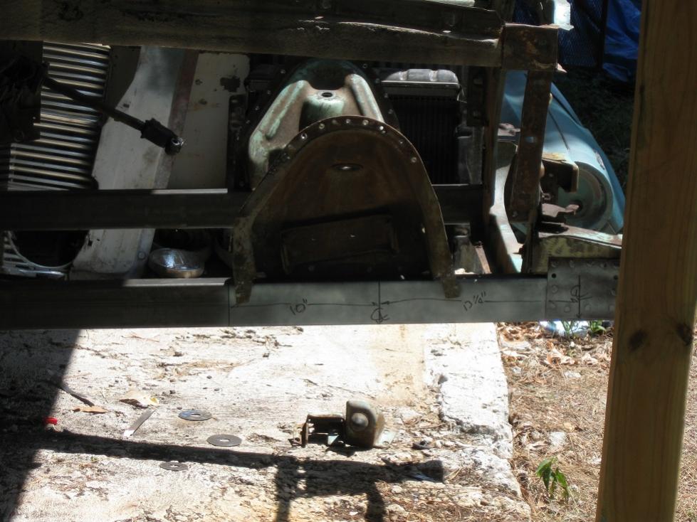

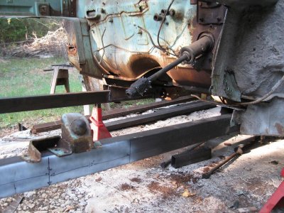

finished the gas tank and fitted thr frame connectors . next need to remove the motor and trans so i can get the front started .looks like the wheel opening is gonna be close may have to trim the bumper wish me luck :icon_thumleft:

Respect! Someone should give you a Hilborn-injected Hemi for free for all the work you've done!!

Can't agree more with Marcel...I'll add a 18 spline A833 to that. Makes me really jealous that i'm not a metalwizard...
Poly, Ive been quietly following along here with your project. The amount of work and the knowledge you have to do all this is amazing to say the least. You are going to have quite the ride when done.. Good luck with it but i don't think you'll need it from what ive seen!

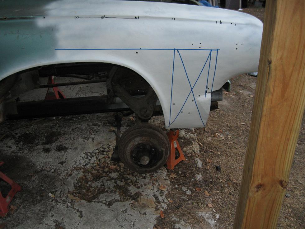

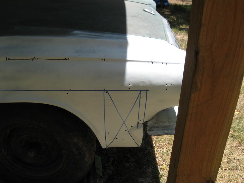

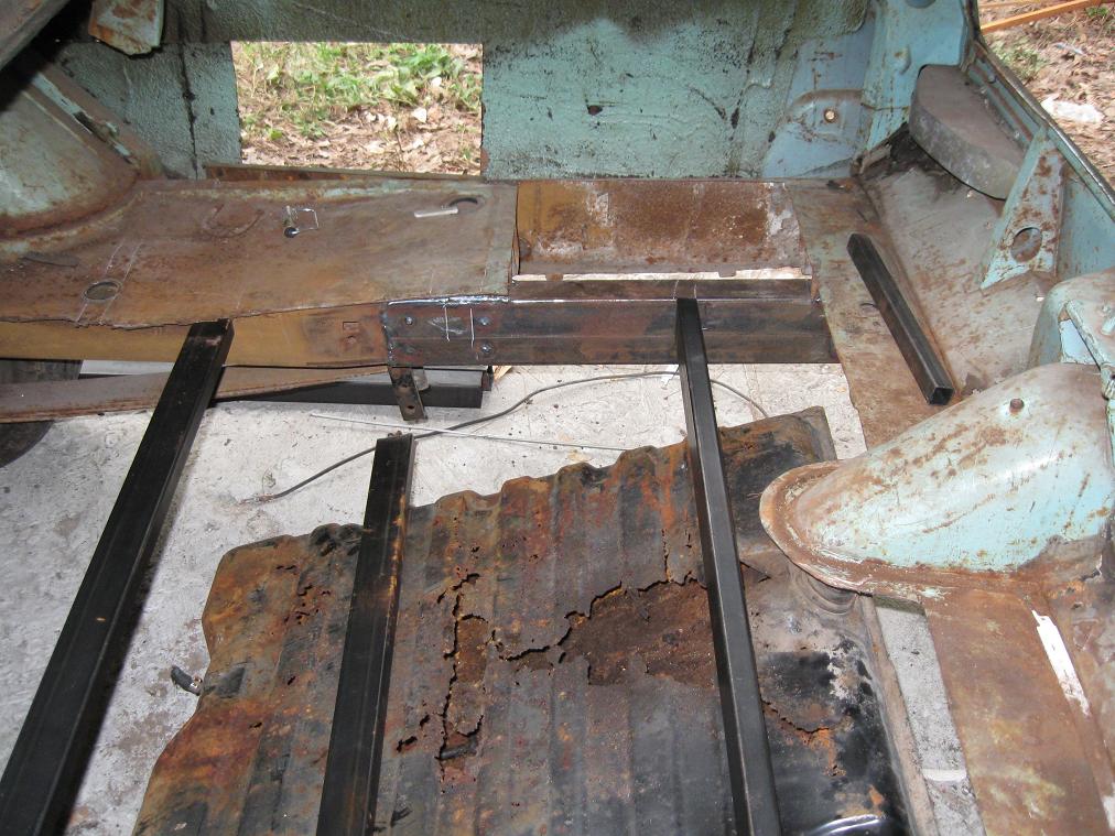

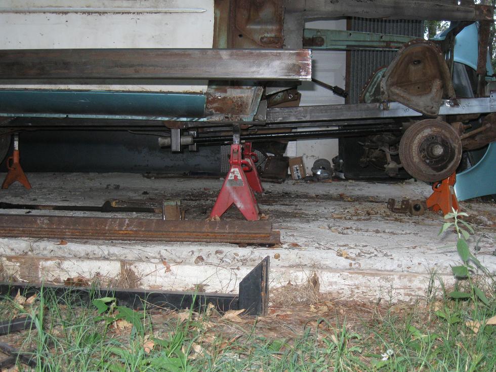

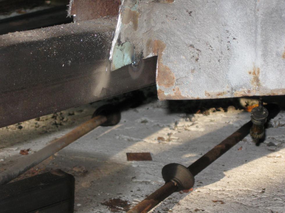

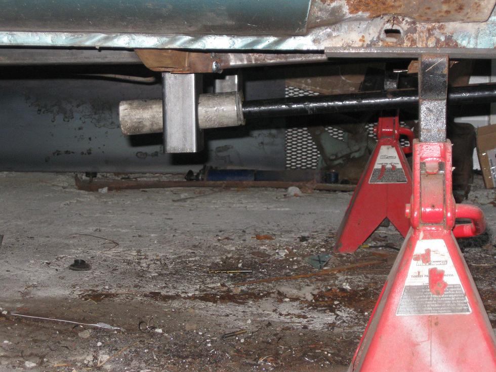

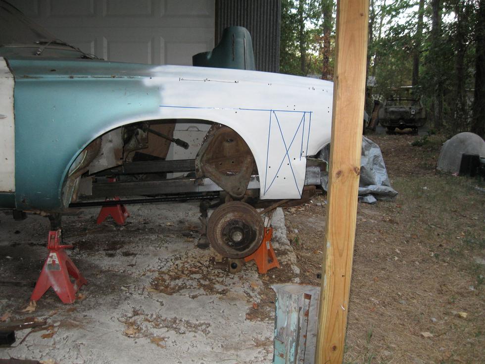

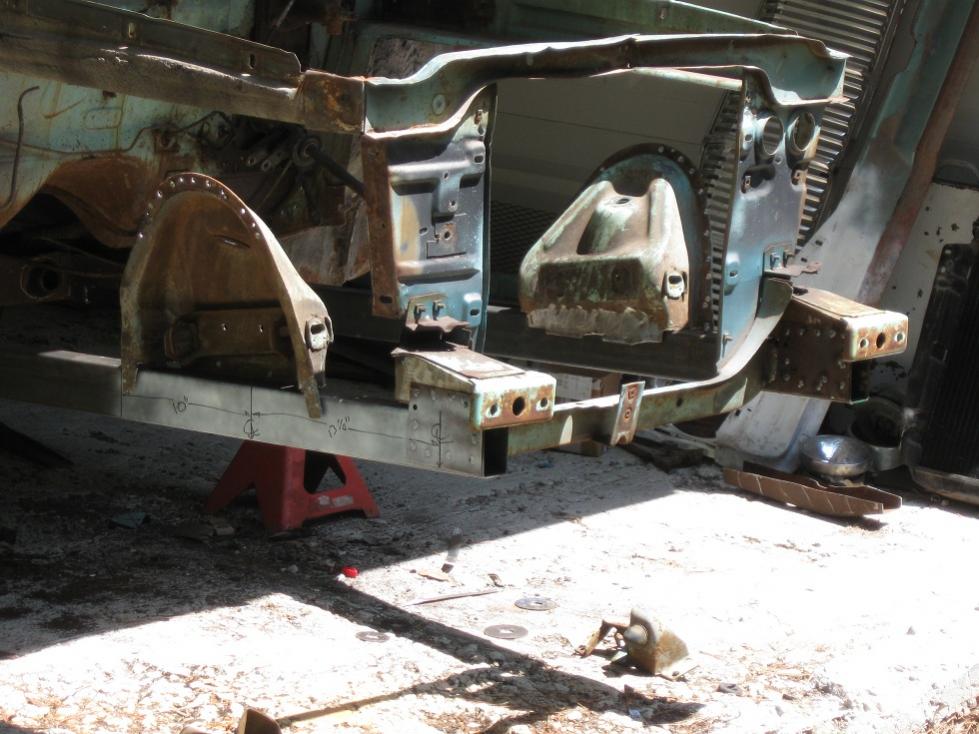

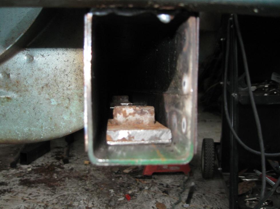

updates

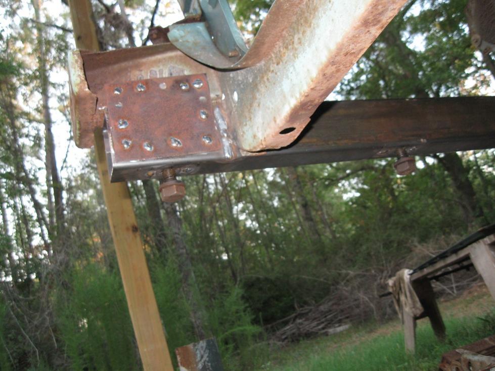

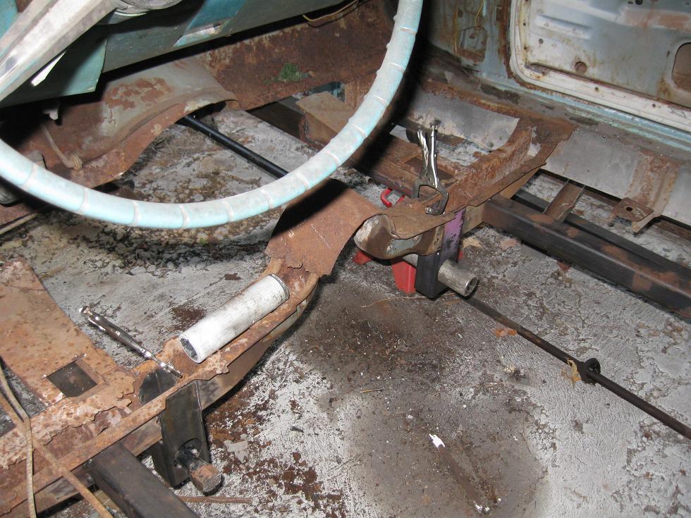

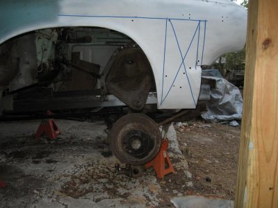

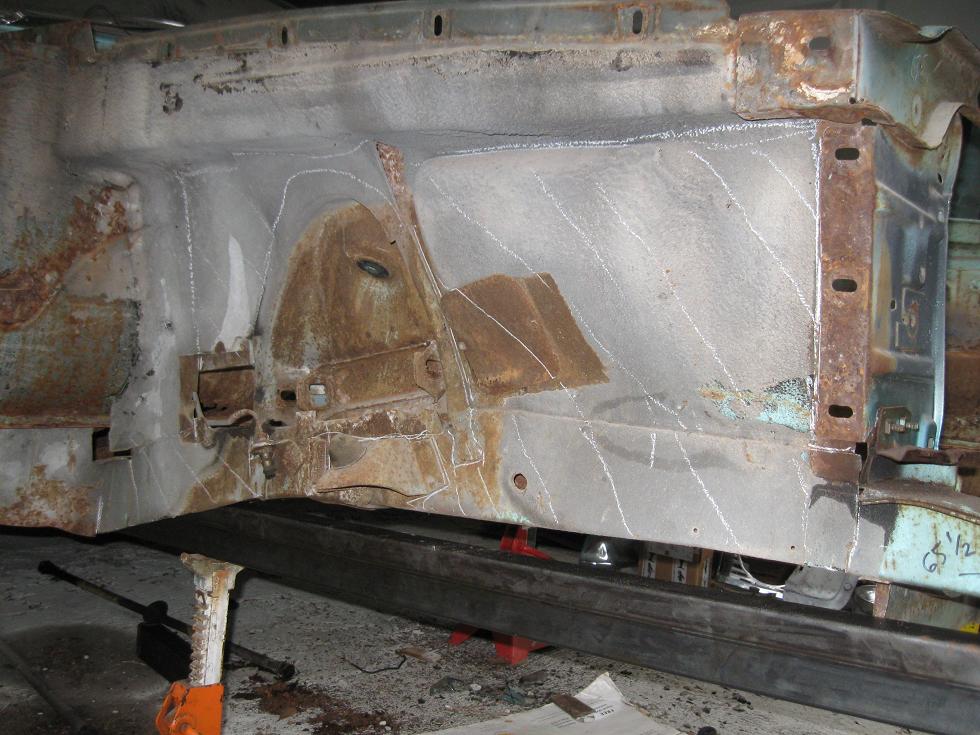

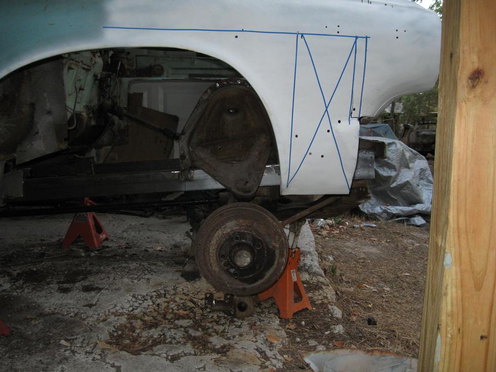

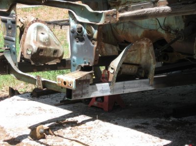

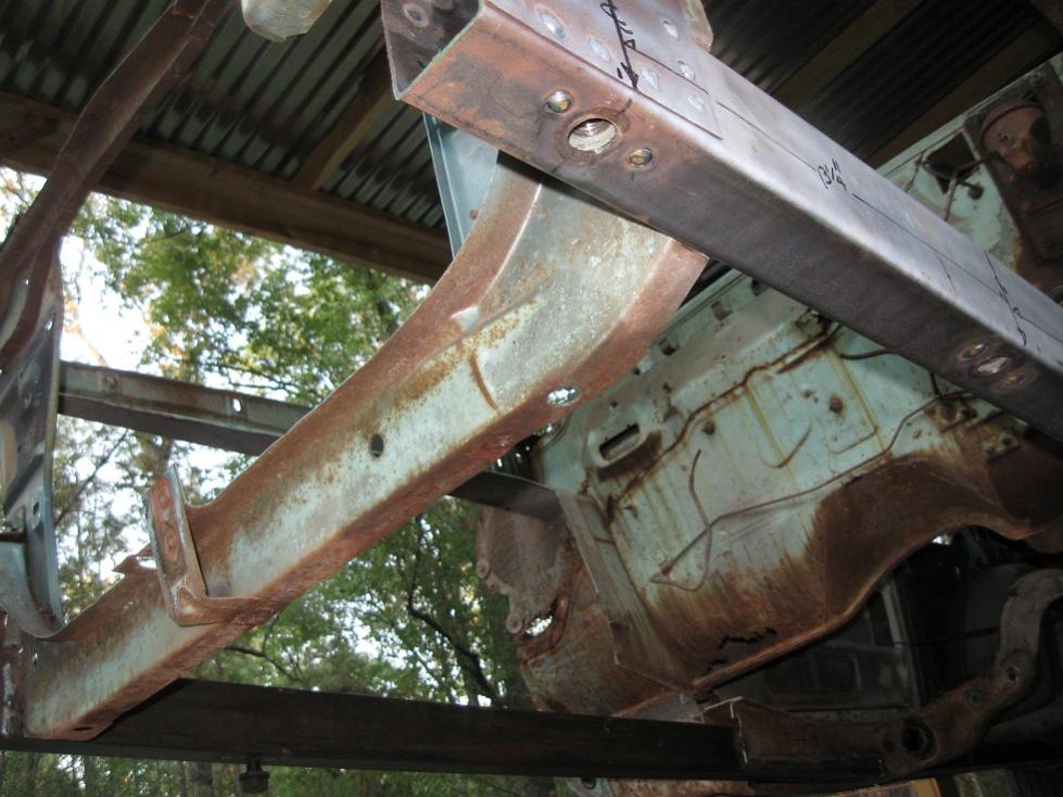

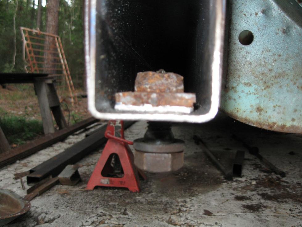

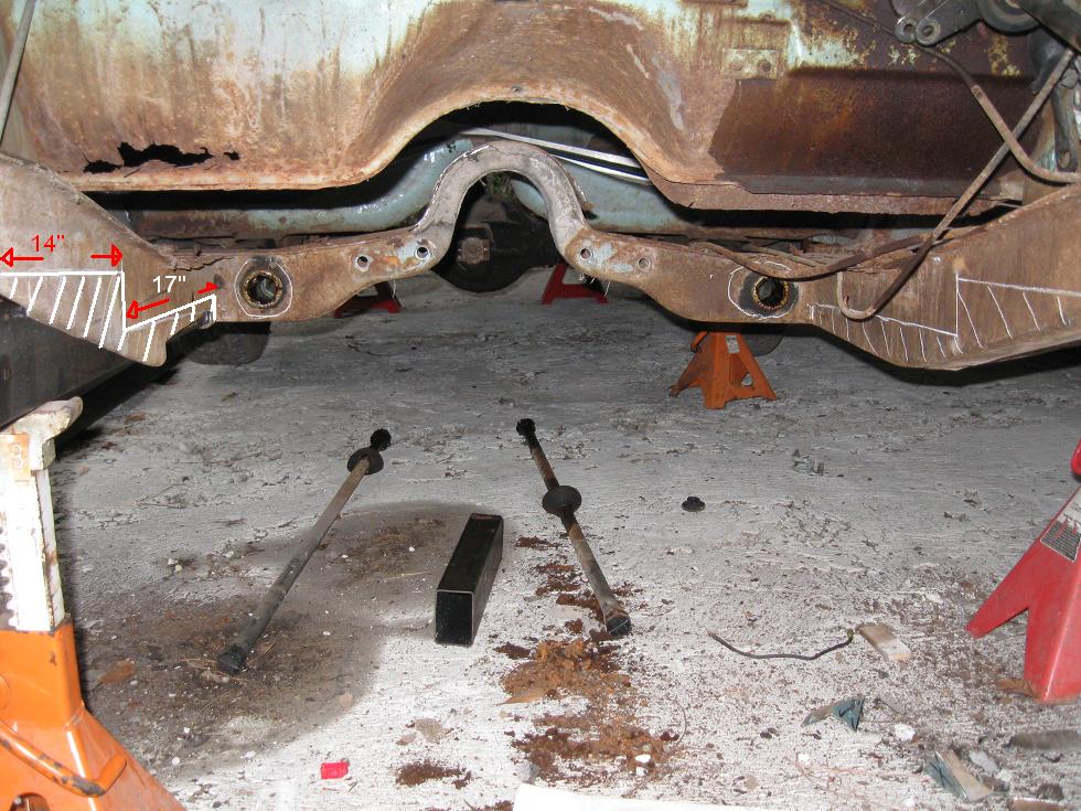

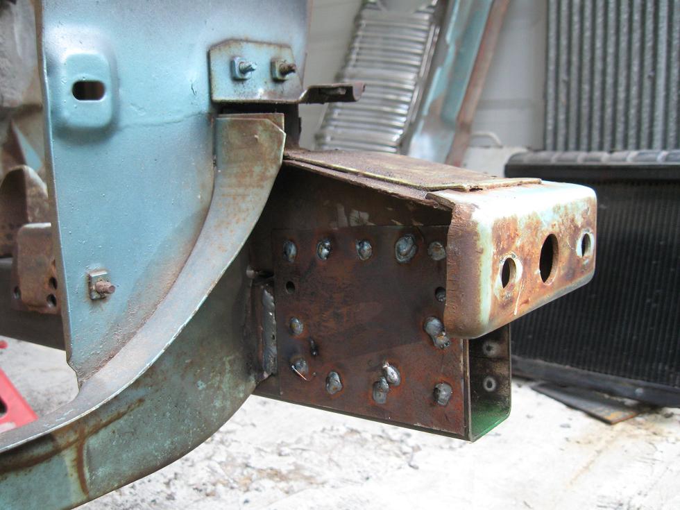

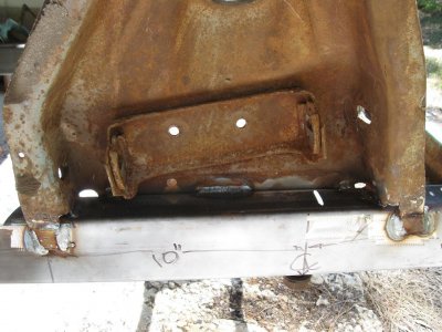

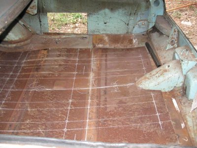

got my torsion sockets mocked up. the longer bars have to be resized to fit the sockets they seem to be larger than b body ones . front fenders are gonna be a little tricky
