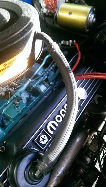

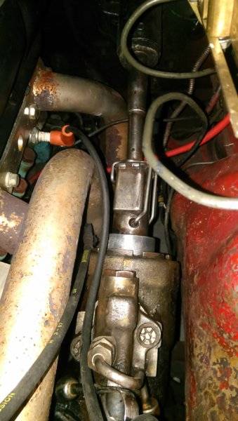

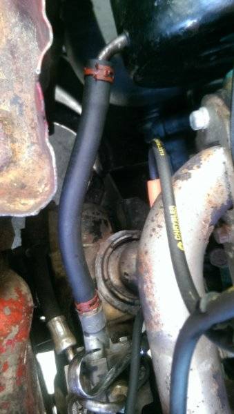

Got home from work this evening ate dinner & installed my return house & air cleaner hose. Took a while to get the hose off. Had to slit it around the upper tube to get it off so I could drain the reservoir.
Refilled it with Royal Purple MaxEZ Power Steering fluid and took it out for a drive. Nice & clean & no more leaks!

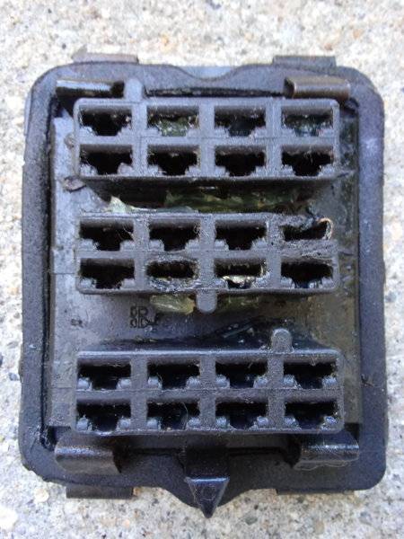

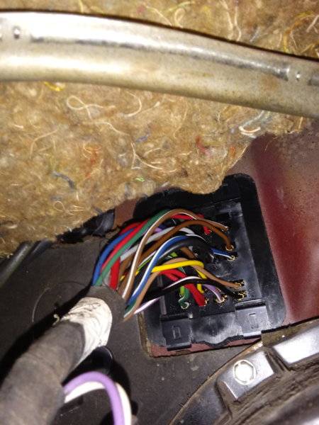

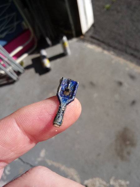

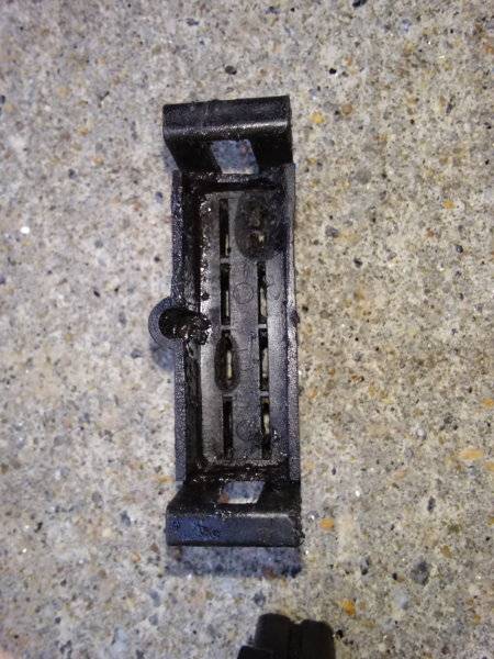

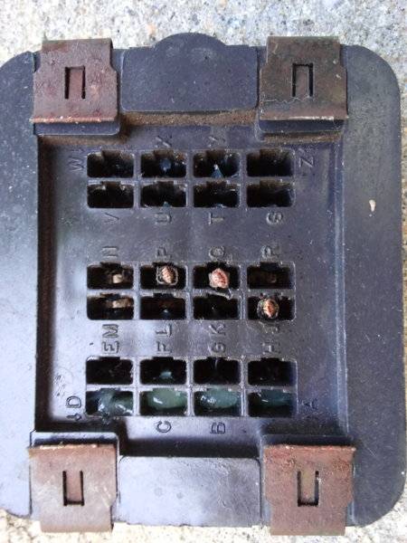

Been a while since I posted any new work. About a month ago I was losing all power & determined my issues was the bulkhead engine harness on the firewall side. https://www.forbbodiesonly.com/moparforum/threads/complete-loss-power-help-needed.153534/
I ended up replacing the entire bulkhead as well as a few connectors I got from Mega Parts and I'm back in business! I replaced all of the female connectors, which I noticed had blue paint on them. Any ideas as to why they were like this?

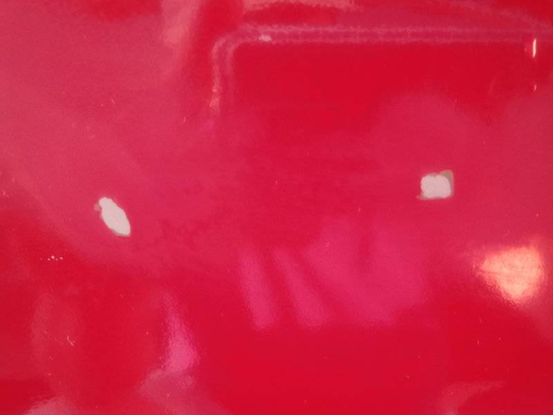

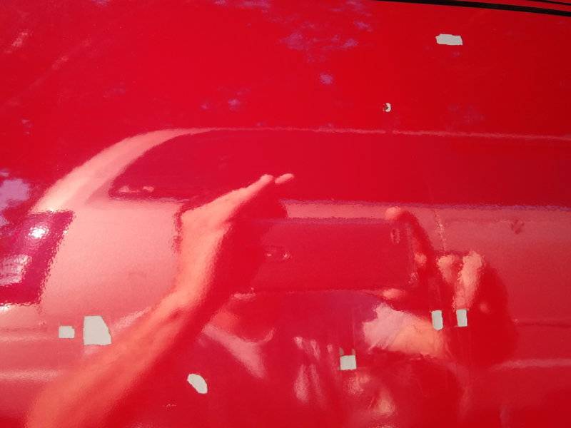

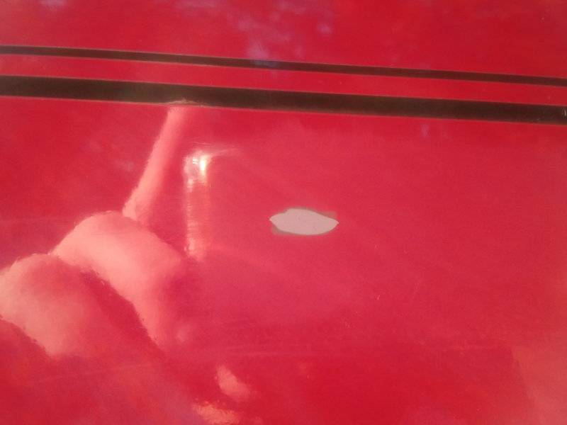

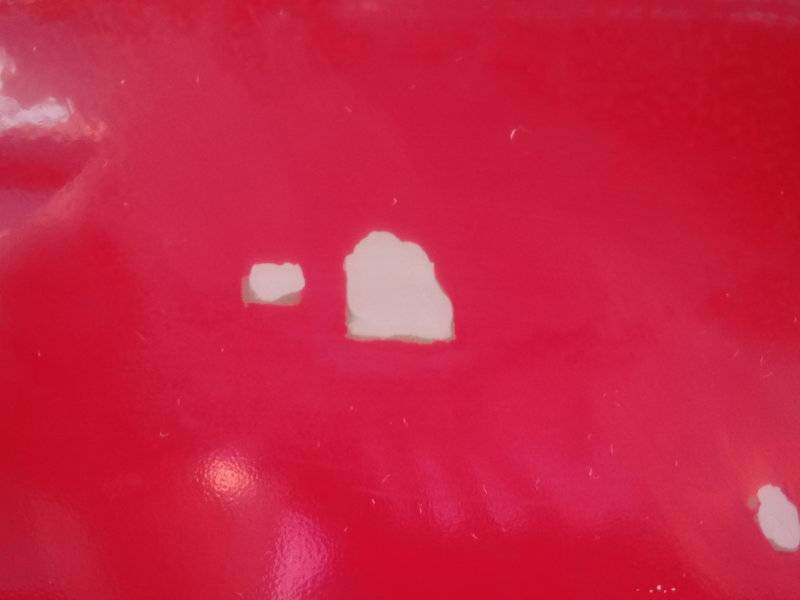

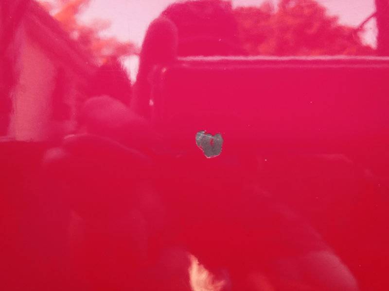

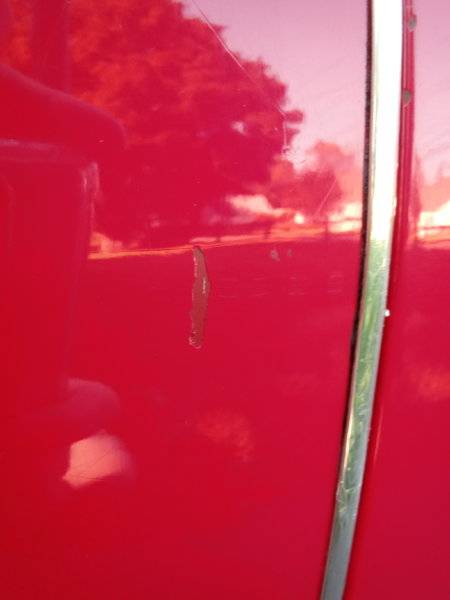

Well been a while since I've done any work on my car. Decided to tackle the paint chips. Went to a local autobody paint shop. They used a camera to match the paint & learned that my car was painted with lacquer paint, as when he cleaned off the hood his towel was red. I got a bottle with a brush.

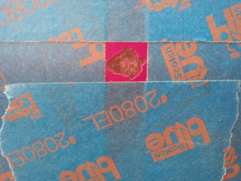

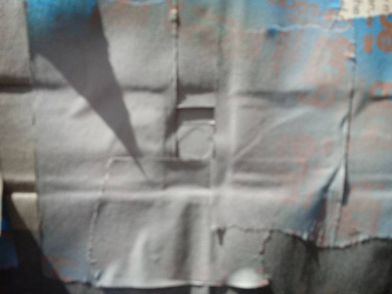

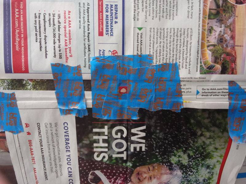

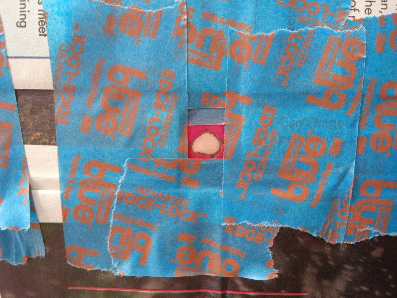

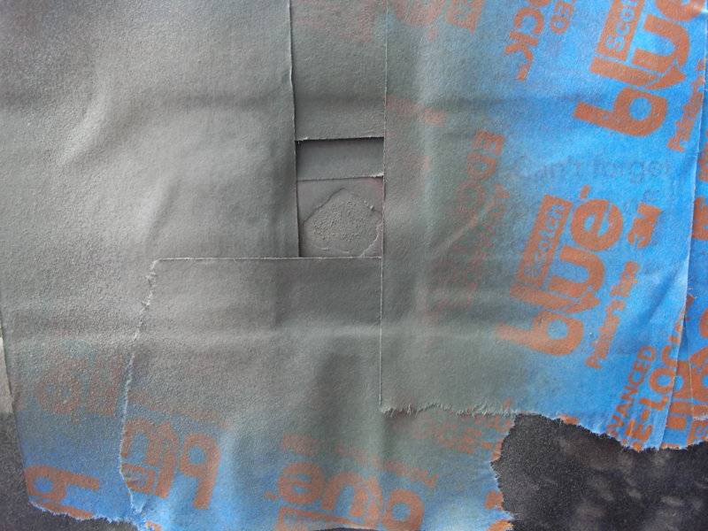

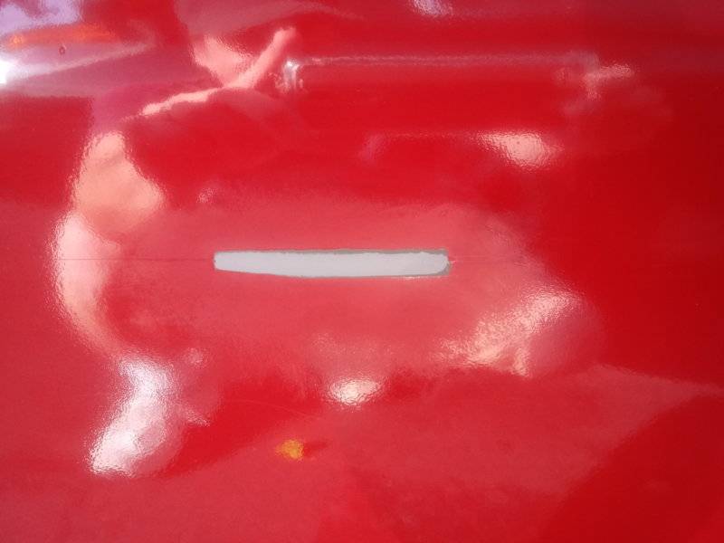

Anyhow got home, taped off the chip & then surrounded with newspaper & used pre-paint prep to remove wax & grease. Used 400 grit to clean the chips. Began with a few coats with self etching primer, then switched over to primer & slowly filled it with primer to fill in the chip. Removed the newspaper & then the tape to harden in the sun. Next weekend I'll re-tape around the primer, sand with 1000 grit & begin to apply the paint.
I practiced with the brush but I can't seem to layer up the paint with out leaving brush marks. Takes forever to paint, dry, sand/buff & then repaint. I've decided to apply my color matched paint as a spray as I'm better at that.

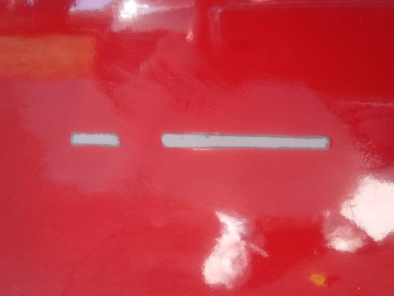

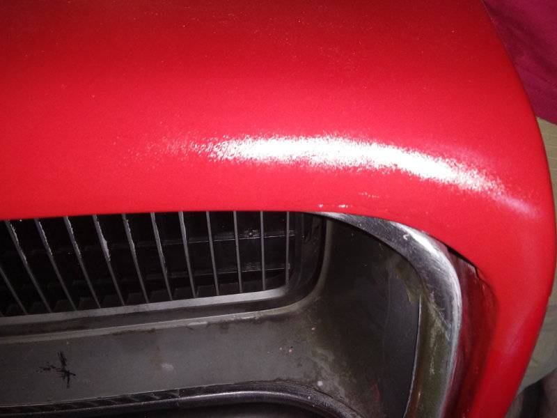

Now that the primer has cured since Sunday, tonight I wet sanded with 1000 grit to smooth everything out to be even with the existing paint.

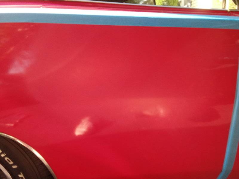

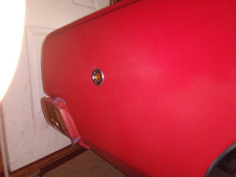

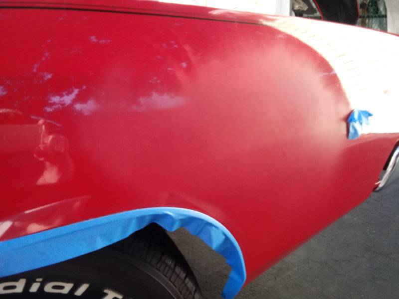

Today I taped off the chips & applied 2 coats of paint.
Removed tape after everything dried & wet sanded with 1000 grit to remove the tape lines as well as leveling the paint off with the surface. Cleaned it all off with a damp terrycloth towel & dried it off. Then hit with 2 more coats of paint to blend everything in.
After that dried I applied a base coat of clear. Once that dried I applied 2 more coats of clear. Next weekend I'll apply compound.

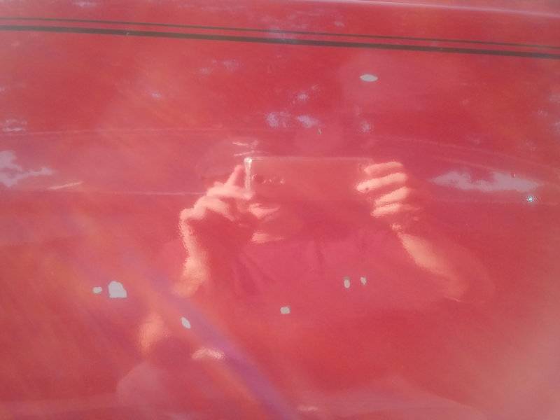

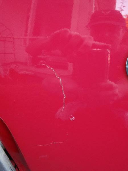

I'm very happy with my results. One thing I learned it to not tape off the chips when I go to paint as I then have wet sand the tape lines out. Tomorrow I plan to start on the drivers side now that I have a better idea on what I'm doing.
Long & HOT (90*) day today, sanded, cleaned, primed, painted & clear coated. Even cut the grass while the last coat of paint was drying...ugh!

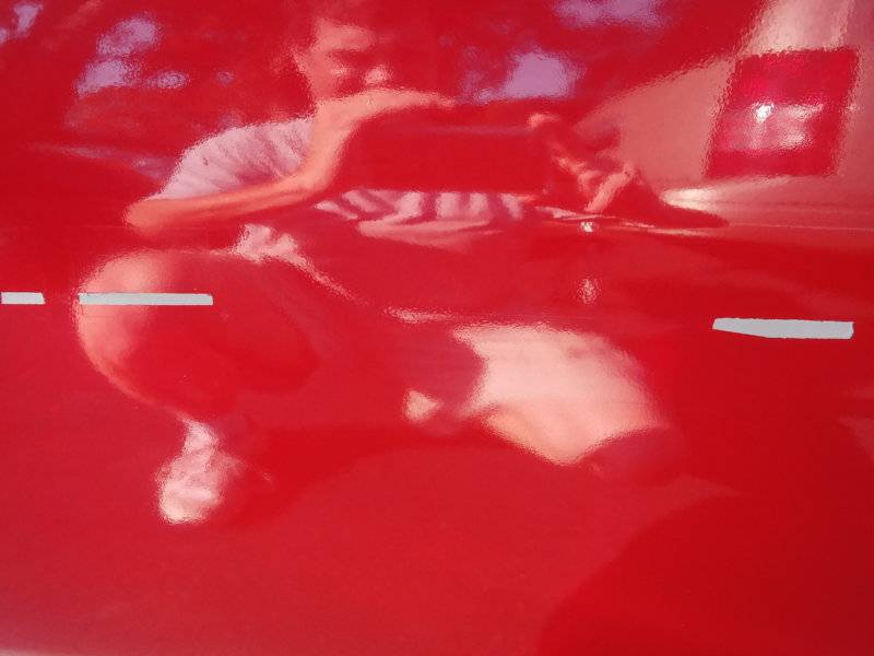

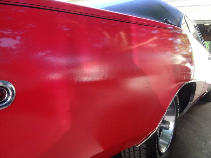

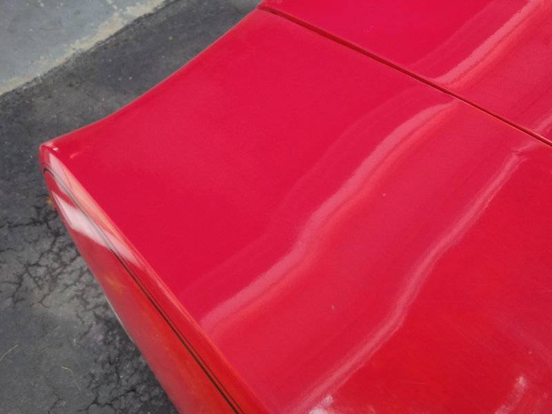

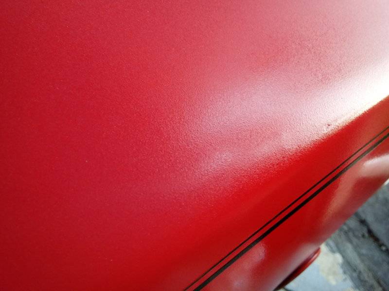

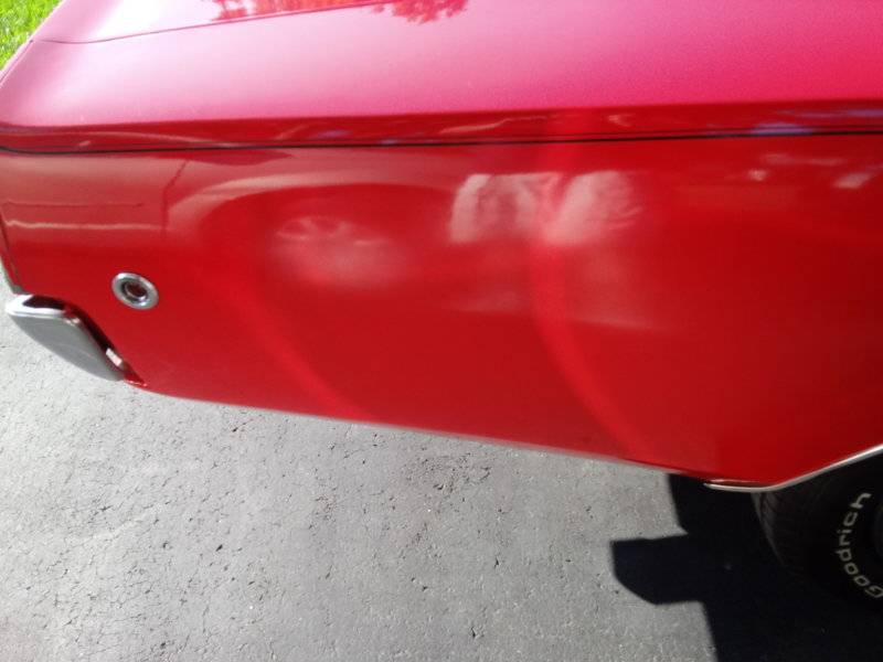

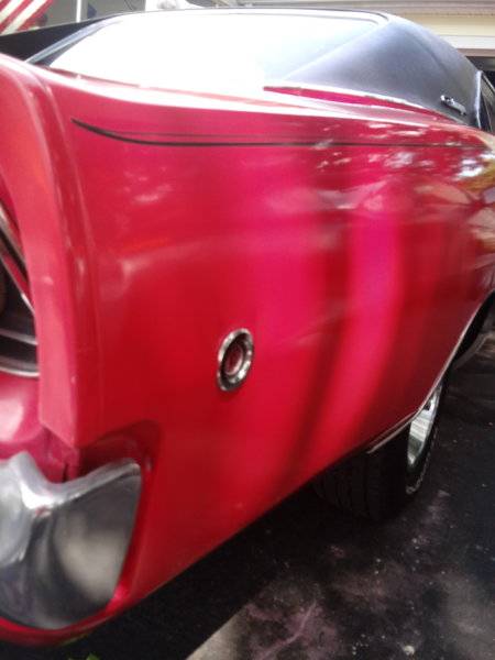

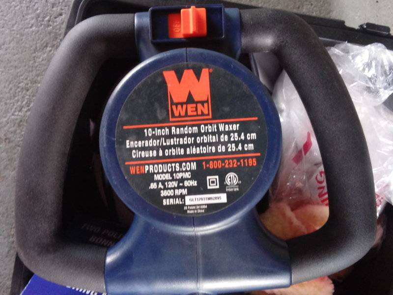

Busy weekend! Yesterday was pouring rain on & off all day so I worked in my small garage. Lighting isn't all that great but I did the best I could compounding & buffing the entire car. I began doing it by hand but decided that I wasn't getting enough pressure to really compound into the clear hard enough, so I went to my orbital waxer/polisher, was SO much easier! By the time I was done 2hrs later I was soaked due to all of the humidity & water I drank!

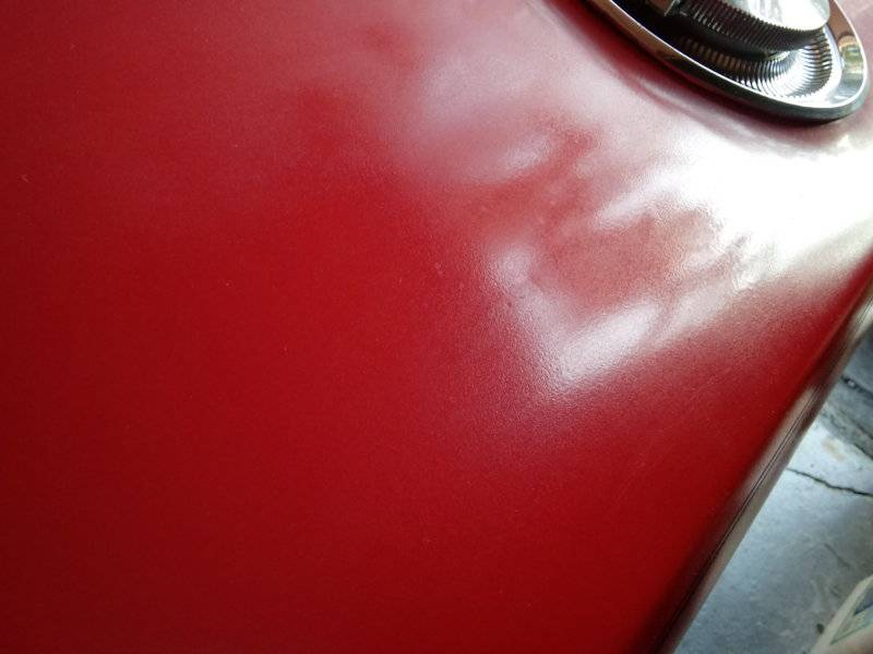

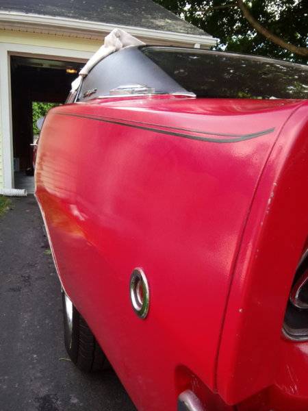

Today the weather was better, overcast & some sun poking out. Was still humid, UGH! Was able to back the car out to get a better look at yesterdays work. I could see that I had orange peal to contend with. One question I had was should I have wet sanded my final coat of paint & then applied the clear and then wet sanded the clear as well?

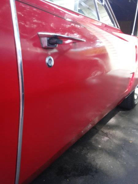

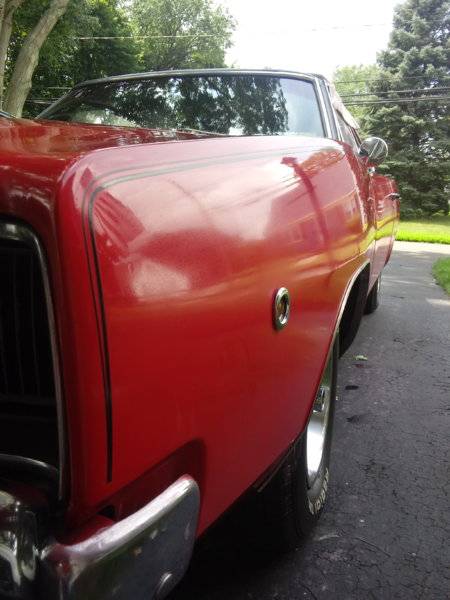

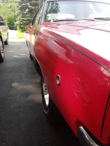

Soaked my 1500 grit sand paper & wet sanded the entire car in sections. Also re-compounded the sections again. After cleaning/buffing I could see some areas that needed to be wet sand & compound again so I did.
In the end I am very pleased with my work. I can see some areas that might need another wet sand/compound but decided that if I did more I could risk overdoing it, so I quit while I was ahead and not run the risk of making a huge mistake! In a couple of weeks I'll polish & wax the car after everything has had a chance to harden further. With these temps my garage is like an oven.
