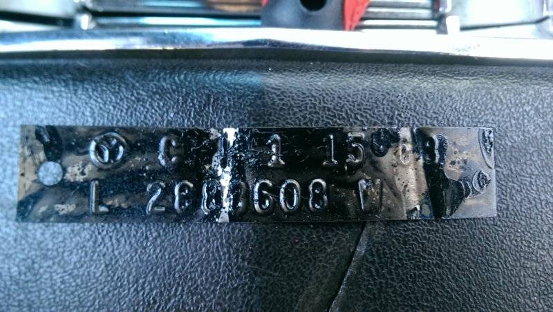

Today the wife & I took the car out to a vineyard to do some tastings. Car ran fine & went we got home I thoroughly cleaned the inside to get ready for the warmer temps. Also took the seat back covers off to see if anything was inside. Snapped some pics of the assembly tags.

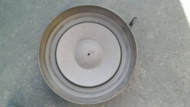

Had a special delivery today! Bought this orig. air cleaner from a fellow member here, now I can get rid of that ugly chrome one + the
orange pie tin my eBay site.

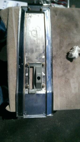

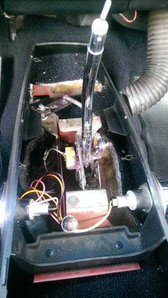

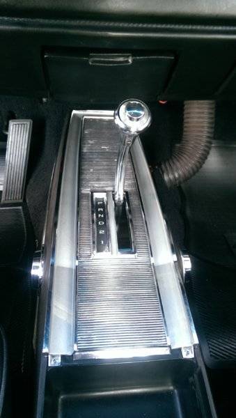

Busy day today but at least it was a beautiful day to be outside with just a light long sleeve shirt. Went down to the local auto parts store to p/u a air cleaner gasket. Got home put it on and then began to clean up the console. After 6hrs, had it all back together and then went cruising!

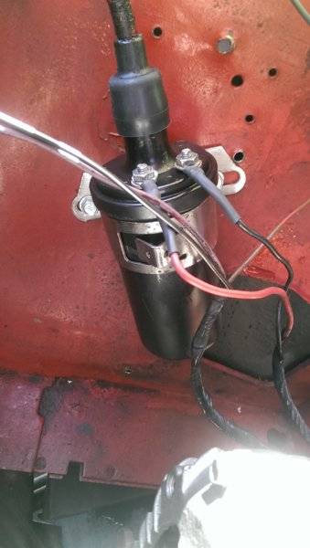

Seeing it's was a nice day today & tomorrow is going to be raw & rainy, just a little project today. Took out my old coil, cleaned it off & spray painted it Black, like the originals to save myself some money.

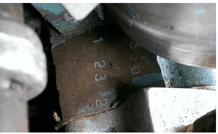

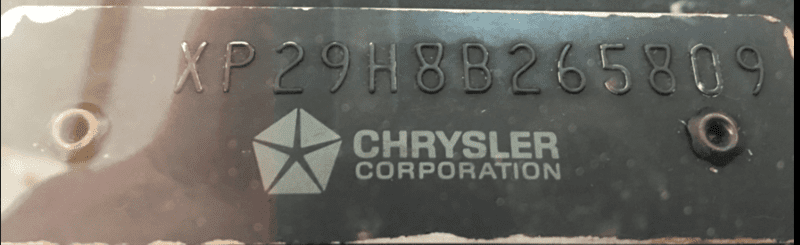

In reviewing some additional info I see my 383 vin has the H Code. I have the 383HP version. Was the HP not stamped on the pad in 68 or for 383's? Based on this is my 383 considered the 383 Magnum?
View attachment 595615 View attachment 595616 View attachment 595626 View attachment 595629
The H code only tells you it is a 383-4. It does not tell you WHICH 383-4 came in the car (this is a common confusion passed on by VIN decoders). A 68 Charger did not get the 335 horse assembly. It got the 330 horse with either transmission and with or without A/C.
This changed in 69 and 70.
A stock 68 Charger 383-4 would not be considered a Magnum.

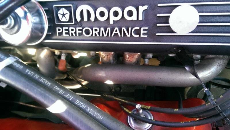

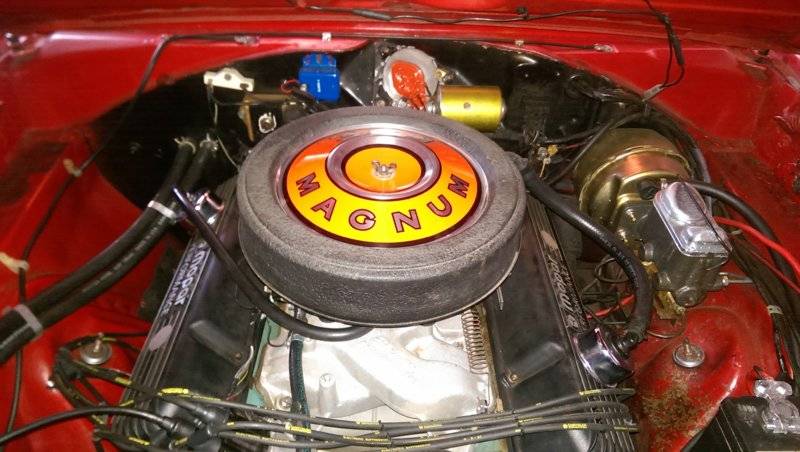

Busy weekend cleaning up the engine compartment. Was finally great to be outside in a short sleeve shirt!
Another reason why I hate headers......running plug wires properly.......
Looks like an octopus......You may want to look at some of the threads here and buy some proper holders for aftermarket parts aka headers....Maybe down the road you can ditch the headers and go back to a factory exhaust setup and use the correct loom brackets....

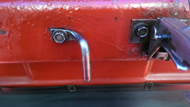

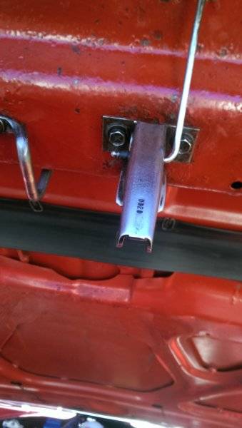

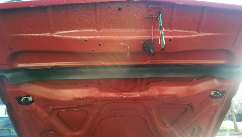

The hood safety catch and catch is originally black phosphate and eastwood sells a spray version that works well.....The hood latch bracket is painted body color.....

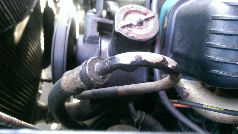

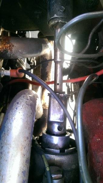

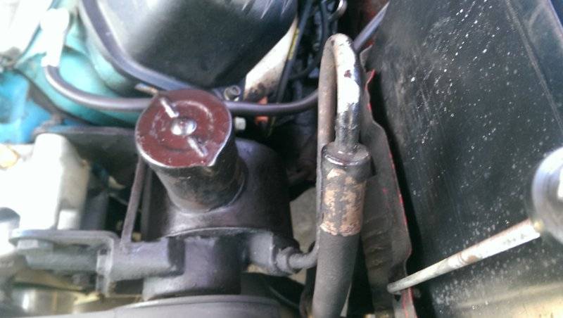

Is that an adapter on the power steering gear box? The piece between the coupler on the shaft and the box......
The federal mogul pump looks right for a 68 BB but why is the hose up against the battery tray?
Yea, headers are a bitch. Wish the wires were longer as it's pretty tight. At some point I'd love to do that.
Not sure about the coupler. Can you circle the area your talking about. The hose isn't right up against it, probably the shot angle.
