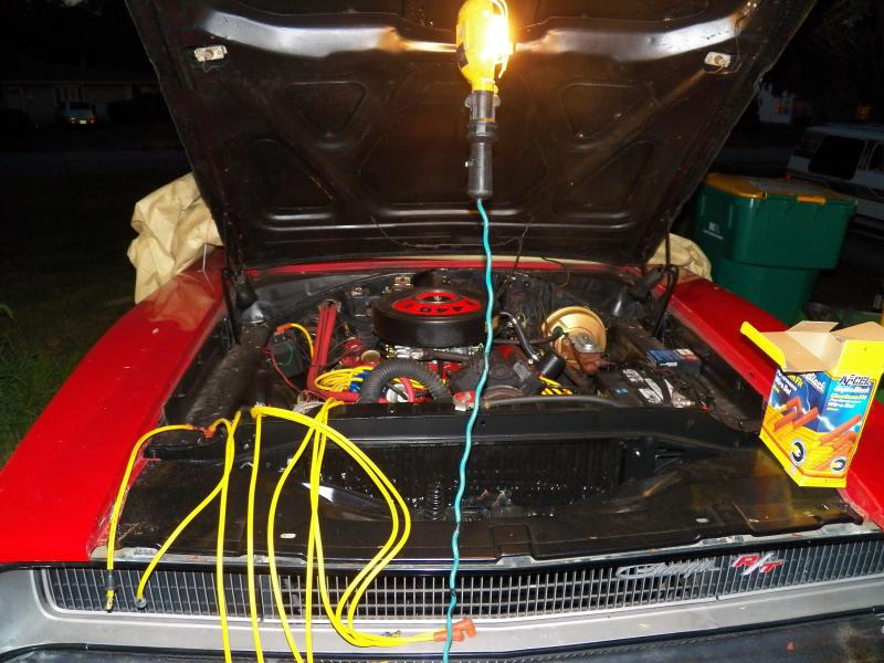

did you try to prime the engine with a little fuel, down the carb, to fire it up or see if it will fire anyway, then to see if it will then prime the fuel pump, sometimes it takes more than just cranking, the crap out of them, to pick up fuel & get the fuel thru the lines, up-to the carb the first time, especially if it's been sitting for a while.... good luck
