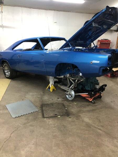

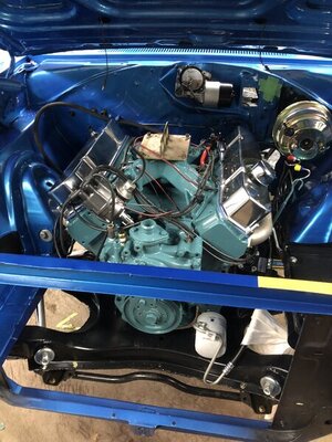

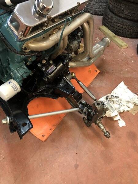

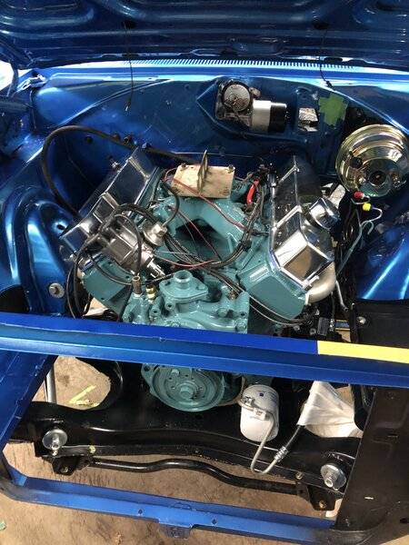

Yeah this was an after market kit that I got if the gold offends you I dare not show you the Chev master cylinder that came with itVery nice, but paint that gold brake booster black.

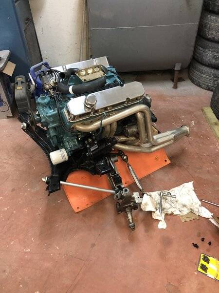

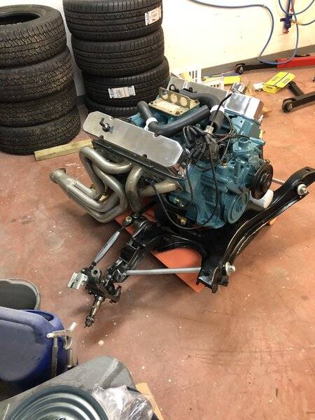

It is a bored and stroked 440 (493) it has aluminum heads mild hydraulic cam torker dome stamped rockers and MSD atomic EFI fuel injection. Build for high torque lower RPM. Not a screamer but she should pull real goodGREAT JOB !
Any Engine Build details ?
