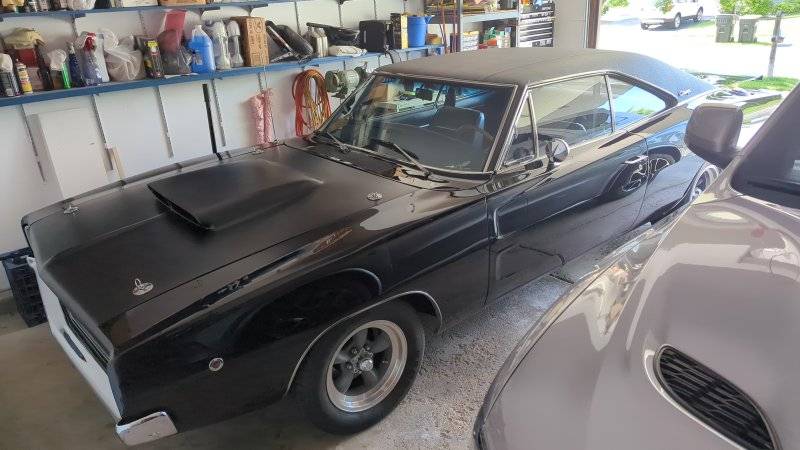

Why does my taillight fuse blow when I turn the lights on?
Short circuit. as mentioned check that the bulbs are correct for the sockets. I would remove all the bulbs and inspect sockets and wiring, the see if fuse blows with bulbs removed.
If it still blows, remove the drivers side kick panel and disconnect the rear wiring harness from the connector to see if the problem is in the dash area.
Door sill screw into harness wire?
No, it still did it once I had the still and kick panel off but not yet unplugged harness.
The car has been together since 2010 and just started doing this last week.
