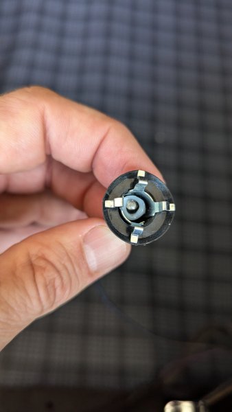

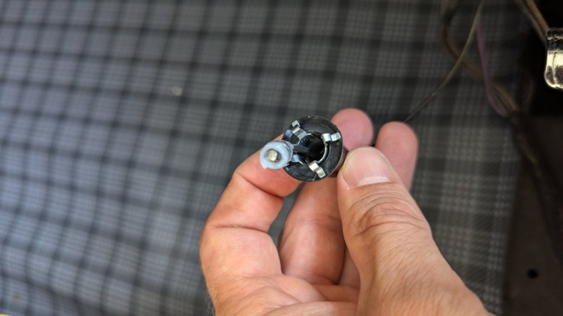

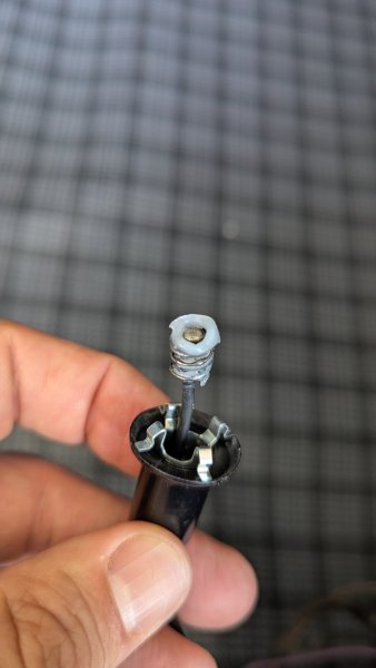

Here's the problem, pass side marker light. When I took the bulb out it is now all loose. Out the bulb back in, loose. Wiggle it around and it'll light up and then spark. Doesn't blow the fuse with the car off of course.
The other side is tight so I can't see what's inside it, should there be more filling? What holds it in place?

Heat has melted the plastic insulator and allowed the spring to move around inside the 'barrel' of the housing and the positive 12 Volts has contacted the negative (grounded) casing.

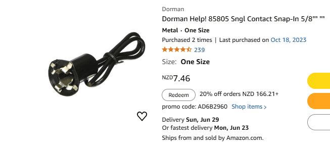

You can actually buy those from Amazon or possible even Rock Auto.
Got it, so the spring should be completely encased in the silicone?
No, but it should stand straight inside the housing - the melted plastic has allowed it to tilt and move around. Probably moved when you were stacking your lawn chairs in for a car show....or something moved while driving.
