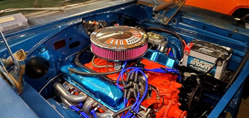

How did the summit headers fit? Did you have to bash them at all? Do you have a 440 and/I got a wild hair last night and checked off a bunch of stuff left on the "still need to buy" list. The sky was not the limit but I didn't buy a bunch of junk either.
Summit ceramic coated headers - I've been running these same headers on my 72 for about 8 years or so now and they have held up good and still look nice and fitment was pretty good on the 72.
Summit 2.5" mandrel bent aluminized steel exhaust with their knock off Flowmaster mufflers - I'm running the same system but 3" on the 72 with Flowmaster 40's. It won't bolt up perfect but I was able to fit them once, I can do it again.
Remflex header gaskets
Dorman studs for the headers
Summit mini starter
Pertronix distributor conversion - I had a new backup points distributor for the 72 after I built it because the electronic ignition left me stranded a couple times while working bugs out. I'll just convert it over for the Charger since the 72 is fine now and no longer has a 440
Pertronix Flame-Thrower coil
Lokar throttle cable
Lokar bracket
Lokar kick down cable - Again, I've run these on the 72 for years and they've always worked flawlessly
Mopar 26" fan shroud - Should be able to modify that to fit the new 3 core aluminum rad I got a couple weeks ago
Hayden HD fan clutch
Taylor Spiro 8mm plug wires
That should wrap up many of the systems that are left. It had a flex fan on it but that'll be going and I'll hunt down a 7 blade original fan. Will probably get a Mancini high volume water pump and housing since it has worked so well on the 72 along with a Milodon thermostat.

In my experience with these headers, they fit perfect on my 400 stroker but on the 440, the driver side header will rub on the driver side torsion bar and 1 or 2 tubes have to be dimpled to give a little space. Not a lot, but some. And that sucks when you spend that extra money for the ceramic coating. Either way, they look great, work good, one set has lasted me over 10 years and still look good.How did the summit headers fit? Did you have to bash them at all? Do you have a 440 and/
Do you have the summit headers on a 72 satellite with 440 and/or power steering box? If so how did they fit? Did you have to bash them at all?
Awesome thanks so much for the information. I will buy a set and do as you suggested. Thanks a lotIn my experience with these headers, they fit perfect on my 400 stroker but on the 440, the driver side header will rub on the driver side torsion bar and 1 or 2 tubes have to be dimpled to give a little space. Not a lot, but some. And that sucks when you spend that extra money for the ceramic coating. Either way, they look great, work good, one set has lasted me over 10 years and still look good.
Oh and there is no issue with the stock power steering box on any of the cars I've installed them on.
I've pulled my engine several times now, swapping from this one to that one or whatever and you want to put some masking tape on the tubes to prevent scratches, then stick those headers down in the engine compartment about where they go and then drop your engine in. You won't get those fat headers in unless the engine is well up in the air anyway then fit them as you drop it in. The pass side is easy, the drive side is tight. I also used exhaust studs so I could hang them on the engine loose once I got it close and dont have to fiddle with lining up bolts. I actually put the studs in on a engine stand, fit the headers, then marked my studs and chopped the excess off of them. I would highly suggest doing that before you try to stab it all in because several if the studs will probably be too long and will hit the tubes of the header. And the gaskets they send with the headers are trash. I used RFL-6002 gaskets. No leaks.
Hope that helps.

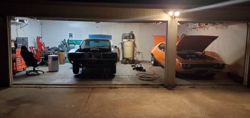

Have a short list of things left to do so I took a day yesterday and started packing the garage up. Knocked it out about half way or more I'd say but worked my *** off to do so. Felt pretty wore out today but I did some more garage packing and then cleaned the orange car up. Hit it with the clay bar to get all the crap off of it that might have wafted that way when I was doing the Charger. It was naaasty. Then I waxed it up.
As I was washing the 72, I was thinking I should have come up with a name for it by now. I just call it "the orange car". But when I built it I wanted it to look like a mix between The General Lee and Daisy's car. Then I thought "well it IS generally Daisy's car"....
"Generally Daisy". I like that.
Blessed to have my dream cars. I just hope they fit in the next garage...
