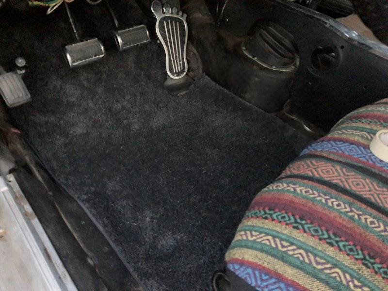

Do you have the “correct” pedal for your accelerator? :lol:
Maybe not the "correct one" like that, but I have the original which Cliff had removed for fear that it would fall through the hole in the floor as it had rotted through in that area when he had it. There was only a hole there and the pivoting part of the pedal bolted to the firewall.
I think I will go the same route you did and get some floor mats to class up the joint. At this point I'll have to save for a while before I can splurge on a foot print gas pedal :D

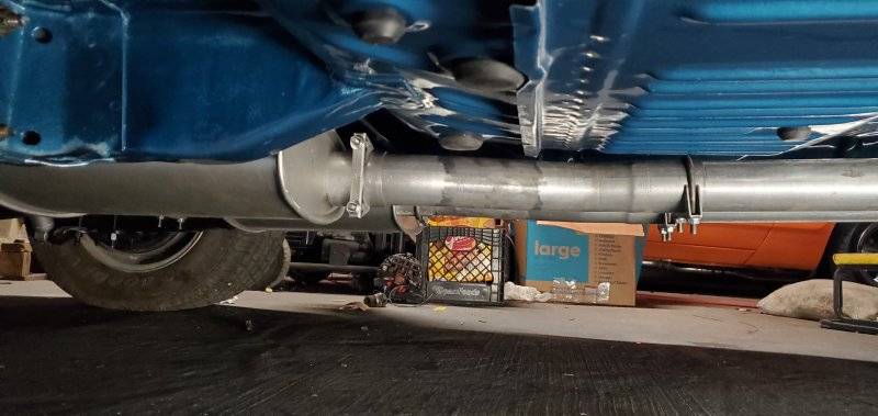

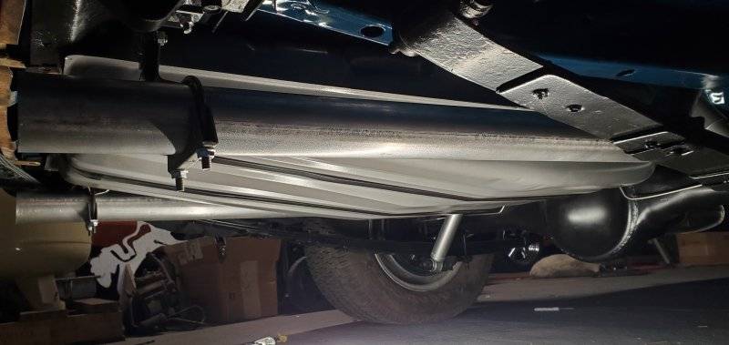

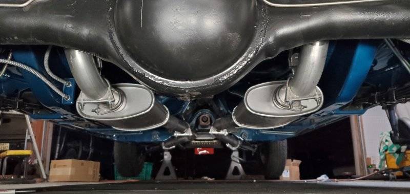

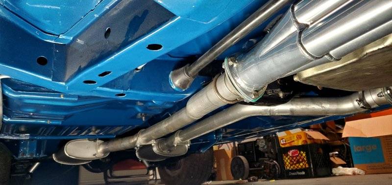

I installed the Summit 2.5" exhaust yesterday and I feel like I was run through a wringer and drug along the concrete today. Not a fun job on jackstands but I'd done a 3" system on the orange car so I knew what to expect. The 2.5" was much easier but required much of the same modification to fit the Summit headers.
Seems weird that their house brand exhaust system isn't made to fit their house brand headers but what do I know? I'm just the dummy who has to make it work either way.
I will take it and have most those clamps removed, welded up, and buy some tips. I have not mastered the art of welding upside down and using a mirror :D
But in the end I'd recommend that exhaust. Its $420 with the knock off Flowmasters. The pass side just bolted right up and fit great. The dr side front pipe was the only one that required modification. I shortened it an inch to get it off the trans xmember and then split it before the 2nd bend and angled it up, level with the body and pass side pipe, marked it, tacked it, checked it, and welded it back together. The rest just bolted up. I had to get creative with the rear hangers but was able to shorten them and have it come out pretty decent without drilling any holes or anything crazy but those will probably get replaced at the muffler shop when I get tips.

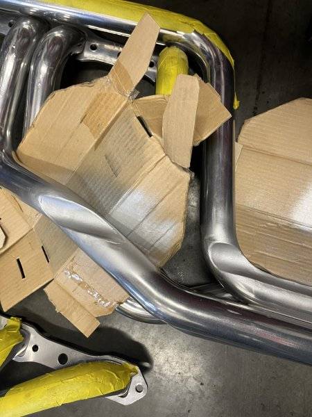

How did your Summit headers fit? I had a hell of a problem with mine...passenger side hit the torsion bar, driver side couldn't even be installed and had to be seriously modified!
I've got those headers on both my cars now and they fit pretty decent on both but yes, they hit the torsion bars and have to be dimpled in those areas.
They were tight on the steering box on my orange car because it is PS and had the original box but it didn't take much to get them past it. This car has the Borgeson box so there is all kinds of room there.
I only bought those again because they are half what all the other headers cost and most of those headers have their issues as well.
The trick I learned is, use studs, test fit on the stand and cut down your studs where they hit the header, then lay the headers in the engine compartment, lay the starter on the dr side one, drop engine in, stop a few inches short and start working them on your studs as you drop them in.
Here’s my dimpling!
I took it to a local Speed Shop and they modified the headers, installed them and the full exhaust kit.
We had to do something similar once, sliced a tube in half then welded it into the tube. Made it look like yours do now.
Honestly I wasn’t expecting that level of quality lol I thought they’d just dimple the headers and get them fitted.
Dang! Yeah mine don't hit like THAT. Ouch! They fixed them nicely though.

There’s an episode of engine masters, they squished every tube, and they lost maybe 1hp.
I saw that episode, but I still do the minimum possible. I just know that it doesn't affect a thing after watching that episode. I mean they bashed the crap out of those headers trying to kill power and couldn't.
That was their point and my point, they destroyed those headers! So just a few little clearance dents aren’t going to hurt
I was hesitant to do that much modifying, however the two factors that made my decision for me was a. watching that episode of Engine Masters and b. zero availability of TTI headers, so I went that route instead of gambling on another brand and wasting more money.
