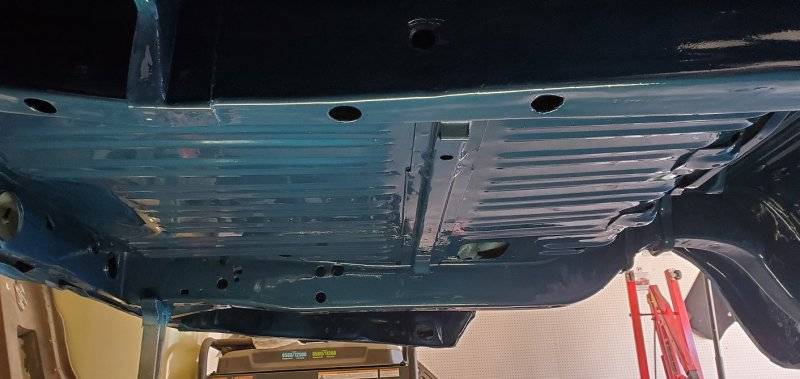

I was stumped about how the hell I was going to prime and paint upside down with a HVLP gun. I had thought about buying a pot style gun but saw too many issues with leaking and I don't have the cash to waste on something that might not work or might waste a bunch of paint so I kept looking. I ended up going with the Devilbiss Dekup system. It was actually fairly cheap and involved using a fitting on my gun which adapts it to the Dekups cup and with that cup you are able to use disposable liners and most importantly allows you to purge the air out of the cup and turn your gun upside down and still be able to spray (bad explanation so look it up on youtube, I recommend the system if you have a similar issue).
When I climbed out from under the car after the final coat, I looked a bit like a Jamaican Blue smurf. It's so damn hot there's no way you could wear anything other than shorts and a T so maybe I shaved a year or 10 off my life by absorbing overspray but I only had less than a couple feet of space for me and the paint gun. I did wear a respirator of course but still... It actually went much better than I had expected though and turned out pretty decent. Better than I expected. I've painted quite a few cars now but it is always stressful AF.

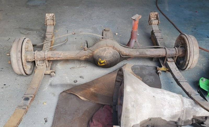

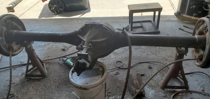

I'm limited on space and by now I needed some room to work. The rear end and trans were in the way so I got busy tearing down the rear end for the most part. I really just stripped it down and cleaned it up, then I repainted it and installed the new SS lines on it. At this point I decided to get new springs and ordered them from ESPO and added an inch so the rear doesn't look quite so droopy. Springs should be here this week. Once I reinstall the rear end I am going to go through the brakes and replace the wheel cylinders as well but I just didn't want to do all that with the rear literally perched on the jack stands.
Then I used my engine hoist to pick the assembly up and move it between the cars on the other side of the garage and out of my way for the time being until those springs show. I will not be using the old slapper bars and Cliff said he had saved the original shock mounts so he was able to dig those up and that solved that issue. I have everything ready to go to reinstall the rear once those springs come in.

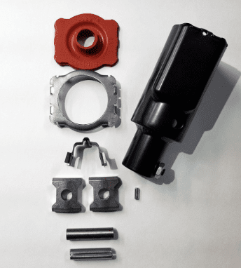

That's for the Borgeson unit so you don't have to cut the column? hmm. Do you have one on your car? I'm eager to hear how the OP likes his.
That's a part Bergman makes that allows you to use the borgeson box without cutting the column.. Lotta guys have used them with good results... Recently Kern Dog added one to his car.. That guy can't leave stuff alone... :lol:

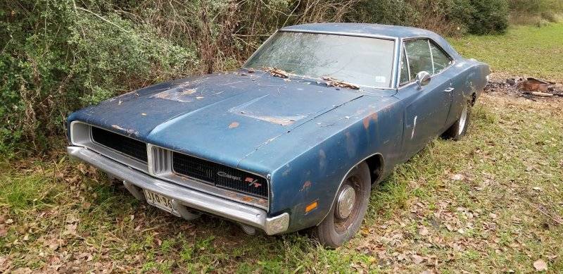

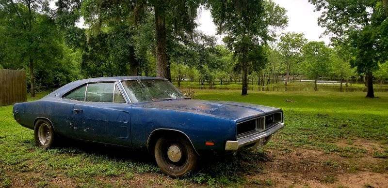

I bought this '69 Charger R/T at the end of last August and since then have been able to put together the entire history of the car and begin to get it back on the road. I figured you guys might like to see this. It is the only time I've been able to get the complete story of a car like this and I found it all very interesting, so I thought I'd share. If you're on facebook you may have seen me post about some of this in a couple of the groups there but if not, here goes....
The car was bought new just a stone's throw from where I live now and as it turns out, it has been within 20 miles of that now defunct dealership damn near every day of every year ever since.
Unfortunately, the original owner has passed away but I was able to use the title that I was given by the 2nd owner to track down the original owner's family. According to his wife, her husband worked at the Buick dealership that used to be across the street from the Dodge dealer. When he saw the new '69 Charger he went over and ordered his. He wanted the 440 and a bench seat but the R/T came with buckets so he ordered it with the "buddy seat" so it has no console and a column shift automatic. He wanted it that way so his wife could sit next to him. He also had to have A/C because... well.... Texas.... not to mention this was the everyday car for him, his wife, and little girl.
The original owners kept all the paperwork all these years including the original dealer invoice with the options he had requested and they had the original window sticker. They had even saved receipts from payments and registration through the years.

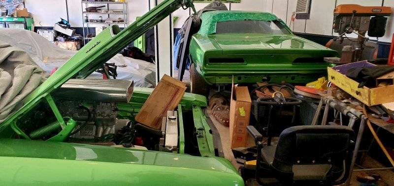

I've posted about that one before. That is our (Cliff and I) mutual friend's car. He bought it in 80 or 81 looking just like you see it there and years later he pulled the vinyl top off to begin restoring it and found some scraps of weird material. Then he decoded the fender tag to find out that it's 1 of the 28 Super Bee "Floral Top" cars. The top had been stripped and replaced with that black top you see there by the previous owner. The car has been sitting after having been repainted. He just doesn't take the time to finish it. With the help of another member on here we were able to locate the original floral top material and sent it off to be made into the top so it's ready to go.
I have put together an AAR Cuda and a T/A Challenger for him, painted his 1 of 0 69 Super Bee convertible and countless numbers of his family's and customer's cars but he hasn't asked me to do that one. I think he's scared. He wants it to be his old car but it's so much more than what he thought it was back then... IDK.
Here it sits now... Waiting. A shame but I can only do so much.
