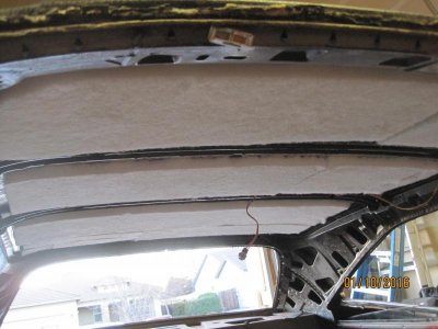

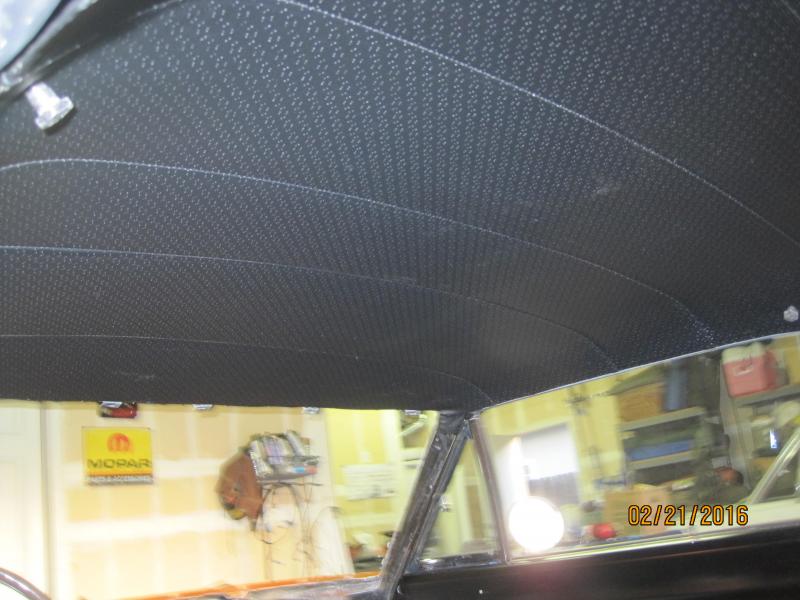

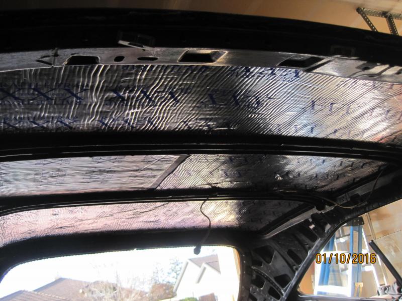

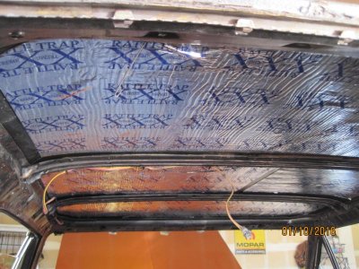

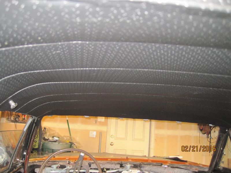

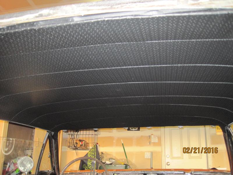

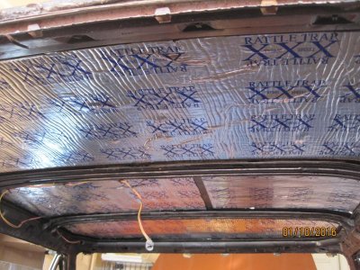

I did make some progress. The same guy who stitched up my seats came to the house and installed the headliner. It's the OEM black perforated. Only took him about 2 hours - amazing.

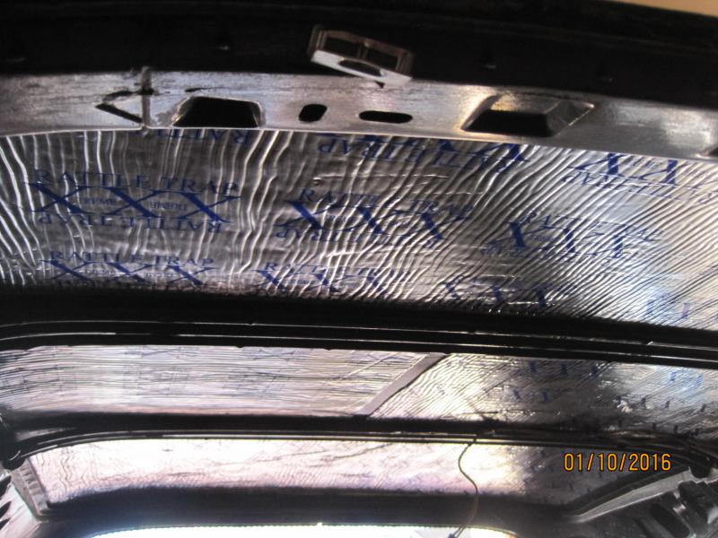

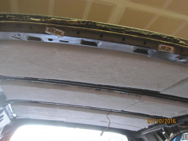

Started out with POR 15, then Fat Mat Rattle Trap, glued 1" batting on top, then headliner. Should be nice and quiet, and keep the interior cool in the summer.

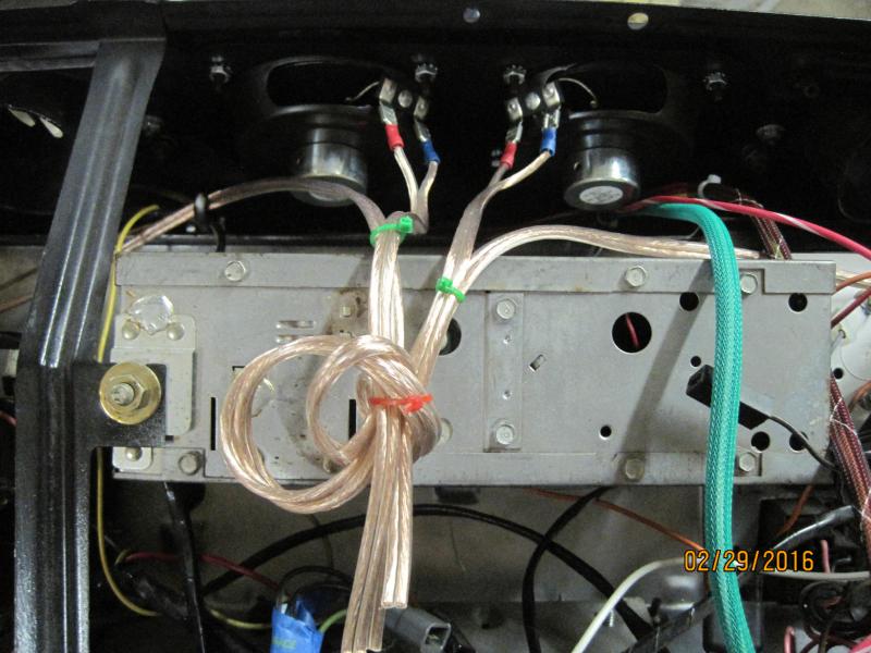

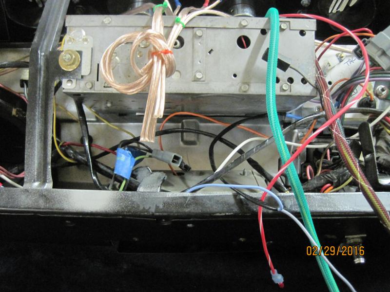

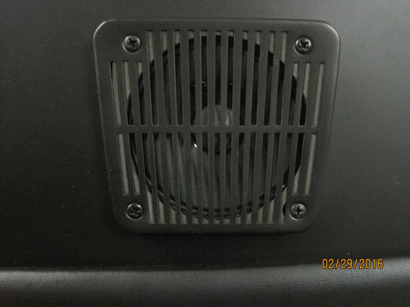

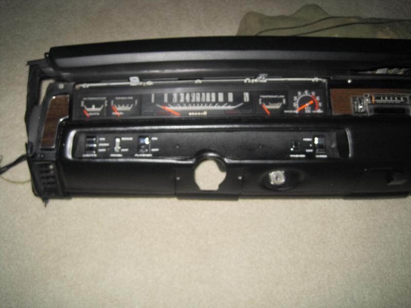

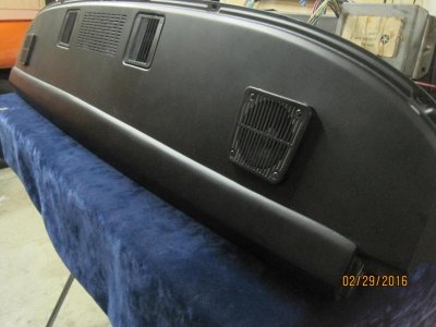

Working on the dash next. Got the new speakers in.
Pre-wired the speakers and zip tied them for now. I'm replacing the original AM/8 track player with a modern unit from RetroSound. They have recently released their Redondo line for early Mopars but the thumb wheel radios won't be ready until the end of March. Until then its just the sweet sound of the headers!

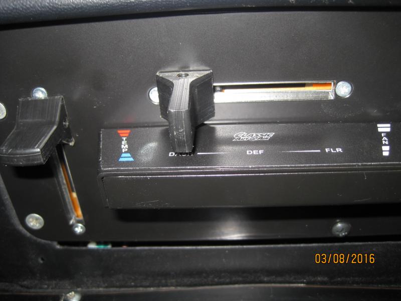

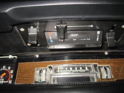

The braided lines are from the Classic Air DER controller. Notice the OEM fader knob underneath the dash.

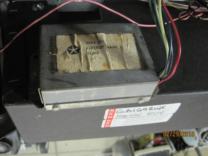

When I bought the car it didn't have a glove box, but the PO left a new one in the trunk, still in it's YO box. I took a quick peek inside, then closed it up and it's been sitting in the garage for the past two years waiting for this day. When I took the glove box out, sitting inside was the original Chrysler Cletron Mark I crossover box, part of the "premium" sound system with fader control. It doesn't work with modern electronics but I installed it in it's original place on top of the glove box, for the next guy who takes apart the dash.
Check the clearance for the heater control cables to the center speakers. The magnets on your speakers look smaller than mine, so I don't think it will be an issue?
The magnets on the new center speakers are much smaller than the OEM 4 x 10. That being said, the control cables will be zip tied out of the way. The vent ducting will also have to be carefully routed. I have to give props to Classic Air, their Perfect Fit series is an accurate term.

Great work and progress. The only problem with your headliner installation was that your guy wasn't able to put the wrinkles in the back that I expertly put in mine! :grin:
All the time spent dressing the wiring will pay off later - nice work!

It's amazing how the pros put in headliner. One man, two hours, no wrinkles. For whatever reason, wiring intimidates me. But then once I start digging in it seems to flow. I've lost precious time with "paralysis by analysis".
Beautiful work, love the descriptive pictures that self explain.
A picture is worth a thousand words, which is about 990 more than I could use to explain what Iv'e done.

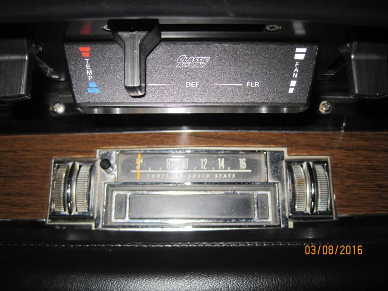

I didn't know it had a classic air system. I'd like to see more pictures of the classic air controls. Was this an original A/C car?
I used the vintage air system, but don't care for their hose routing.

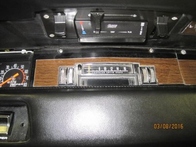

Here's a few close ups of the CA DER controller. It's literally a bolt in replacement. The Coronet was non-A/C originally. The CA kit came with a template to drill the additional holes in the firewall to install their system.
Looks familiar!
My system worked great on our cross country drive. I used the A/C on brutally hot days and the heat and defrosters when it was 28 degrees and we stayed at the Grand Tetons. Only issue is distribution of A/C to the back seat is tough, but that is seldom a problem since we seldom carry passengers.

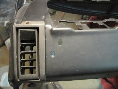

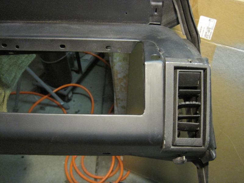

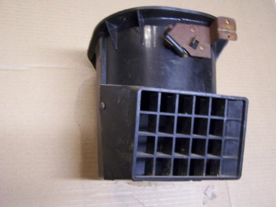

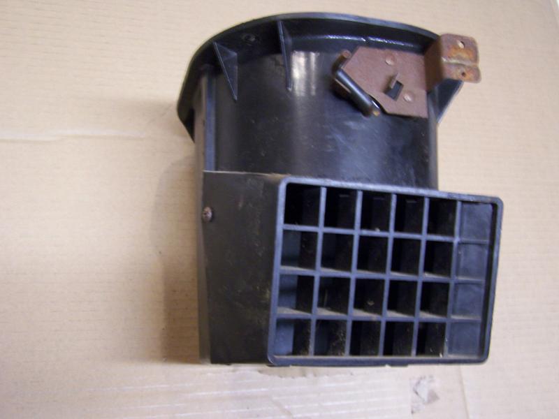

Can you still install the old vents on both sides? My car doesn't have them but it looks like they would fit.
Looks great.
I installed OEM vents in the sides. Bought used ones off of a FBBO member.
Check out post #93 for more detail.
CornetDuster, I'm doing the same thing, installing the OEM side vents. Did you put any type of vent in the middle. I have the middle vent but I don't have a AC dash pad. I'd really love to put it in. Does anyone make a repo AC dashpad? Thanks
