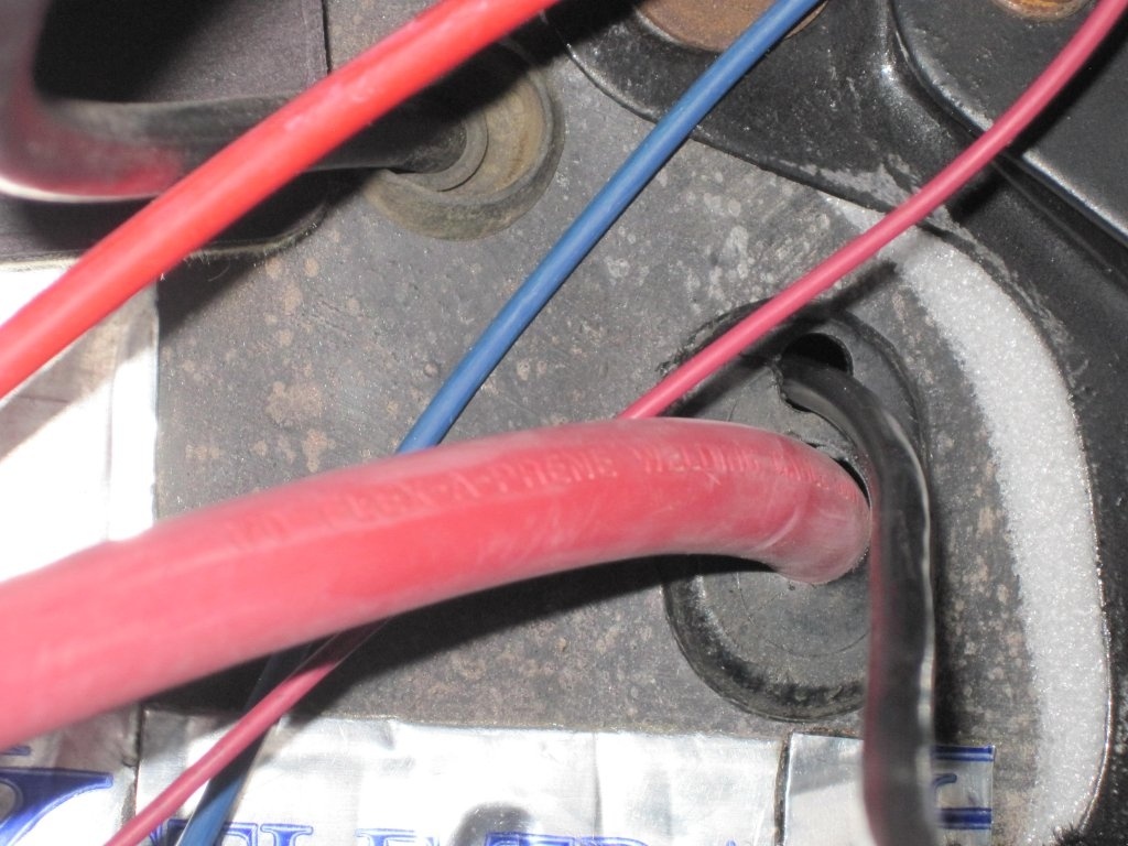

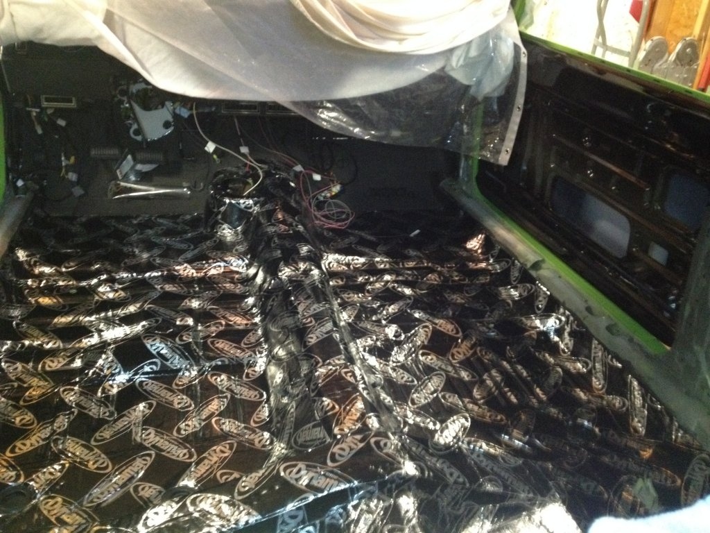

Started pre-wiring for the FiTech EFI system. This is the interior side of the grommeted hole for what would have been the manual trans linkage. Repurposed the grommet for both the 1/0 gauge going back to the trunk and for the EFI hand-held wiring.

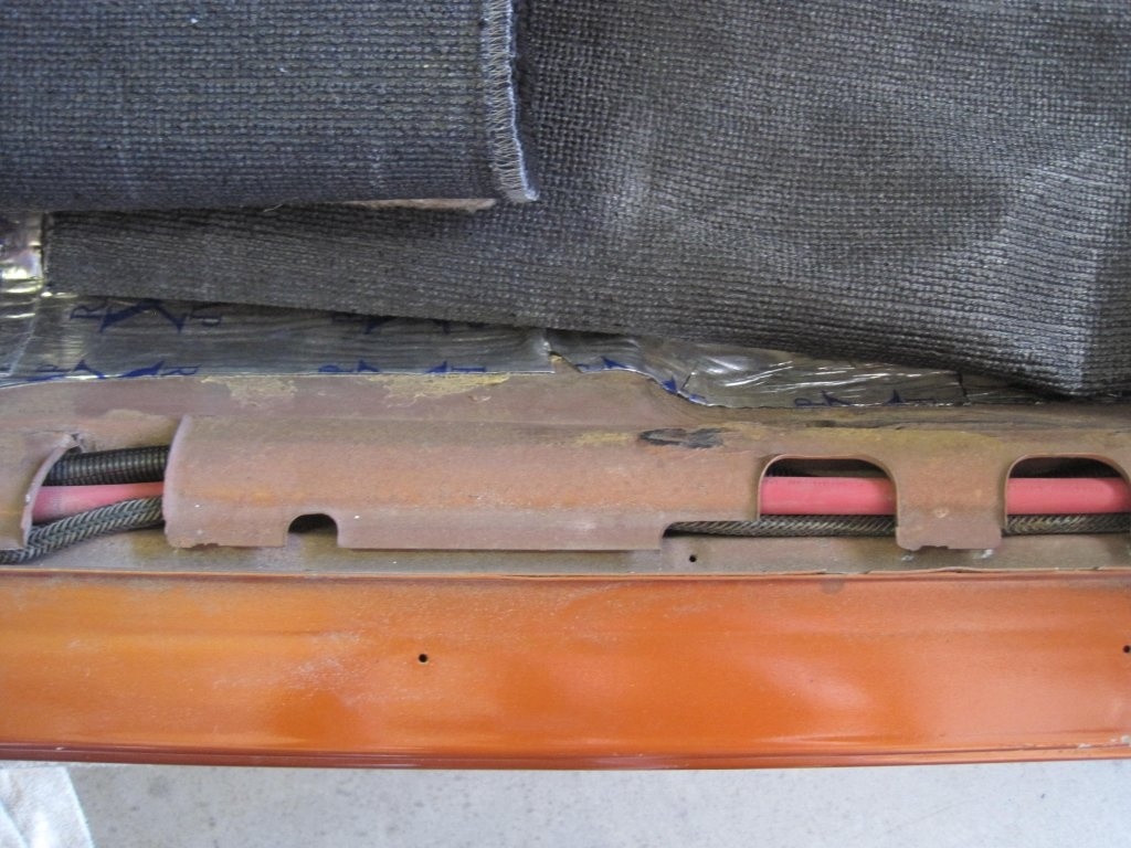

Ran all the wiring back to the trunk through the driver's side channel.
