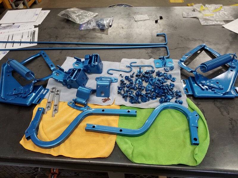

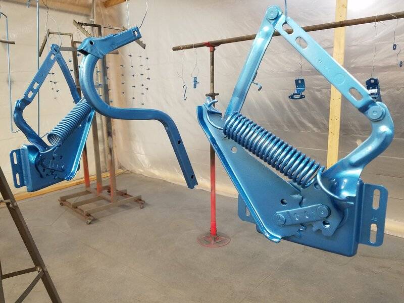

Just finished up a batch of small parts. Every single piece of the car will get blasted, epoxied, and painted. Time consuming, but everything will be nice and shiny.
20210228_115633.jpg 20210228_115653.jpg 20210228_115804.jpg 20210314_102419.jpg
Are you using single stage for the small stuff or 2 stage for everything? BTW aren't bolts fun to paint!

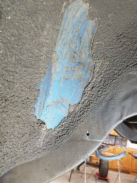

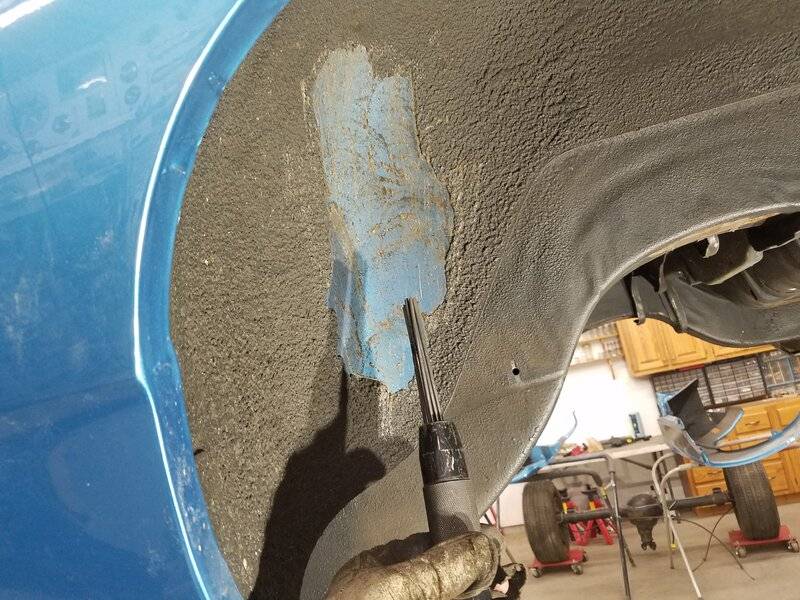

Needle scaler to remove the factory undercoating. This always seems to work ok, the thicker the undercoating, the easier it comes off.
Looks to me like the bodyshop sprayed POR15 or something like that on the entire underside. I've been scraping it off the best I can for the past couple of weeks, an hour or 2 at a time. This is some miserable stuff to get off where it bonded, but comes off in sheets in other areas. I will say that after dealing with this that I would never recommend anybody use this product on one of our old cars. I surely don't remember the bottom of the car looking this bad 15 years ago. So glad I decided to rip this car apart and start over.

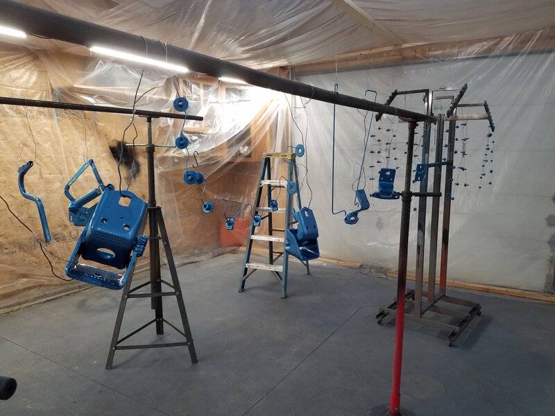

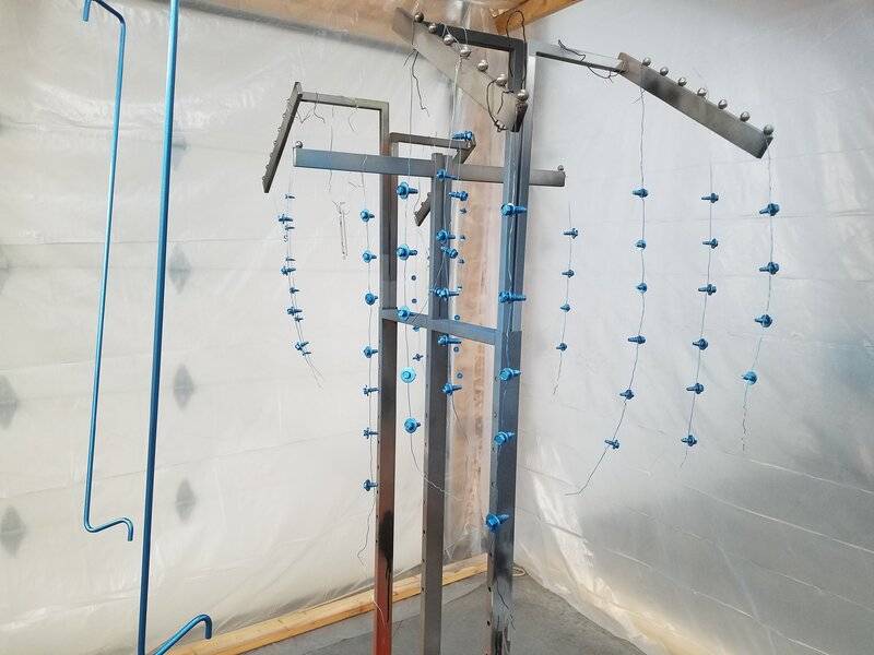

Everything that is blue is the same PPG Deltron base/clear that will be on the car. The black and grey pieces I am shooting with either black or grey epoxy and then a single stage paint. And no, painting bolts, nuts, washers, and retainers really blows. But I hate rust and this is the only way to rid the car of that.

That's quite the undercoating removal torch. First I have heard of that one, but imagine it would work just fine. This car really didn't have much factory undercoat, But products sprayed on afterwards is the big problem. I'm about to the point of saying screw it and calling the sand blast guy in. My arms are so sore from scraping.....

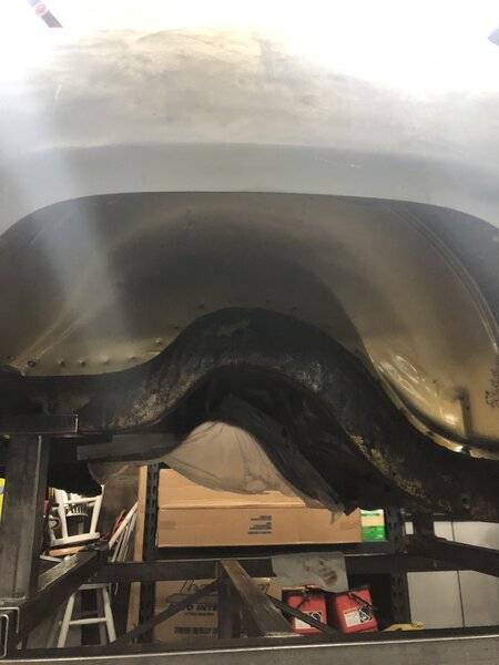

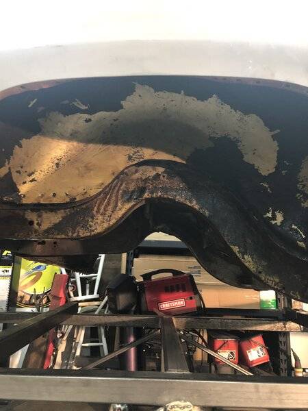

Nice progress! I used GooGone Automotive on my undercoating. I spayed it on heavy, covered it with plastic overnight. I then sprayed another heavy coat on the next day and covered it back up and let it sit overnight again. The next day I peeled it off with a plastic scraper. It came off with hardly any effort.
I thought the same thing. It took the seam sealer off the window channels too.
