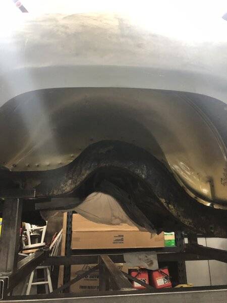

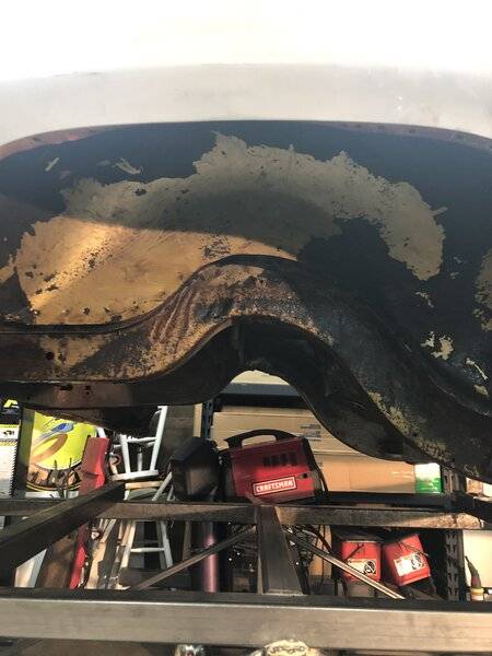

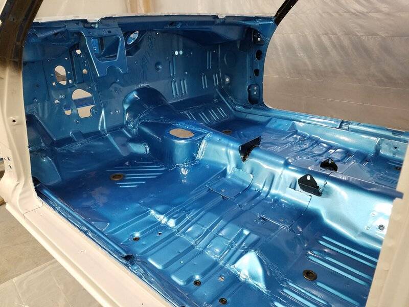

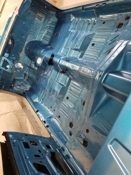

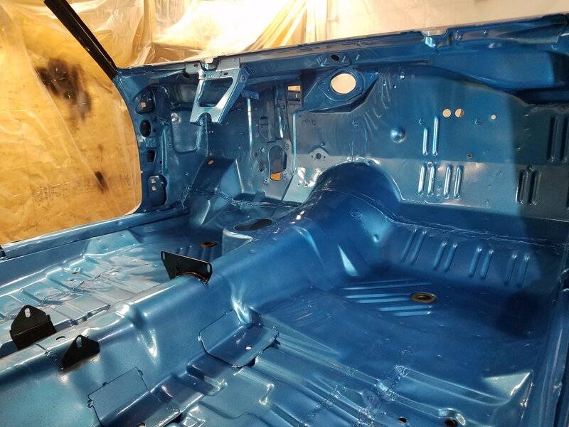

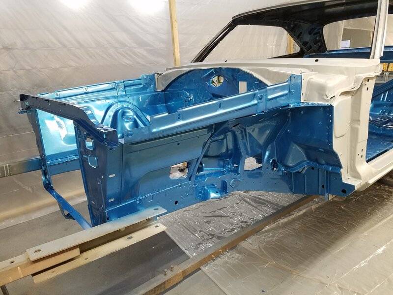

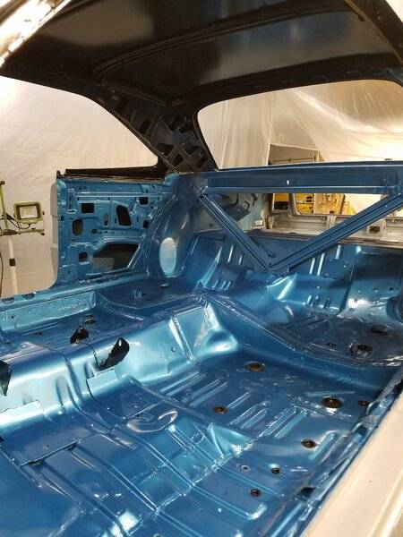

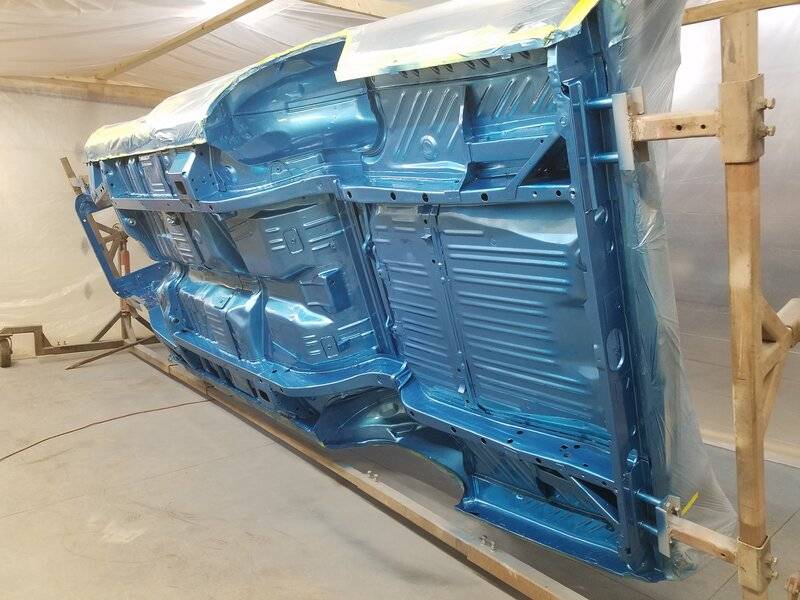

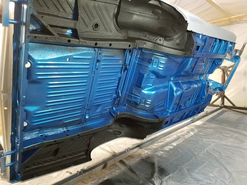

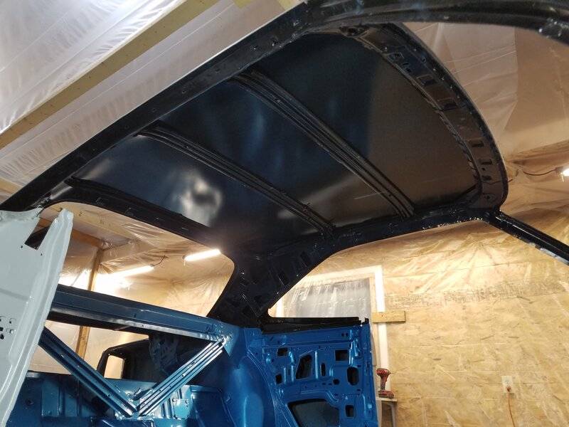

That stuff leaves a very oily residue. Any problems getting that cleaned off so primer would stick?Nice progress! I used GooGone Automotive on my undercoating. I spayed it on heavy, covered it with plastic overnight. I then sprayed another heavy coat on the next day and covered it back up and let it sit overnight again. The next day I peeled it off with a plastic scraper. It came off with hardly any effort.
