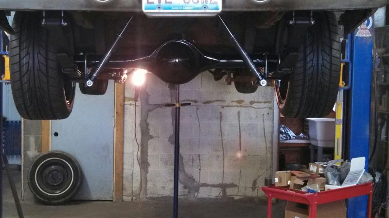

Could you share a shot of the rear wheel on the RR? If i'm correct, do you have a lot of room between the tire and the wheel housing/fender? Or is it optical?
this is only i shot of it so far, but after installing you could fit a 10" with a 285 size tire. mine is a 9.5" wide with a 275 with 5.75" backspacing. when i smoke these tires off i might go with a 285 next time. :beavisnbutthead:

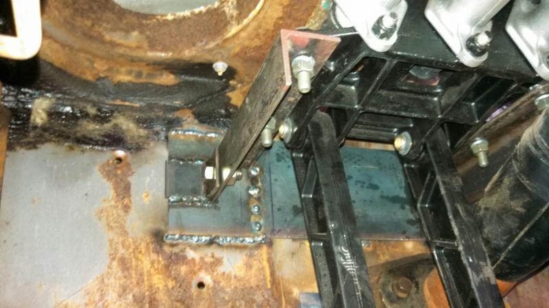

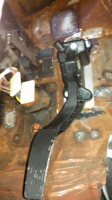

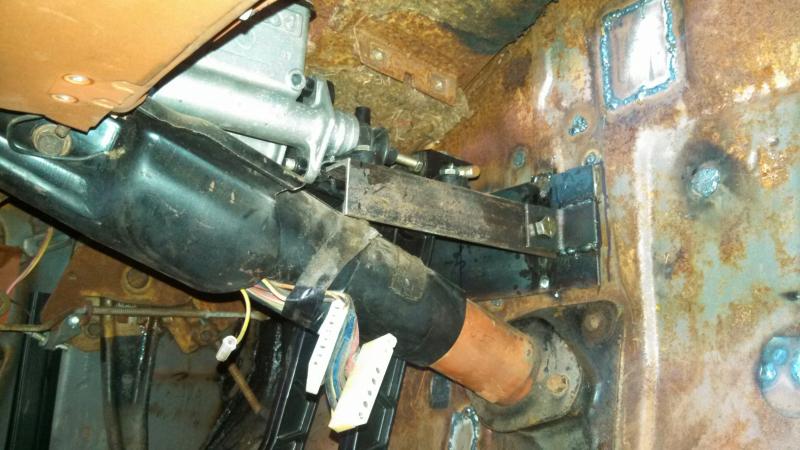

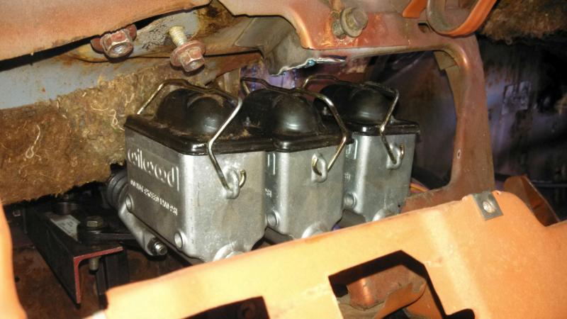

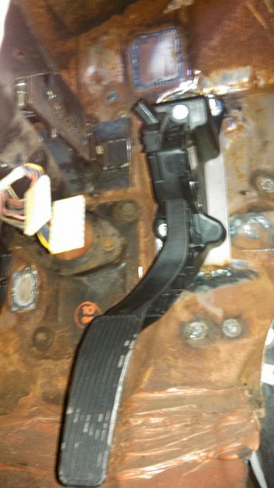

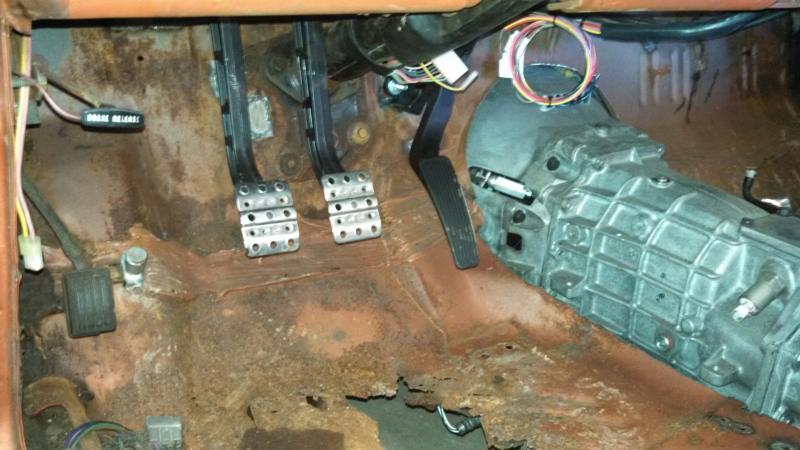

got down to the shop today and fab up the brackets for the clutch and brake and the go fast pedal. this custom fab work dosent go fast. my buddy did all the welding. we came up with this bracket style and plug welded it so there is no bolts coming through the fire wall. i think it came out pretty good. as goon would say those pedals are fer racing...lol. the master cylinders that are under dash by i am going to have my buddy build this custom dash. if turns out the way we want it. you will be able to get to the master cylinders no problem. also got the motor all wired up and routed through the fire wall. all the wires are tucked and hidden for the most part. got a whole brand new wire harness for the whole car also, so it will be all new. got me some LED tail lights and gonna order the LED parking lights. thats all for now. will keep ya posted. usarr :beavisnbutthead:

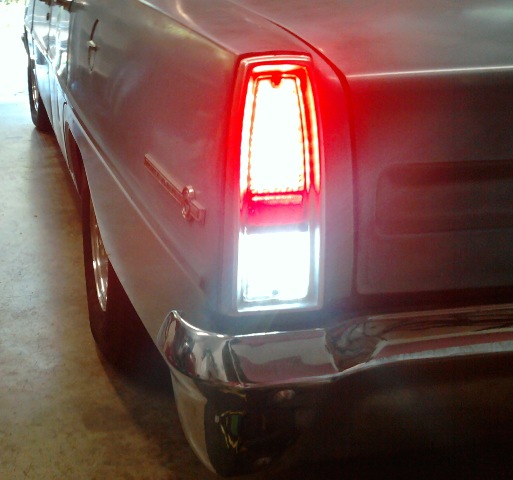

Ahhhhhhhhhhhhhh, look at that big honk'n 6 speed......................I'm so jealous. Did you get LED bulbs? The reason I ask is because I was reading up on lighting and they advise not to use LED bulbs in the old tail light assemblies. Reason being is because your old bulbs projected light almost 360 degrees lighting up the whole assembly where the LED's project straight out and only light the area directly in front of them resulting in a smaller less visible area being lit up. Just sharing what I've read. Your car is going to be one wicked, fun beast to drive.
LED Lights . . .
That's a very good point too 747 Mopar . . . but, it would depend on the "type" of LED lights that you get too . . .

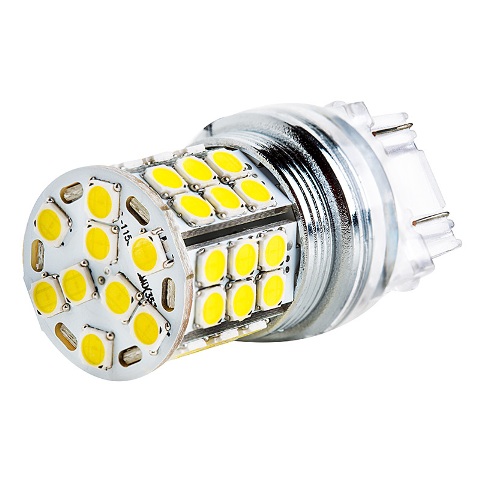

LED can be very directional - as is the case with ones like these . . .

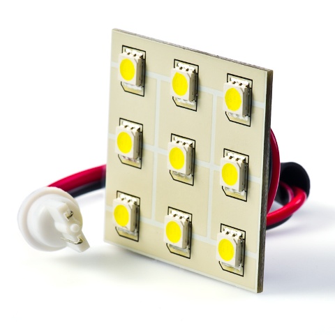

Or they can be "mostly" directional, like these, but shed some light to the sides ( notice the shape difference from above )
Or they can be set up, like these, to assist with shedding light in many directions . . .

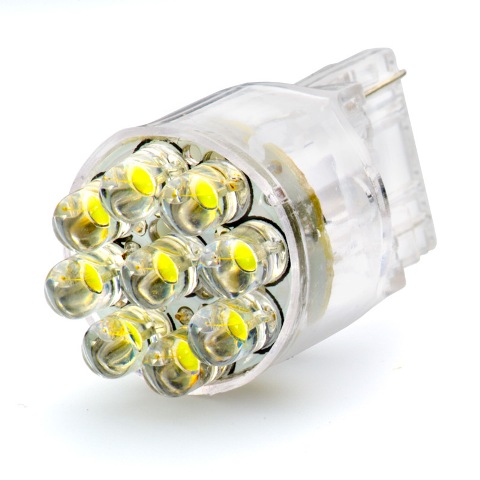

Here's a pic of some LEDs that I have in the ShoeBox . . . No doubt that you can tell that I'm stopping . . . ( or backing up )
NOTE: If you do get LED bulbs for your car, then you may find out that your flashers no longer work - that's because the LED draw far less amps and don't allow the element in the flasher to heat up and disconnect.
SOLUTION: Buy an electronic flasher unit, they are made for LED bulbs and work with the LEDs and don't depend on amp draw and heat to cause the flash.
ALSO: Electronic flashers are directional, they must be hooked up properly to work. When I got mine, it did not work, called the company and they wanted to sell me $5.00 polarity swapping plug - All I did was pull the pins from the plug, and reverse them - everything worked great !
