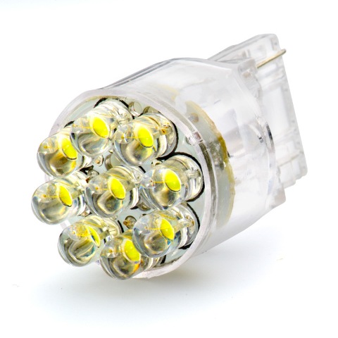

That's a very good point too 747 Mopar . . . but, it would depend on the "type" of LED lights that you get too . . .
LED can be very directional - as is the case with ones like these . . .

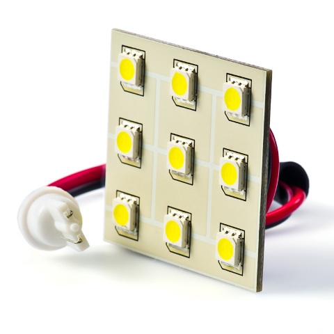

Or they can be "mostly" directional, like these, but shed some light to the sides ( notice the shape difference from above )

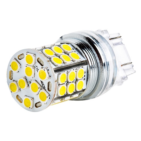

Or they can be set up, like these, to assist with shedding light in many directions . . .

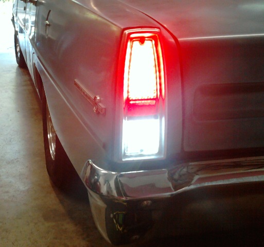

Here's a pic of some LEDs that I have in the ShoeBox . . . No doubt that you can tell that I'm stopping . . . ( or backing up )
NOTE: If you do get LED bulbs for your car, then you may find out that your flashers no longer work - that's because the LED draw far less amps and don't allow the element in the flasher to heat up and disconnect.
SOLUTION: Buy an electronic flasher unit, they are made for LED bulbs and work with the LEDs and don't depend on amp draw and heat to cause the flash.
ALSO: Electronic flashers are directional, they must be hooked up properly to work. When I got mine, it did not work, called the company and they wanted to sell me $5.00 polarity swapping plug - All I did was pull the pins from the plug, and reverse them - everything worked great !

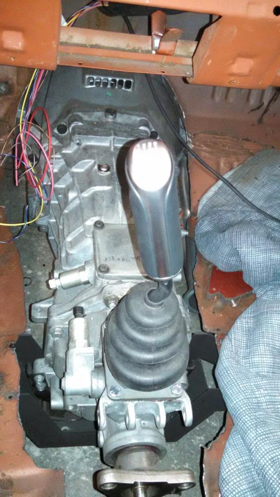

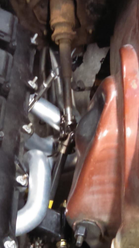

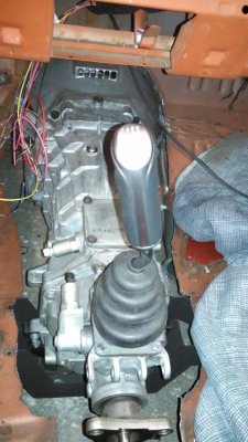

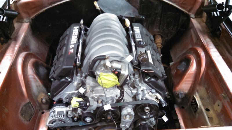

mopar theropy 101, got back to the evil scowl. got the whole motor wired up and computer mounted, starting to get the new car wiring harness all routed thru the car. got the aluminum radiator mocked up and got to get the brackets welded on then can mount that into position. got the new gen pistol grip in with my new hurst 40% redution short throw shifter. this thing is badass. shifts smooth as hell.got the steering linkage hooked up and got the lokar dipstick in, perfect fit. my big hold up so far is the driveshaft. still have to find someone that can make this work for me. :beavisnbutthead:

Hell yeah! Great progress USA, I'm jealous of all you 3-pedal guys lol. glad you got the daily dose of mopar therapy in :icon_thumleft: hope you're doing well brother!
Sweet, love the taillights and the motor and tranny look great in there. Can't wait to see it come together

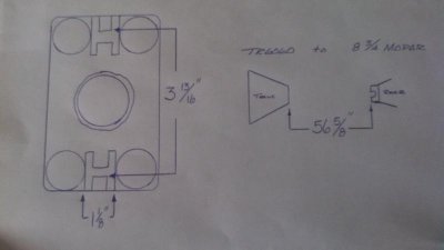

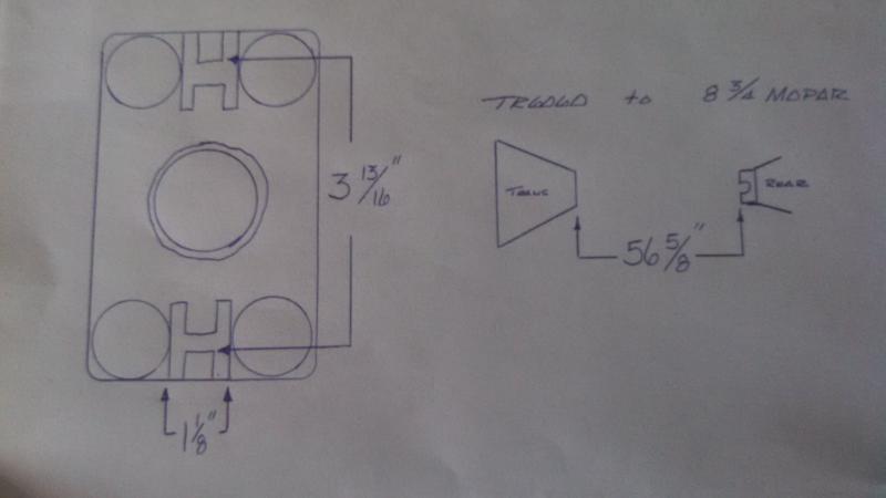

yes, i got the drive shaft problems over. the DRIVE SHAFT SHOP is going to build me a drive shaft. its a little pricey but all aluminum balanced at 9600rpm and weighing in at less than 40 lbs. will get the 6.1 reving even quicker..lol

So wiring it up....pretty straight forward or kind of a pain in the rear? Keep up the good work!
we drilled a hole right behind the motor to hide it and ran all the connections we needed under the intake and had everything plugged in about 15 min. then mounted the computer on pass side and plugged those 3 plugs in. we still got to wire up gauges and the new car harness. im trying to run that thru the frame up front so you cant see nothing. the harness i got thru modern muscle but it was made by hotwire. it was $1k but had the motor wired up in less than an hour, well worth the money in my book. i was impressed how easy and every wire is detailed an labeled, it cant get any easier than this. im gonna get drive shaft ordered the first of next week, hopefully get brake lines and start welded the ol girl back together.

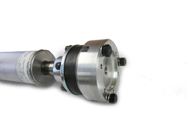

hot dam this chemo stuff is working, dr. called me and told me it was shrinking. needless to say i kinda partied it up that night. im pretty happy, now i just got to get this car running. here is a pic of the driveshaft being built. 4 week build time. 3.5 inch aluminum bench tested at 9600rpm. heading down tomorrow to get some work done on her.

I think once you're done, we should street test that 9,600rpm limit in high gear!!
