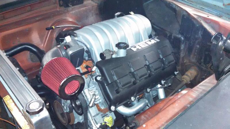

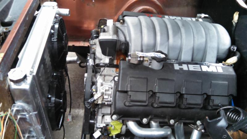

we got all the wiring in an ran just have to make connections and got all the brake lines done but one. got the radiator installed. hopefully next week we get wrap that up and get fuel tank an fuel lines ran. its getting close. then its time for some tire frying. :beavisnbutthead:

SWEET ! ! !
And all I've got it the "baby" 5.7L Hemi . . . man does that 6.1L look REALLY NICE in there USARR ! ! !
X2, Unlike most modern motors they just look cool as he'll. Great to hear your making so much progress, looks like you'll be up and running before you know it.

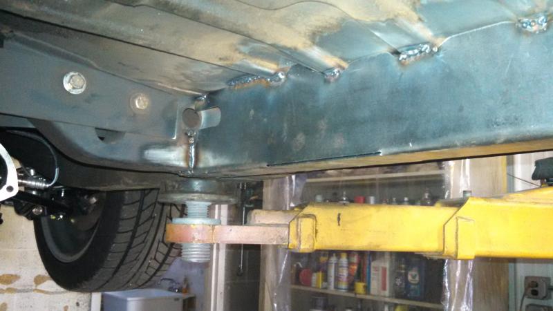

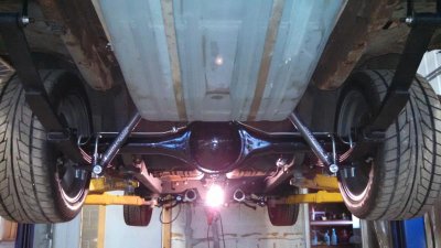

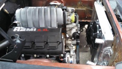

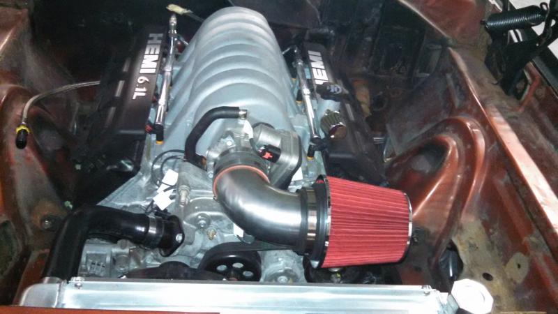

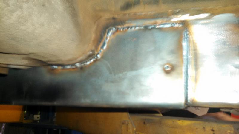

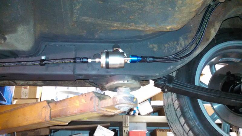

oh baby its getting close now. we got the sub-frame connectors installed, finished the radiator, got the cold air intake on, finished up the brake lines, got all the fuel lines installed with the regulator, and gas tank in. i can not wait to get this thing going. :beavisnbutthead:

Looks great USA, getting close.

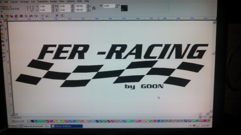

whatta ya think about these. they should bump your flywheel HP about 50hp.....FER RACING!!!!!!!!:beavisnbutthead:

LMAO!!! LOVE IT!!!! that's some serious mental horsepower right thurrrrr!!
Edit.. Maybe one change if I would be so bold... since the way I always spell it here is FER RACIN'
Thats some serious progress you got there, love the look of that rear-end sitting in there with it and the springs all painted up! Keep it up and you'll soon be racing down the high way man!!
