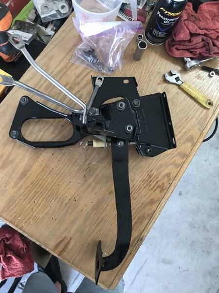

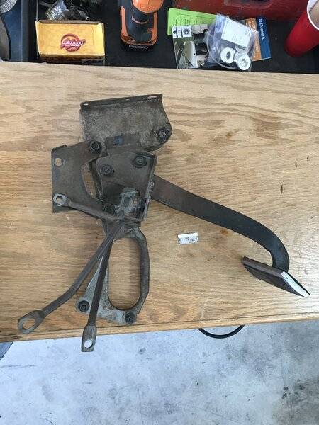

Rebuilding the Brake Pedal.
Mercy, you do nice work! :thumbsup:

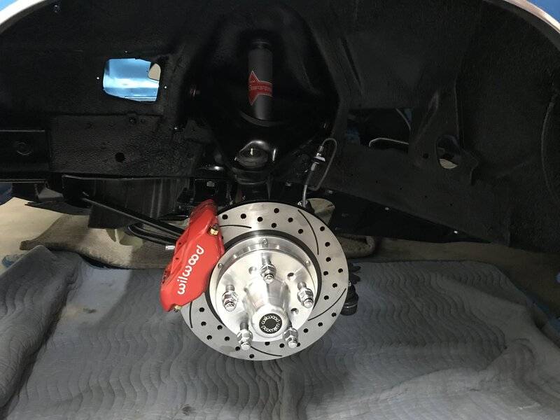

Thank you for the compliment!!
I wasn’t sure about the Willwood brakes at first. Once I completed the install, I’m glad I did!!
Looks clean.
KYB shocks though?
With your attention to detail, I'm sure you'll find them to be below your standards.
With your thread being in the "Resto-Mods and Pro Touring forum", the theme leans toward handling and improved performance over stock.
KYBs are a substandard shock for a performance build. If you have stock leafs and torsion bars, a small front sway bar and skinny tires, the KYBs might be okay. They are a poor choice for a car with stiffer suspension.
The KYBs that are painted white are the worst. They are a digressive design where the further they travel, the softer they react. This is the opposite of a "progressive" design where they are soft at first but firm up as they travel further.
This makes them harsh on rough roads and undesirable for performance builds.
It looks like you're doing a nice, clean build. The KYBs are the Harbor Freight of shocks. Bilstein, Koni. Fox, Viking, even something as mild as a Monroe would be a better choice.
Good luck.

thank you for your insight!
Just about done with the brakes…. Need to plumb the calipers and bleed the system.

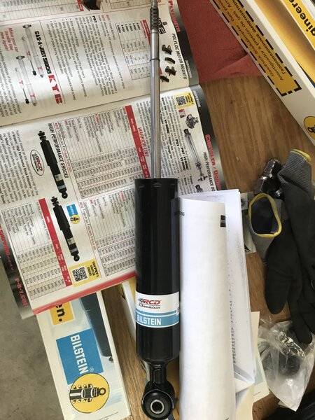

I received the Bilstein shocks today. The front shocks did not come with Dust covers…. I checked PST catalog, the catalog doesn’t have catalog number for the front dust cover. The rear shocks have covers. So did you just Mount the fronts with no covers?
Hit an off road shop and see if you can get some boots for them.
I received the Bilstein shocks today. The front shocks did not come with Dust covers…. I checked PST catalog, the catalog doesn’t have catalog number for the front dust cover. The rear shocks have covers. So did you just Mount the fronts with no covers?View attachment 1276841
Seems odd to me as well, but Bilstein claims they are not needed. I have 3 sets of their shocks and the fronts look just like yours.

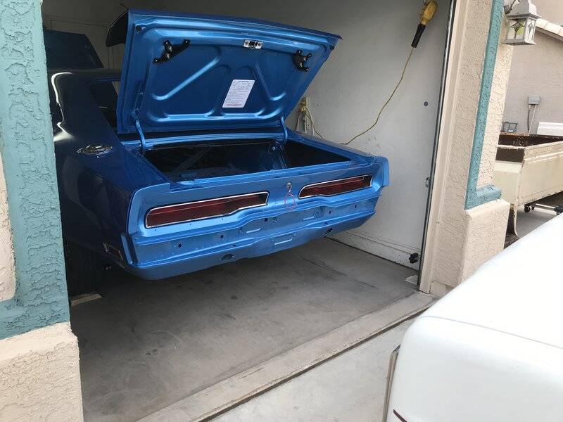

Are you doing the matte black on the taillight panel?
No…. I have the Tail Light Trim panel with Charger 500 Emblem to install. I need to buff it out and touch up the black trim before I install it.
