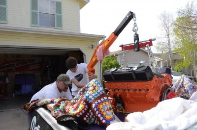

Engine bay is starting to get crowded finally!

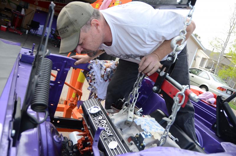

Thanks to my grandson for all of the help! We finally have the engine where it belongs. Ahhhhh, it feels good.
Nice progress, I hope to be doing that same thing is a month or so.
You didn't tell your wife what you needed those blankets for did you? :hello2:

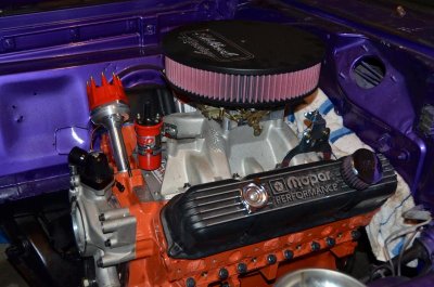

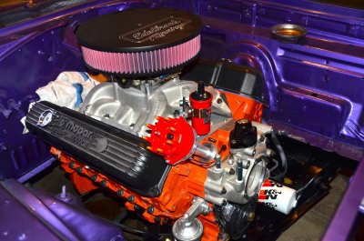

You would think that after 20 years of working aircraft structures for various airlines that I would be able to measure. Nope. Running into hood clearance issues with Performer RPM, carb and air cleaner. Anyone have a free 1970 Coronet hood they would like to give me? Not cutting my purple Ramcharger, that much I know. What a wonderful problem to have though! My engine is in, and now I am worrying about closing the hood! It is so cool. Like 14 years of waiting to get to this point cool. And THAT is cool...

These pics were last night. As somebody mentioned, who needs a hood anyway? Maybe I will go with a fiberglass lift off like Freiburger's Bee. That big six pack hood looks pretty hot.

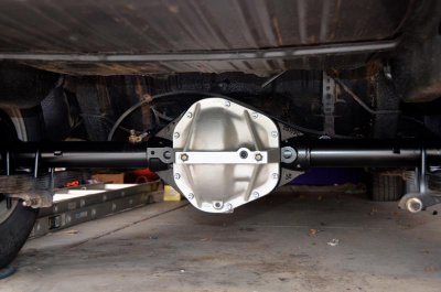

Got Dana looking pretty good in my opinion. As I mentioned before, internals were amazingly good. Hope I keep lucking out with the car. If it is truly luck. But I kind of feel it is more than luck. Putting engine in with Grandson was epic, and wife took pics all day. And I think she forgot about cancer for a few hours;. And that is incredible! :hello2:

Would a drop base air cleaner get you where you need to be as far as clearance? The guys with the Gen II Chargers know all to well about hood clearance issues. Maybe one of them will pipe in. I have to run a drop base on my air cleaner to fit the 512 under the stock type hood on my bird.

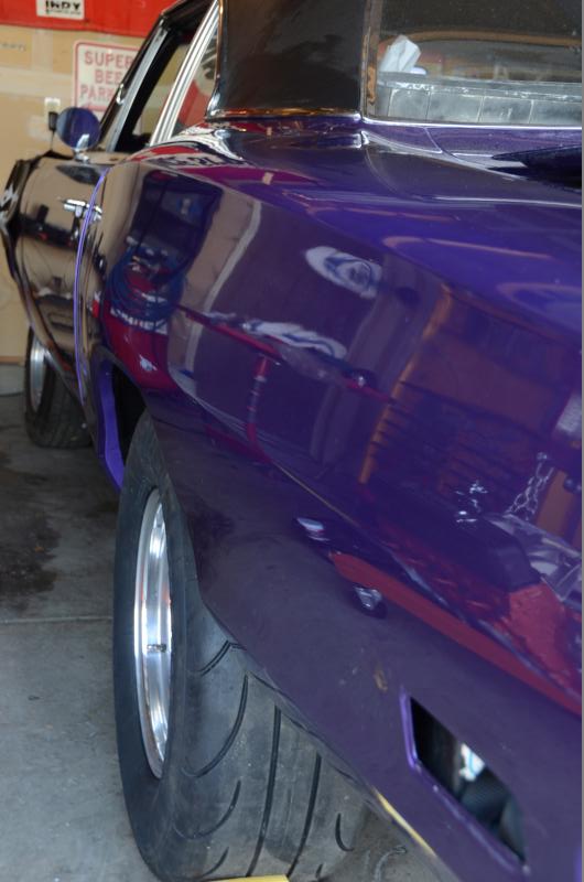

Pretty pictures indeed. That purple turned out just the right shade, I've seen some that were too silvery or too blue. Everything looks great...
Yeah, that Edelbrock air cleaner doesn't look like it is helping you out at all. I got the best hood clearance using a 1.25 drop base, K&N Extreme 2 5/16 element, and a K&N Extreme filtered top.
You are right about a drop base air cleaner. I tried fitting the stock ramcharger assembly with the stock air filter and lid. RPM manifold just a little too tall. So for now I took hood hinges off, and when I have the money I'm buying a fiberglass hood with a scoop. It'll never see rain(hopefully) so I will go hoodless for a short time. I do like that black hood Dave Freiburger has on his Hemi Bee. Probably go with that.
