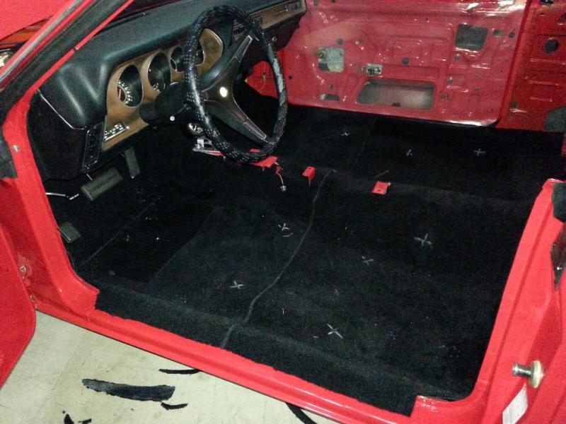

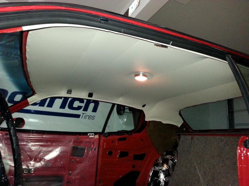

Got the headliner and carpet in today. Had a local guy that was experienced and very reasonable do the head liner, so I didn't screw it up, he did a very nice job, only took him about 1.5 hours to complete. Anyway, I hopefully can get the rest of the interior in this weekend!!!!
Carpet and headliner look good. I see you marked an "X" for where the seats and seatbelts bolt in. Good idea, I would have never thought of that but I am now. Thanks.
Yes, just use a piece of chalk that way it comes off with the vacuum! Or just rub your hand across it and its gone!

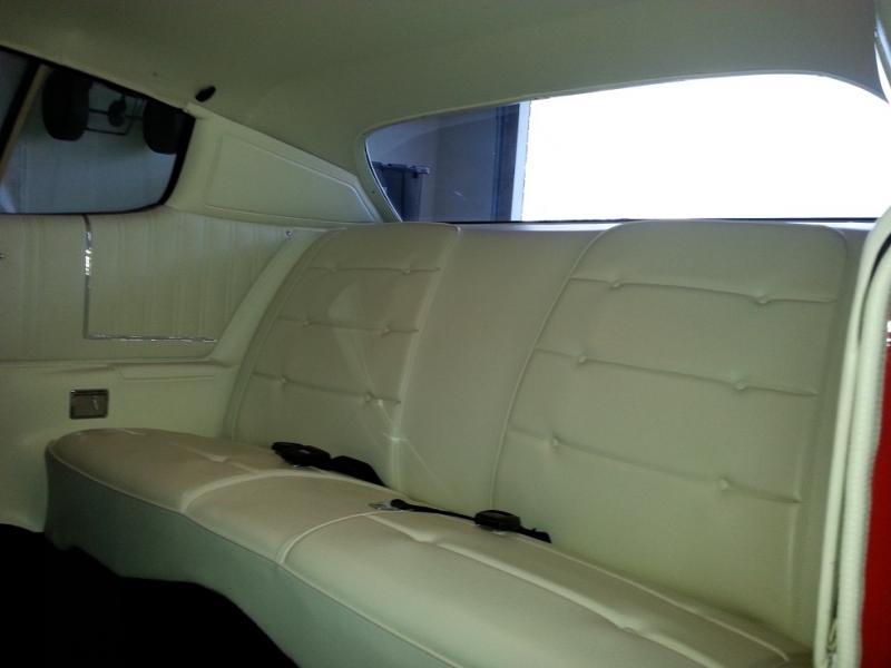

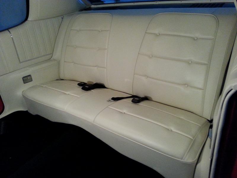

Got the rear interior in today. Tried to get the plastic panels painted to match the upholstered ones, but you can see the camera emphasizes the slight difference. Its not so noticeable in person or in sunlight. Even the two pictures below are different. I'm guessing they were not exact from the factory, but I don't have a frame of reference for that. Anyway, here is how its looking.
This is a good representation of what it looks like in person.
This one shows the difference really well between the panels.

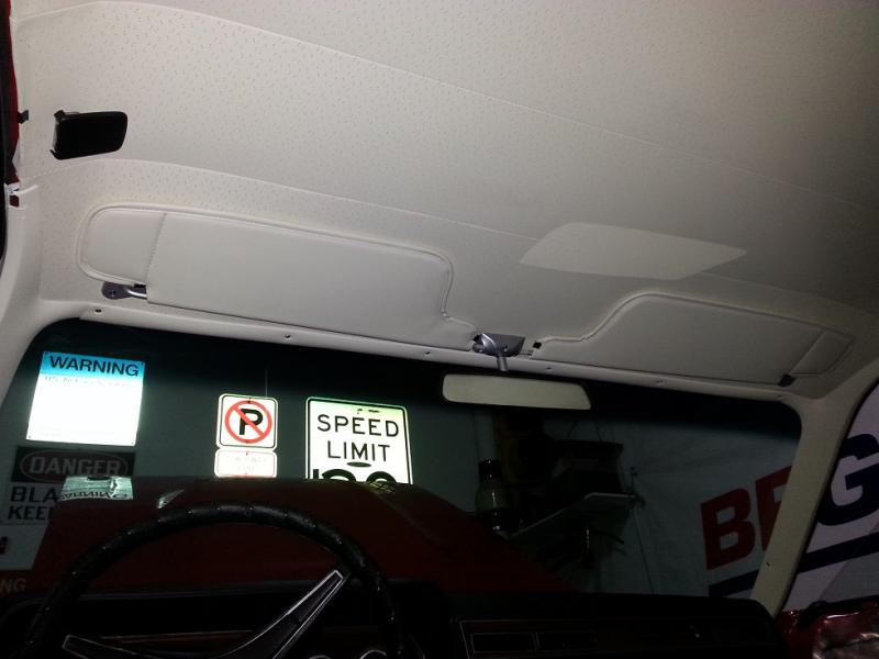

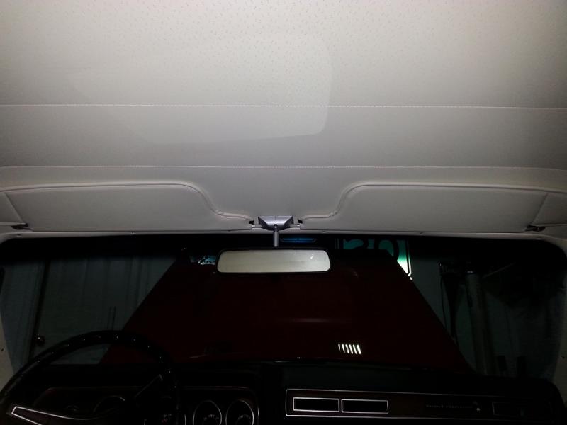

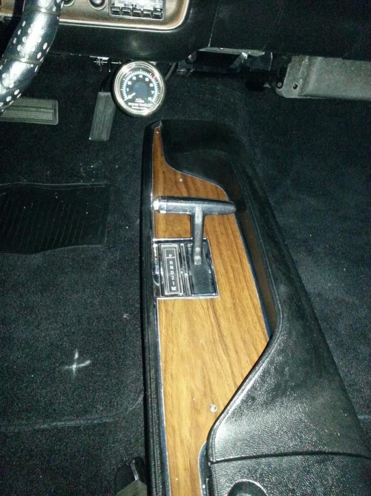

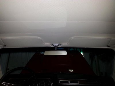

What better to do on a cold snowy day then sit in the back seat of the RR and admire the interior, well, at least what has been installed. Got the a-pillars, windshield trim, rearview mirror and sun visors installed along with the center console. The mirror and console are original to the car, and even though they show a bit of wear, no sense in replacing them so I went with the originals. Quite happy with the color of the visors and matching the headliner as well as the trim came out pretty good. Wanted to do the door panels, but the lowers don't fit worth a damn, from Accuform, and there is nothing accurate about them. The drivers side sits about 3/8" too far forward and the passenger side sits about 1/2 inch too low and there is now way to adjust them since the panel clip slots are glued in place. So I am looking for a good set of originals to use.
Anyway, here are some photos.

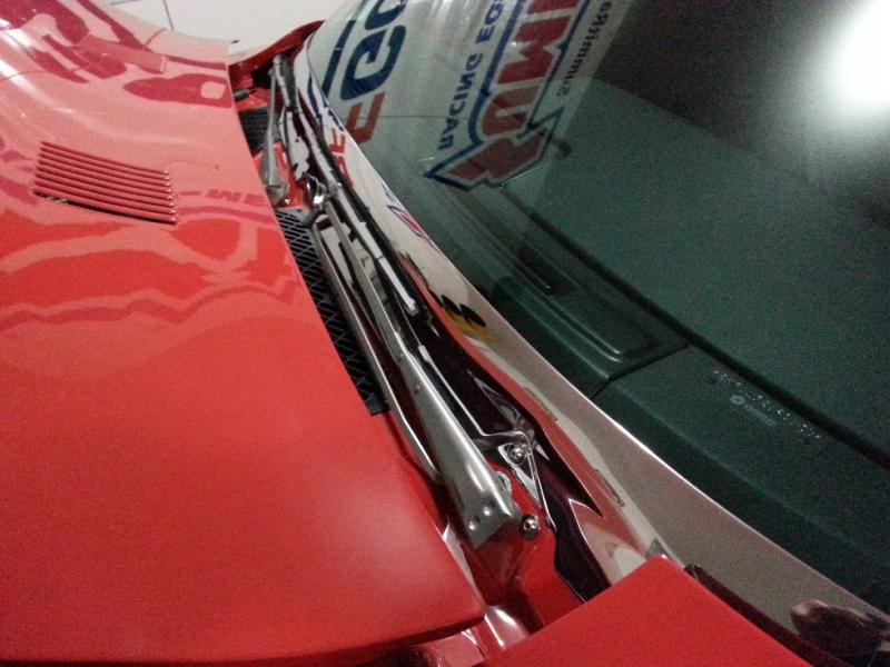

Finally done with this pesky piece of windshield trim, the wide one on the bottom. It took for ever, and if I have never have to sand a polish a piece of trim like this again, it will be too soon! Its difficult and time consuming to do all the hand sanding and then the polishing on a bench grinder and get good results, so I cheated a little bit after I got it sanded and polished as much as I could, I had a local guy use his 4 horse power buffing machine with a 10 inch wheel to get some of the sanding and polishing marks out, then I did the final polish on it, then a buff with liquid scratch x and waxed it. Its not perfect, but I think it looks real good. Oh, and I tested the windshield wipers today also and its the first time since I bought the car in '83 that the wipers actually retract all the way down like they are supposed to! LOL

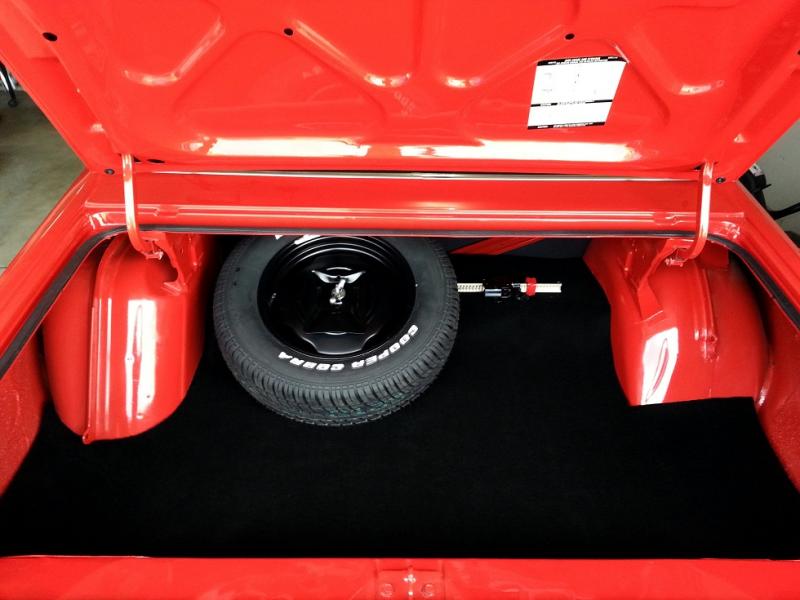

Finally a proper trunk...
Finished up the trunk today, finally looks proper again.
