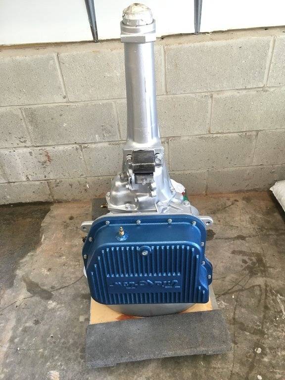

In the mean time, gussied up the ol 727 and add a fancy new pan from Trick Flow (made in the US!) and painted it body color. Even had a buddy weld in a bung for my temp sender.

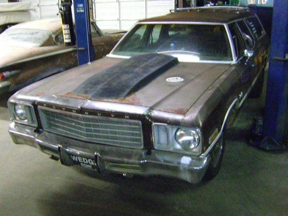

I'm using the old TRW 6-pack pistons, just below zero deck with milled (84cc) "902" casting heads (basically 346/452's) and my own home-brew Comp grind. It uses the XE285HL intake lobe, but I ran a bigger (251*/.545") exhaust lobe and spread the LSA to 112* for my huge-by-giant C-body wagon.
I'm using the old TRW 6-pack pistons, just below zero deck with milled (84cc) "902" casting heads (basically 346/452's) and my own home-brew Comp grind. It uses the XE285HL intake lobe, but I ran a bigger (251*/.545") exhaust lobe and spread the LSA to 112* for my huge-by-giant C-body wagon.View attachment 437026
Sounds pretty good to me:
