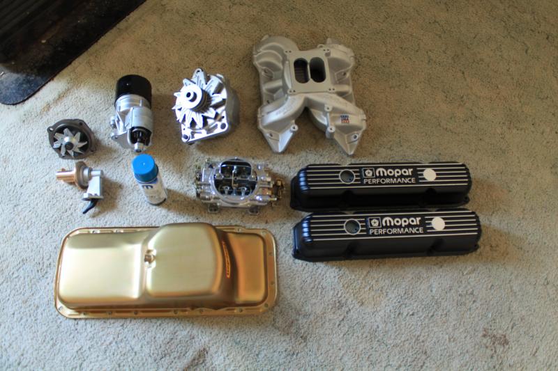

I have been collecting the parts that I need and starting to assemble them.
I got a standard 4 qt. oil pan for a 440 and decided to send it back and I ordered a deeper 7 qt. oil pan.
I had the alternator and starter rebuilt.

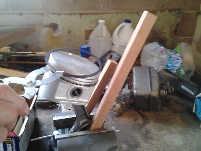

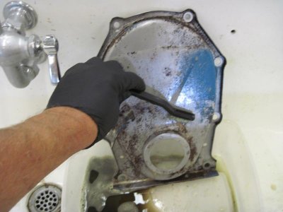

Cleaning engine parts and prepping them for paint.

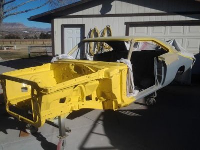

My car, ready and waiting for the fenders.

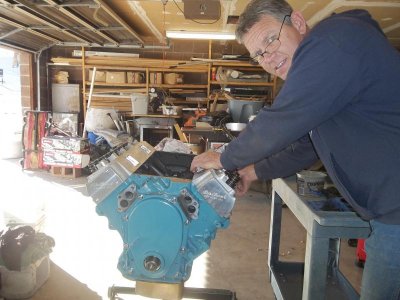

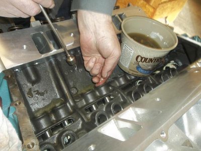

I am still learning what to do. Thanks to my friend Dale, a retired mechanic, he is showing me what to do so that I can get it put together. I also bought a rebuild instruction manual that has very good step by step instructions (by Don Taylor).

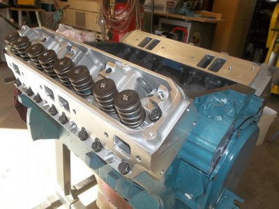

Edlebrock Performance heads.

ALWAYS good to have someone to help out, especially one who knows what there doing! I could use some of this kind of help someday and id like to say soon, but with me, its goin to be a spell! Enjoy the help bud! :)
Ron, I wish you lived closer. I would always be stoping by just to see your progress on your car so that I could learn from you. I like following your progress on FBBO to see how you are addressing each step of your restoration.

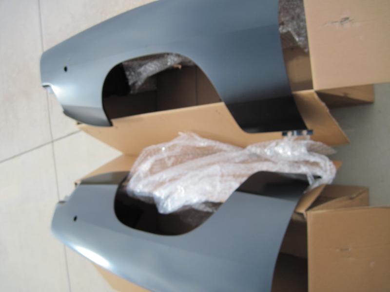

Christmas arrived today.:hello2: I am a happy boy. I should have contacted Jeff at 521 Restorations months ago. Now I can get moving on the charger again.
That Jeff is one big help for sure bud, It really does look like a good day to get that kind of stuff to build these car's, I don't know if i would make a good neighbor or not buddy, id like ya to build a GOOD car lol, I just do what has to be done, with mine its just make sure she's solid, worrying about looks that are on the floor or other places you don't even see later, if i know its solid and protected, (real important to me) im happy and it isint like were talking about the outside of the car.. that's a different story! :)

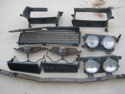

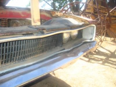

My grille is in very poor shape. It looks like that everything beat it up.:violent1:

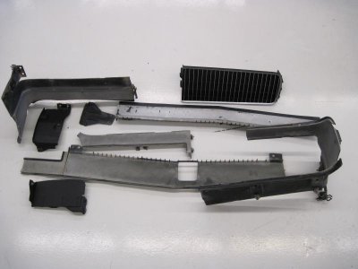

Here ore some of the parts of my grill after I disassembled it.
I bought another beat up grill and am going to try to make one good grill out of the 2.
