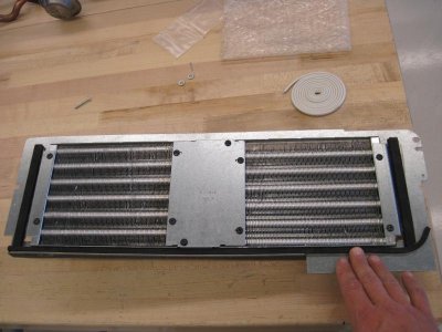

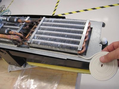

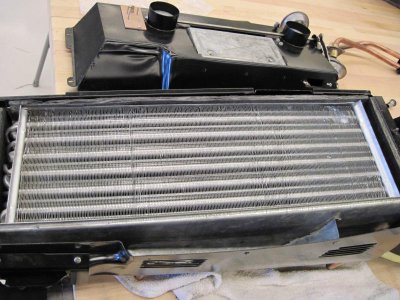

For my heater A/C box I bought a new evaporator core, heater core, and thermostatic heater control valve (H valve). They were pricey. Everything I do seems to cost me more that double what I thought it would cost.
Evaporator core.

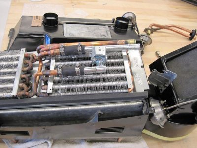

Heater core with my new foam sealers attatched.
H valve mounted to heater core.
license plate light 020.jpg license plate light 019.jpg license plate light 021.jpg

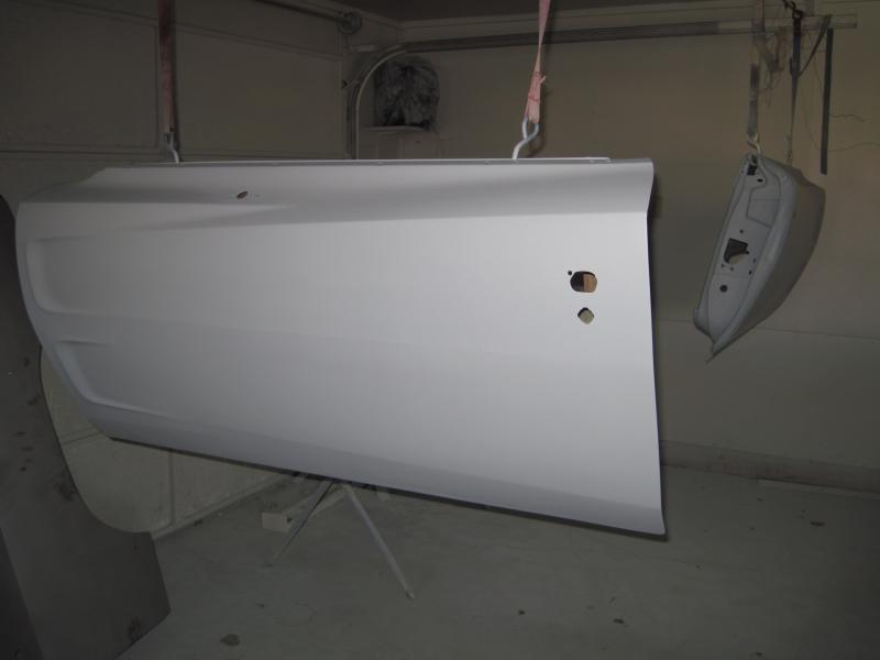

Doors are looking good.

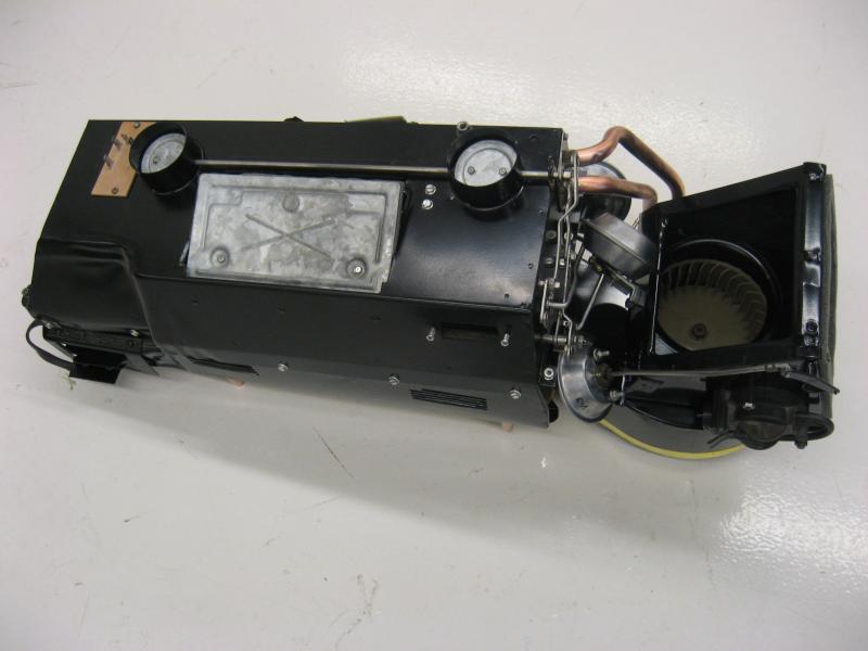

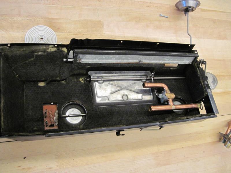

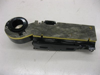

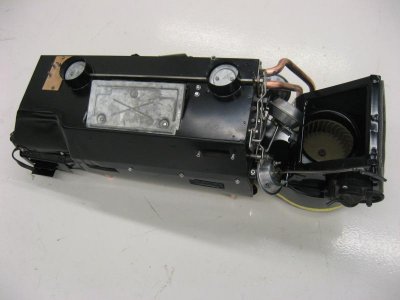

I finished the heater A/C box.:hello2: I installed all of the new insulation.
I calked and sealed it up. I hope that I will not need to get in it again.

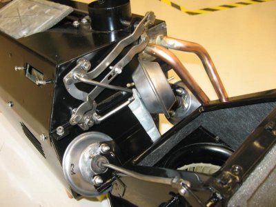

It took some time and observation of some of my pictures to figure out how to put all of this linkage together but I think that it is working right now.
license plate light 022.jpg heater box 3 003.jpg license plate light 018.jpg heater box 3 002.jpg heater box 2 004.jpg

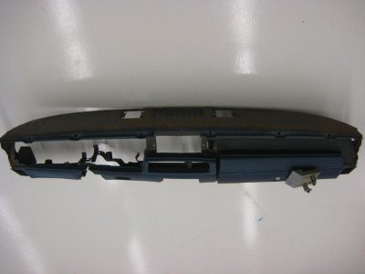

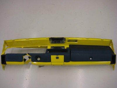

I have been working on many of the parts for my car over the past couple of years. When I got my car it did not have a dash. I got a dash from a 69 charger and have been rebuilding it. It was rusted out at the corners under the windshield so I cut out the rust and reconstructed the pieces and welded them back in.
For sand blasting I thought that I would try one of the hand held sand blasters from Harbor Freight. It worked but very slow. I took several hours to strip the dash frame.
I sanded, primed and painted the dash frame.

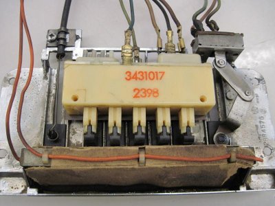

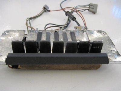

My A/C controls needed some attention.
I cleaned and polished everything the best that I could and bought a new heater control switch unit to replace the old unit.

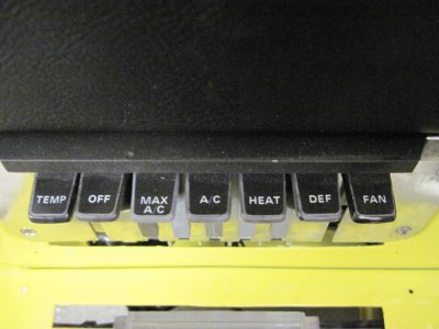

I put label stickers on the front of the push buttons. They were originally stenciled on but I think they look good enough.

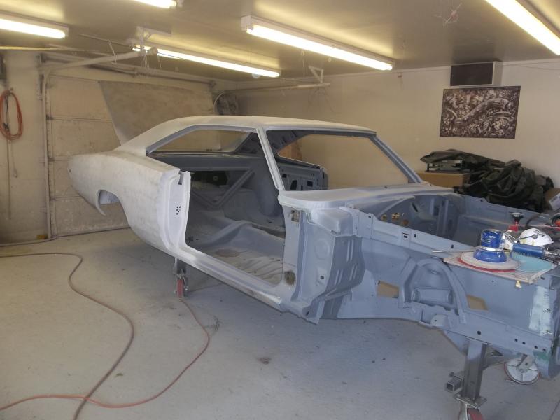

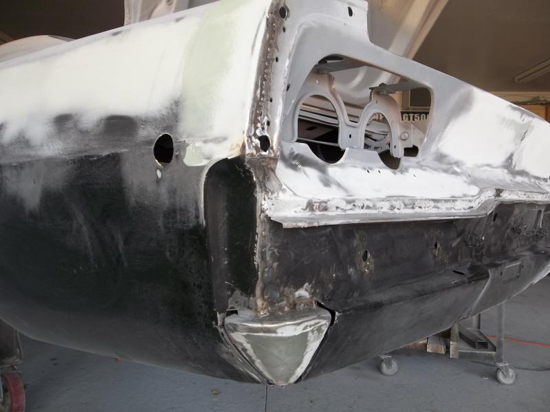

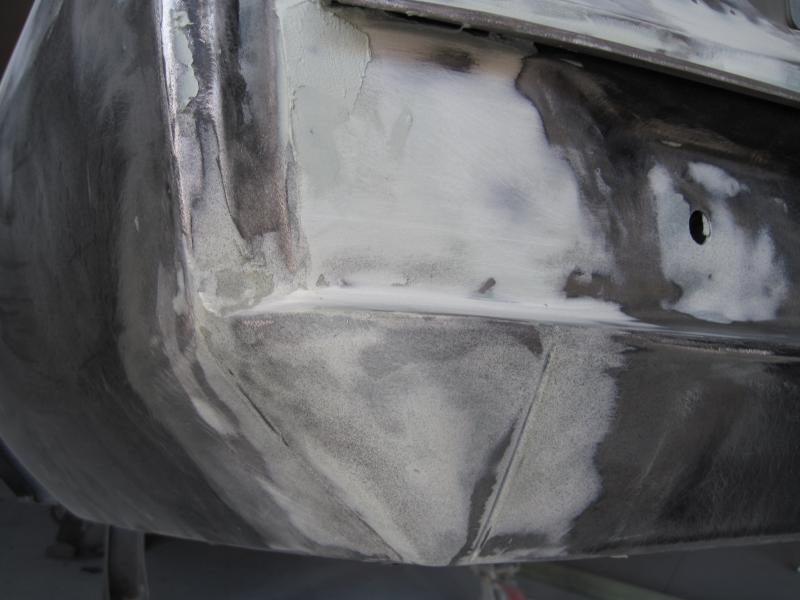

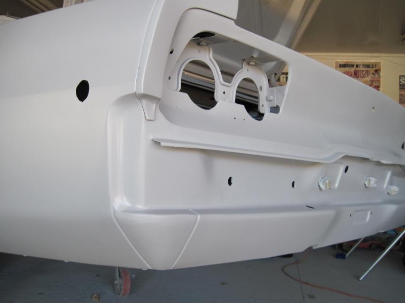

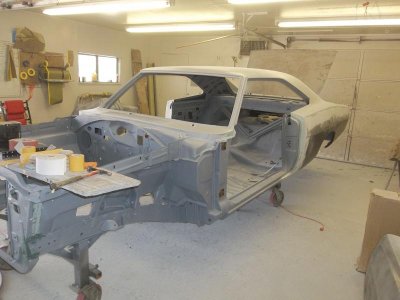

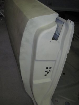

As usual, the new sheet metal needed some custom fitting.
For example, my rear lower corners needed extra welding and duraglass.
Bob did a good job at making them look good.

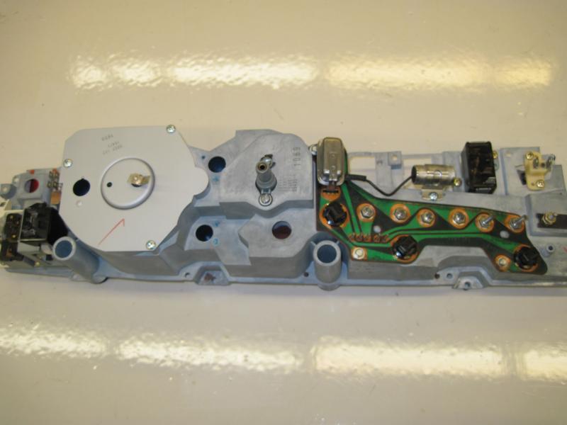

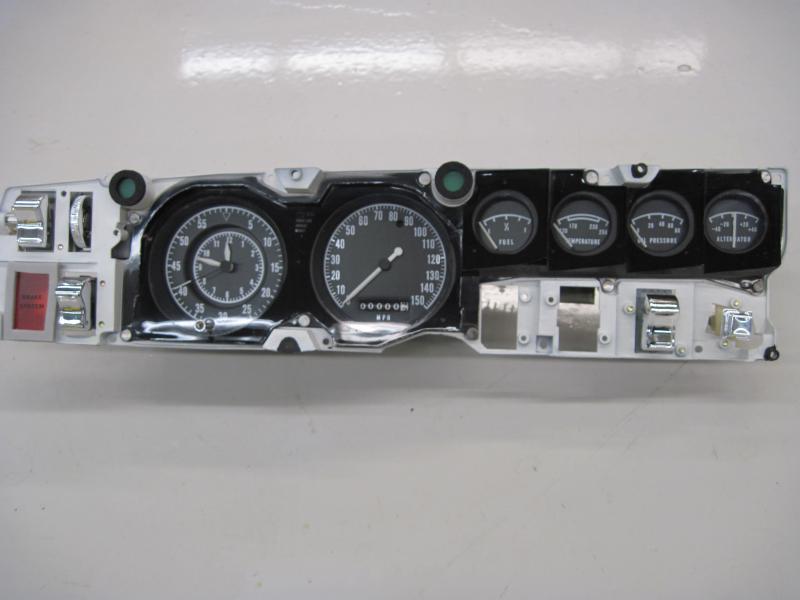

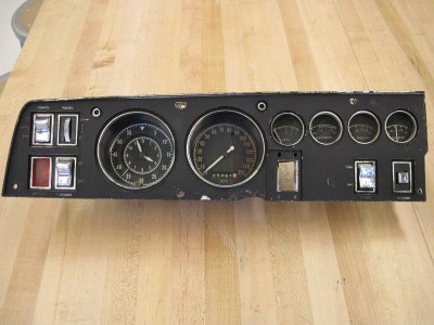

I took my gauge cluster apart and buffed the lens and cleaned everything. Then I had the gauges rebuilt and tested.

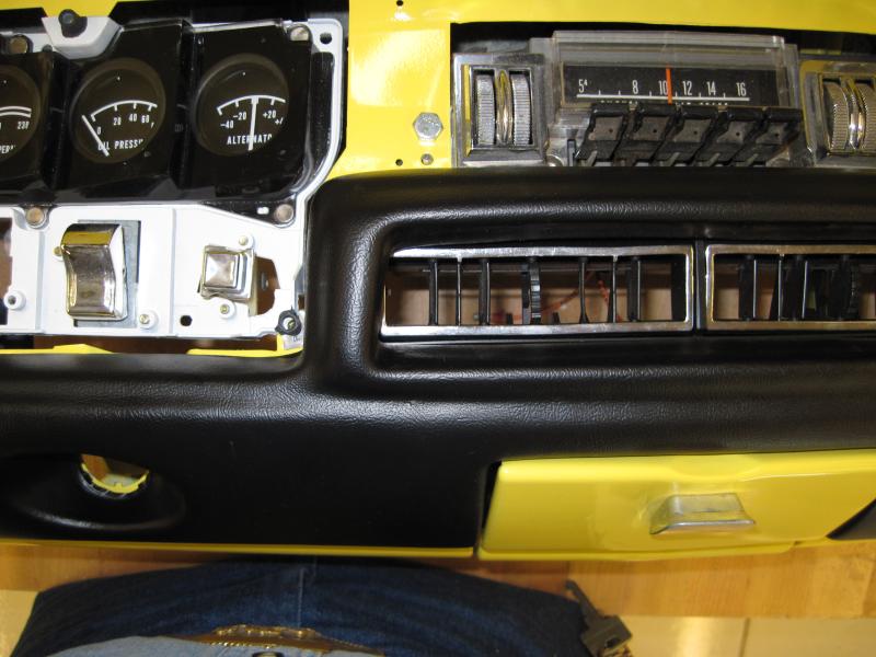

My lower dash pads were warped and hardened from the hot dry temperatures here. I contacted Just Dashes and they let me know that they will trim, smooth, and straighten any of the imperfections before recovering them so I sent my lower dash pads off to them to have them recovered. $825.00 later I got them back. They looked nice but after I installed them I found that they were still distorted and my center A/C vents will not move because the pad has shrunk over the vent corners.:sad2: I contacted Just Dashes and sent them pictures and asked if they could fix my pads. I was told that they did there job right and that if I wanted them fixed that I would need to pay for the repair and recovering. I have not had them fixed yet, I am trying to decide if I can live with it or pay to have it fixed.:eusa_wall:
Wow... that's not saying much for just dashes service. They do the work, and charge you, but then do not guarantee it?
I have heard a lot of good about Just Dashes. If the pads are straight they will cover nicely.
My suggestion would be to pre-fit the pads on your dash and make any trims and adjustments before you send off the pads to have them recovered. I thought that they would have references to compare.
