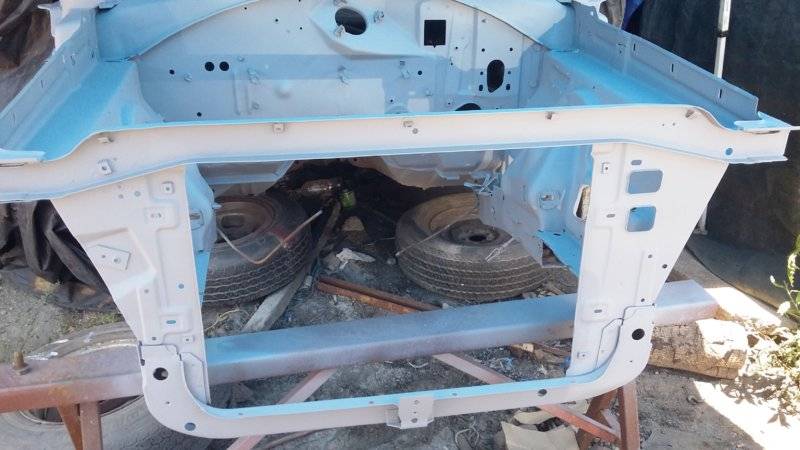

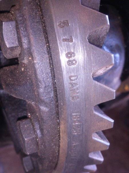

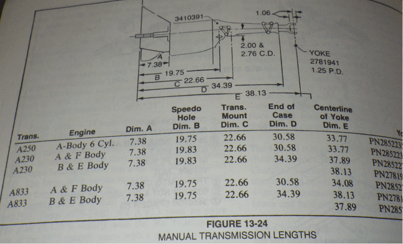

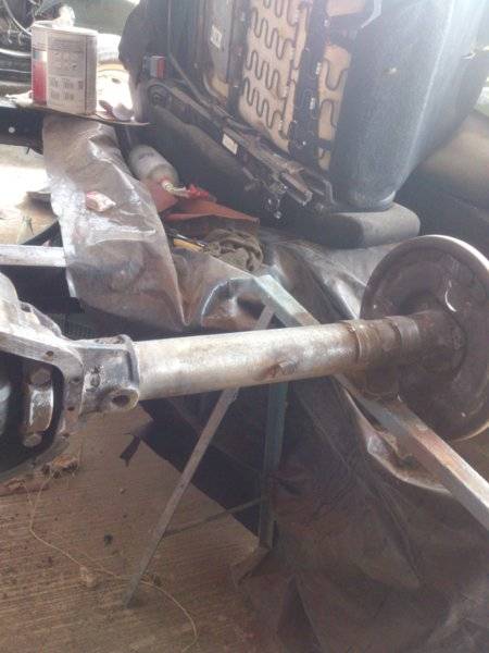

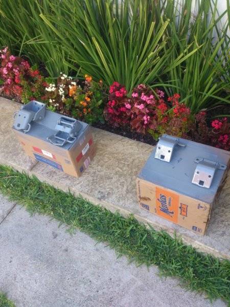

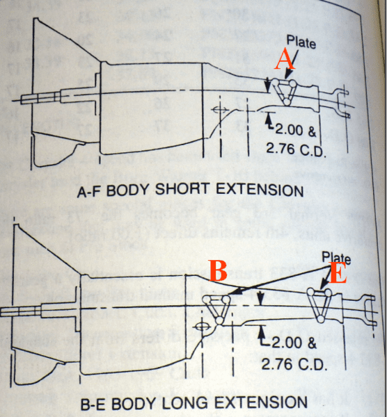

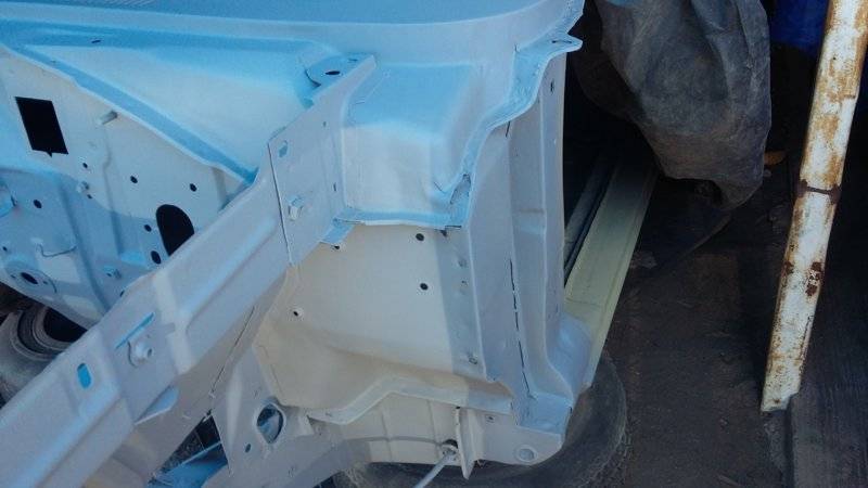

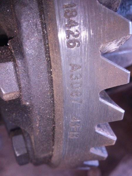

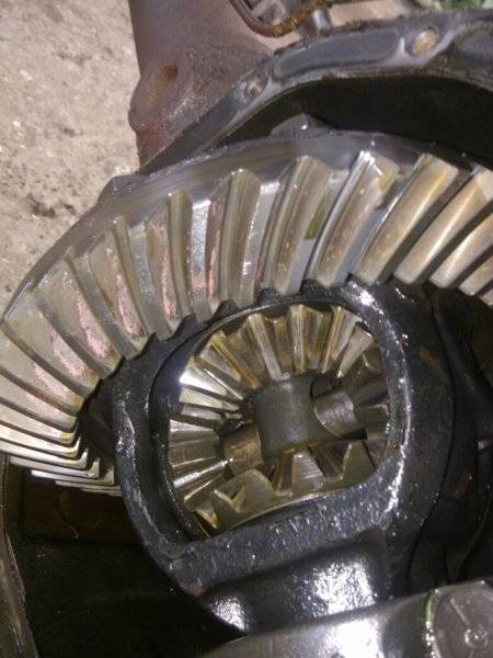

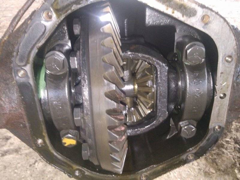

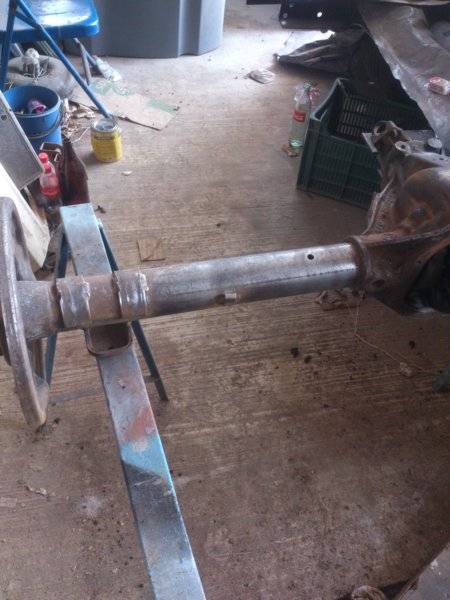

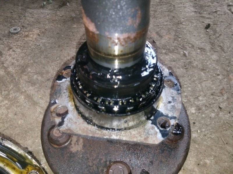

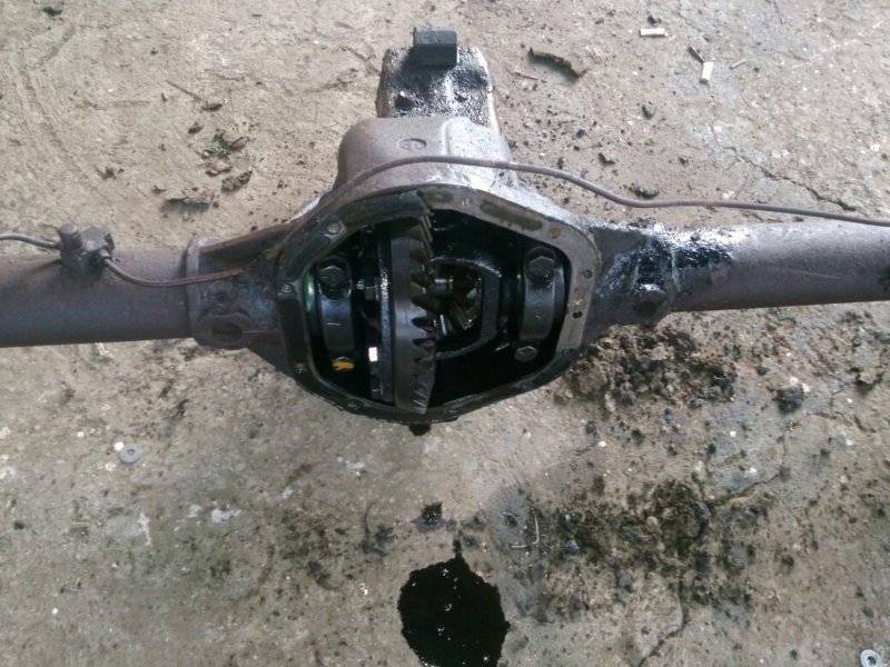

I still have some pics to post about the body work,right now one of the first post I say" nightmare" and kinda is, I already have a transmission an A833 but from an a body and I don't know if I can fit it in, I already have the front disk brake conversion from an a body, the entire bushing box, disassemble the Dana rear end, look great inside no sharp edges, the rear brake entirely new except of course for the drums but those I made it rectified and came out in great shape, I already have the filler primer, the color and the transparent are paid for( the dollar here always goes up ) I have an issue with the rims they told me they fit my car but they don't so my machine guy redrill the studs, now they fit perfect but... I don't have a body man and am really getting tired of being scammed off with the body work I want it the best possible way, my car is going to be a weekend driver so no show room quality is needed, the guy i have leave the job and went to work to the USA, so to be honest am thinking about blocking the car myself, besides one of the doors have a terrible Job in a corner that's need to be redone bu tall this is expected I guess.
