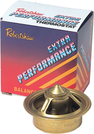

Always buy a Robert Shaw or a Mr. Gasket "high performance" (or whatever they call it) thermostat. They are built differently, are "even flow" and are much closer in configuration to what Mopars originally came with.
