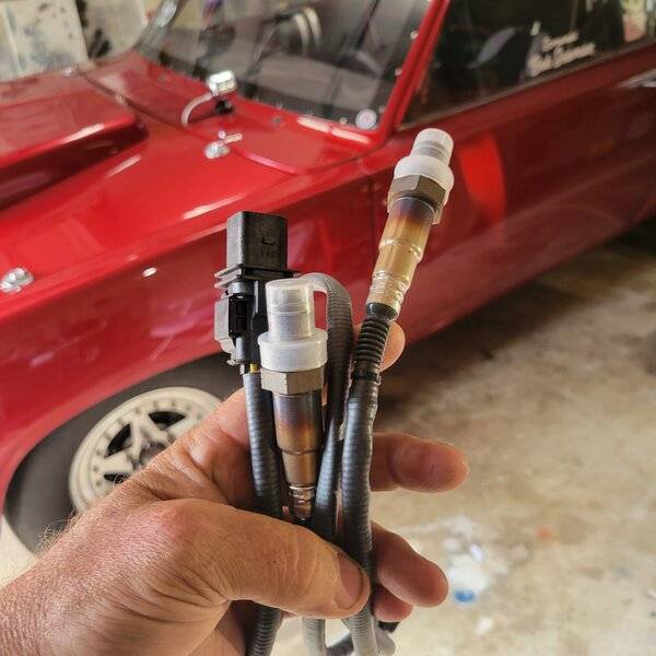

I'm finally hoping to take a little guesswork out of my favorite hobby.
The first pic....just where exactly are those to
be inserted?

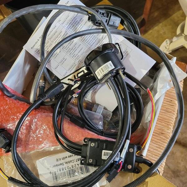

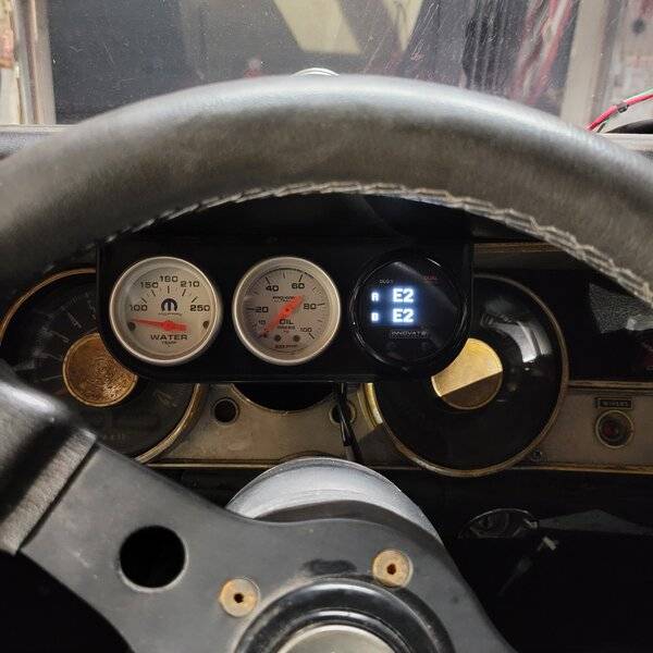

The unit is an innovate dual wide band.
Got it from summit racing for about 315 bucks.
It can record to a laptop.
Has a real time gauge which I mounted right in my face.
They have a program you can download for free on their website.
Some people have had problems with them on the street.
But I'm just looking for WOT.
The people I heard from with issues were all carbureted cars.
