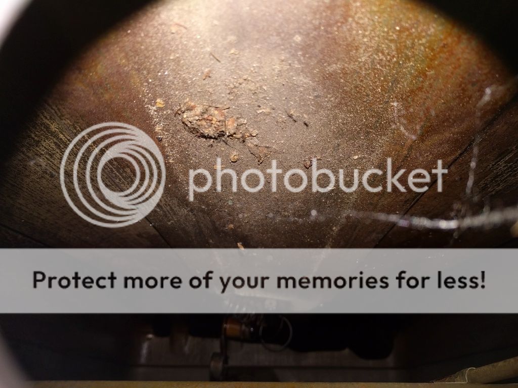

I went to drop the gas tank to see what kind of fun lived inside and I noticed there was no gas cap. I recon there hasn't been a gas cap on it since at least the last time it was registered. Looking inside the filler neck revealed many generations of spiders time had long since forgotten and a couple handfuls of dirt/dust/leaves.
I tried to get a pic inside but my camera refused to focus on anything further than 6 inches into the tank. Actually it looks a lot more focused on the screen vs the camera.

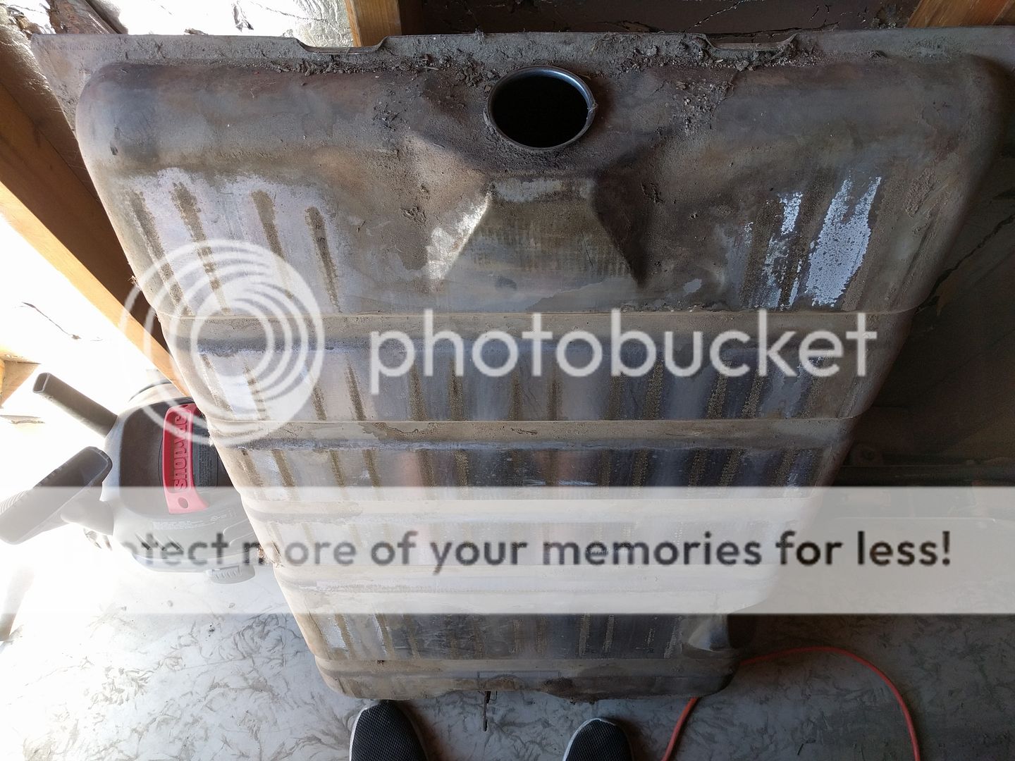

I tried to clean it out but found that deeper still into the tank was about 1/2 gallon of gas that had turned to varnish. I tried to clean that out but gave up and just ordered a new tank. On top of the varnish and dirt in this tank it also had a big dent in it from when Bo & Luke jumped a ravine.
It's kinda hard to see, which is odd.
However the tank does have a good side.

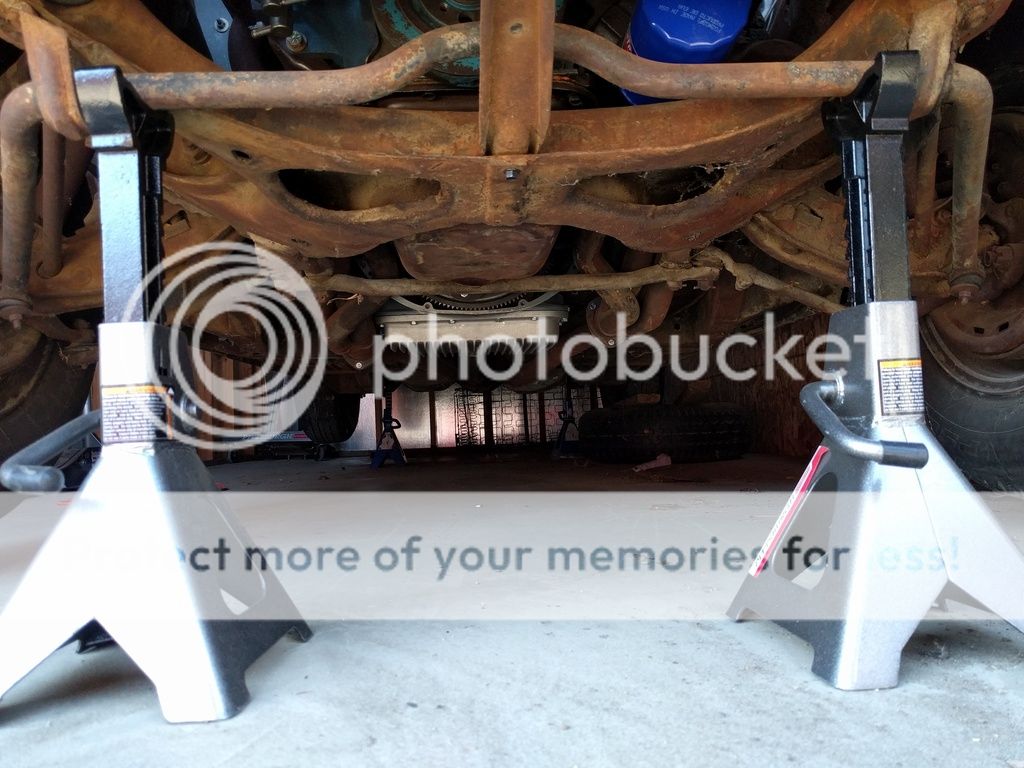

just my two cents....I'd move those jack stands from the sway bar to the lower control arms.
X2. that sway bar will bend and you could end up with the car on the ground, hopefully without you under it.
x3 As close as the jack stands are I don't think they will bend the swaybar but it has absolutely no grip and can slide. Under the frame rails or control arms are much safer!
I'll get them moved to a better location, thanks for the concern.
Just where on the lower control arms, is it safe to set a jackstand? The arms are at an angle and the stands can slide. I would like to see a pic of a safe spot --especially when the tires are still on..............................MO
