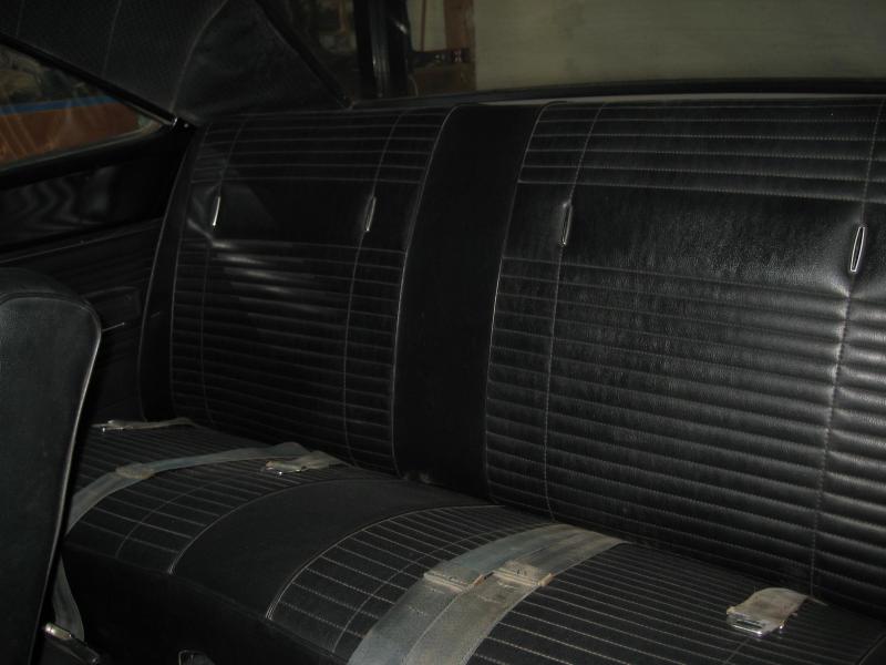

Thanks again. Removed all the mouse poop from under the back seat. Everything is solid so far. Im lucky it was stored in a garage with a concrete floor.

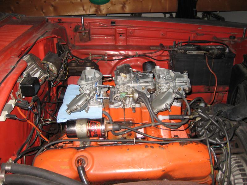

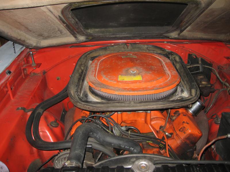

thanks. went through the carbs today. rear carb had a stripped bowl for the needle and seat and had to order one from holley. front carb didnt have the float spring in the hole on the float arm causing it to be jammed upwards, center carb had a rock hard accelerator pump that didnt move. previous owner said there was a fuel leak at the carbs,so we will see. hopefully get her running when the bowl comes in.

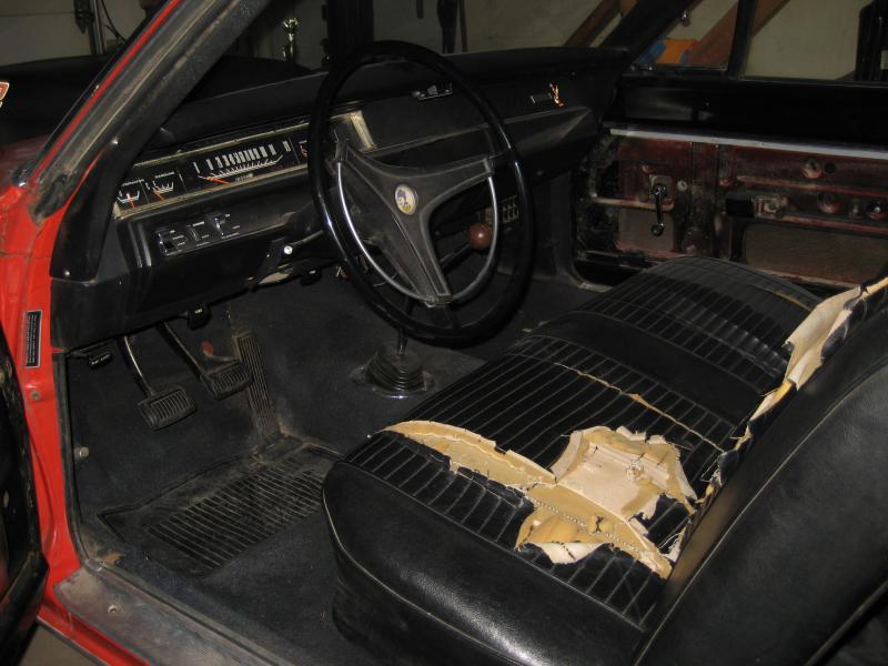

Carb are all rebuilt. It runs and drives good now.might be missing a tooth on the fly wheel. Door panels came with the car but will need front seat covers.IMG_1270.jpgIMG_1271.jpgIMG_1269.jpg
