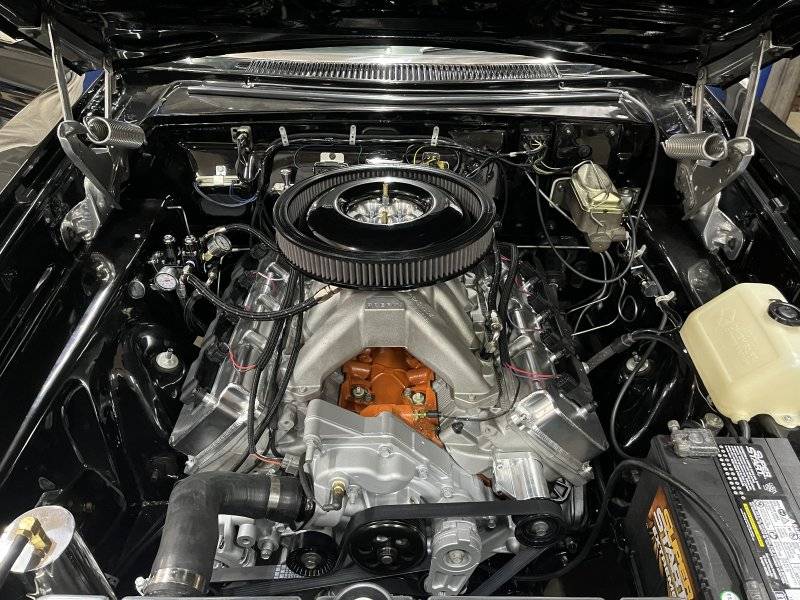

My Gen3 swap is complete!
No this is a 6.1 stroked to 426
I bought from a buddy who built it for someone that decided to do a Hellcat swap. I wanted to go with a carb just to keep the old school look I got EXTREMELY lucky getting it to fit under the hood with an air filter on it. There is zero clearance LOL
Beautiful car and nice build. I really like those valve covers. Who's motor mounts and headers did you use?
Headers are Holley Blackhearts (discontinued)☹️
Engine mounts are a hybrid made by the guy that helped me with the swap
They are solid mounts which are almost a must with these as rubber ones don’t last.
Yeah, that is crap that holley discontinued those. EPA fears I would imagine, which is crap if you ask me. But thank you. I am building a gen 3 426 stroker for my friend's 65 Coronet 500 vert and I'd just like to get him set up.
What cam is in this motor?
At the time years ago it was a custom grind by Steve Frank of Comp cam but FRP sells the same cam now i believe they call it the Trident
Buts my full engine specs are:
6.1 block stroked to 426 Molnar crank
4.050 stroke 6.125 and rods
Mahle pistons
Eagle heads ported
10.9.1 compression
Cam is 239/251 583/583. 112+2 centerline
Prefix intake and a Dominic Thumper 1000cfm carb
Msd ignition
yea and Holley discontinuing the header sucks . i have two sets and if i had known they were gonna discontinue them i would have bought 4 or 5 sets
Yea I would have definitely bought at least 3 sets myself! Tti is nice but don’t fit as well with stock k frame

Went carb because I wanted an old school/new school look and I didn’t want to deal with all the extras that come with efi… sensors/tuning etc I know it’s more efficient and probably better performance. Had this one custom built for the engine 1000cfm
I have a wide band o2 on it so I can keep an eye on it.
