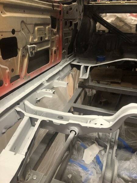

Progress. Filter cartridges finally came after I ordered another set. The day after I ordered those, I requested Amazon replace the missing original ones I ordered. The next day I got 2 pairs of cartridges delivered to my house...weird! Anyway, I finally got some epoxy on the inner framerails and surrounding area in prep for putting the floors back in. I was more concerned with getting the inside of the crossmember than anything. I got as far insined the framerails as I could. I’ll get the rest with Eastwoods framerail paint - the one with the hose that inserts inside the rails.
This is what I used. It got a lot of good reviews, figured it could’t hurt. Plus, much easier than setting up a gun for such a small area:
I also sprayed the replacement rear framerail:

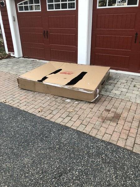

I started installing the front floor pan. I ordered it from Jeff @ 521 Restorations. He’s a great person! Despite getting two separate phone call from the shipping company telling me I would receive a call one hour before delivery (the first person that called me said) and a call 1/2 hour before delivery (the second person said), no call :mad: This is what I found when I got home from work:
Don’t mind the different color/style pavers. They’re temporary until I can get the driveway redone.

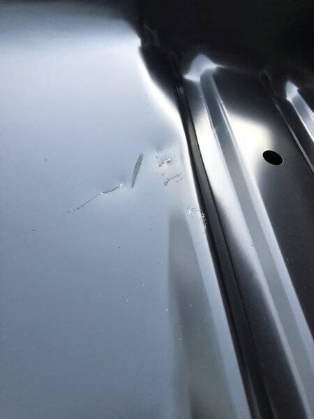

There was only a small bit of damage to the pan that I was able to hammer out (most of):

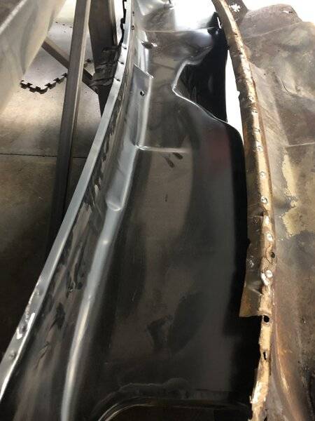

After test fitting, I traced around the framerails, crossmember, inner-rocker, etc. I then placed my old floor over the new to mark out, roughly, where the original spotwelds were. I then drilled them out:
I only had to trim a small amount off the bottom corner of the passenger’s side and the top corner of the driver’s side.

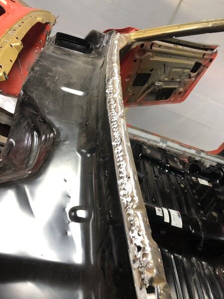

The crossmember hump was a BITCH! I’m not sure if the pan got bent or something in shipping but the pan was siting a good 1/4 inch away from the crossmember at the hump. After bending the pan a few times, hitting it with a BFH and some strategically placed torx screws, I was able to pull the pan flat against the crossmember. It fought me the whole way. I was able to spot weld in half off the pan before running out of time:

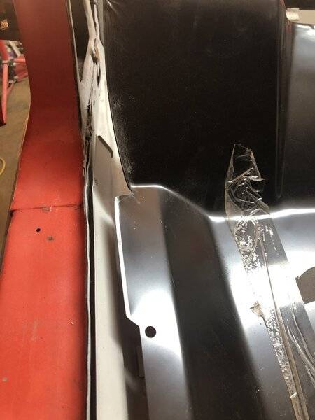

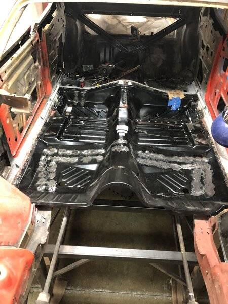

More progress, got the rear foot wells installed. I had to use several Teks screws to pull the panels into their proper location before welding.
Test fitting:

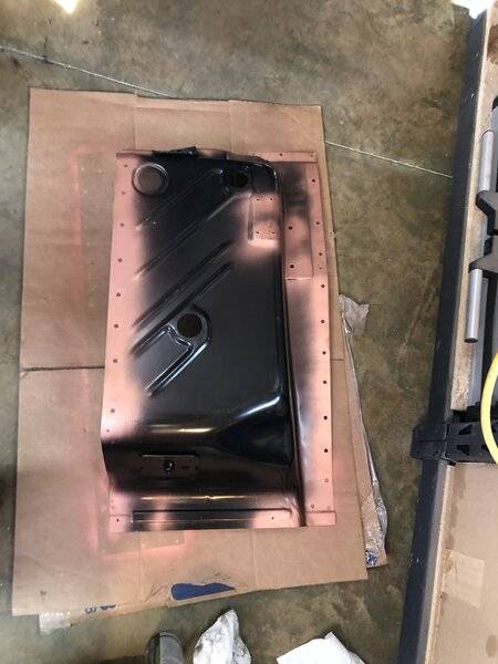

After using the old panels to mark location of original spotwelds, I drilled them out and sprayed copper on the back:
Both sides all welded in. I just have to finish grinding/sanding the spotwelds then, hopefully, on to the firewall.

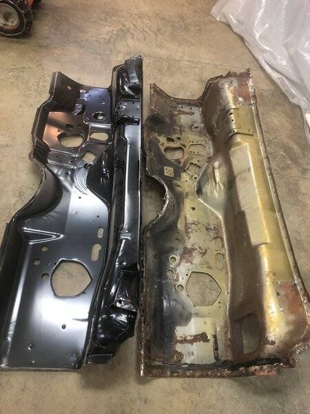

I’m still making progress. I had to patch a few small areas on the driver’s side cowl side panel. After doing that, I started mocking up the firewall for installation. I looks pretty good so far. I used the AMD panel for A/C equipped cars, which mine is. They are a few differences between the AMD panel and my original. I had to remove the two top mounts as they are different on my car and still attached, as well:
I removed both mounts on both sides:
This pic also show the ears on the mounting point (to left of grinding marks) that my original does not have. I may have to grind them off later.
Side by side they are pretty close to each other:
I may have to remove this center piece, as well. Mine original didn’t have it.
Here it is mocked in with the cowl mocked in too:

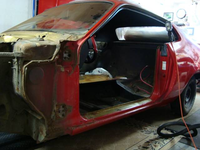

I will have to add to the top corner flanges on the firewall panel too. They are are little shorter than the original piece. Before I can get everything mocked up properly, I have to replace the bottom of the driver’s A pillar:
This is a very common spot for rot in these cars.

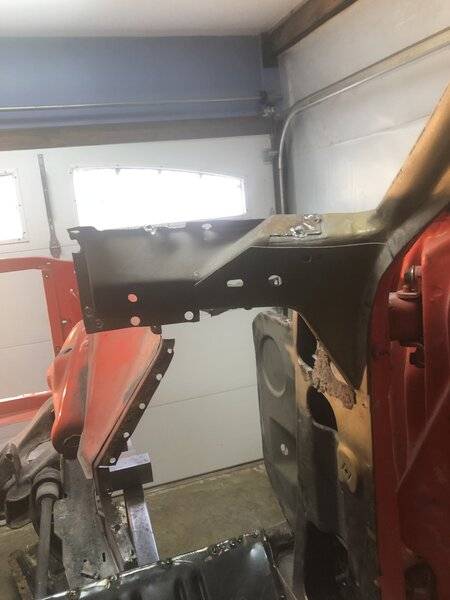

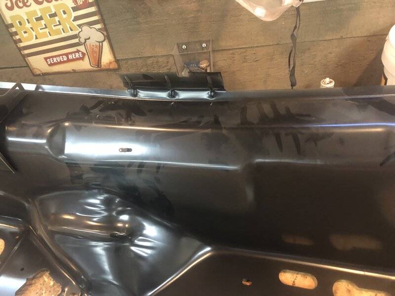

Some more progress: After rough fitting the firewall, I noticed that the top flange is quite different on my original firewall:
As you can see, the AMD firewall (which is for an E Body) has a smaller flange at the top. I then decided to cut the top flange off of my original to make up for the difference. After taking a bunch of measurements, I cut the flange off leaving some extra material to adjust the fitment:
I then placed the cowl back on with this piece placed under it and in between the flange of the AMD firewall so I could mark it more precisely (for me, anyway):
I then installed it under the cowl and checked the fit. I then removed the cowl and put a few tack welds on it and checked the fit again. I then made my first pass of welds, ground them down and then planished the seam:
