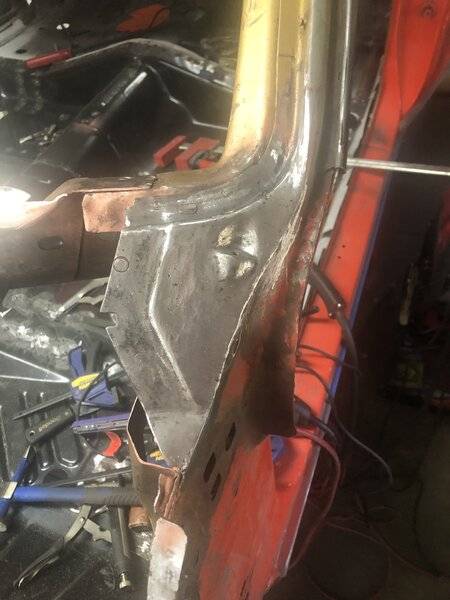

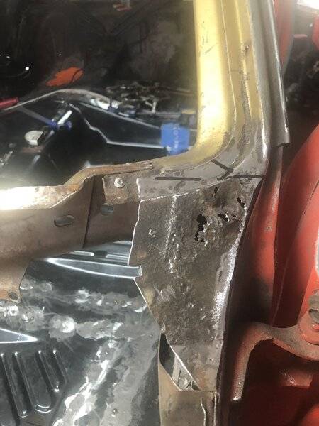

Progress: Today I worked on replacing the lower driver’s side corner of the windshield frame. This area was rotted pretty bad which is typical for these cars. I marked the area that I wanted to remove after taking several measurements and comparing with the donor piece:
I got the donor piece from moparmarks, thank you mark:
I cleaned this up and applied some Rust Stop. After the Rust Stop dried, I sprayed the entire back side with a good coating of copper weld through primer:
Test fitting for probably the 20th time:
And welded in:
I sprayed it down with some weld through just to keep rust from forming:
I also hosed the area under this piece with Rust Stop and applied a good coat of weld through in there. I was going to start getting the firewall in but, I’m thinking I’m going to wait until I get a new windshield. I want to make sure the cowl is set right before I weld it in permanently. I suppose I can get the firewall in and then wait to install the cowl when I get the windshield. That way, I can make any adjustments to the cowl if needed for the windshield to fit properly. The lower piece of trim does appear to fit properly on the cowl when everything’s mocked-up but I’m thinking that this is probably not a good reference for proper positioning of the cowl.

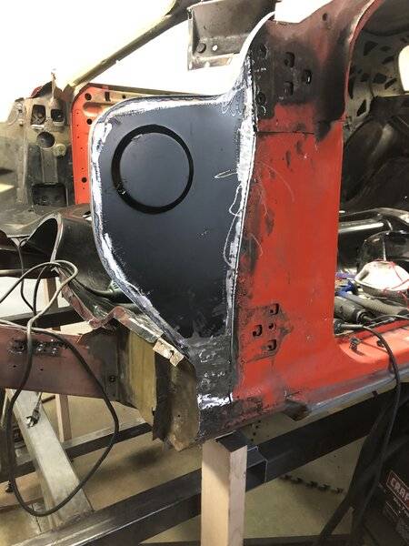

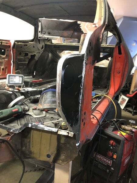

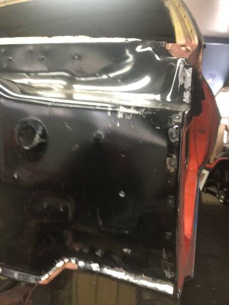

Progress is progress; Today I decided to replace the left cowl side panel. I originally patched the top portion of it an replaced the flange but, I was chasing blow-through around the top of the circle detail and a few other places. So, I purchased a Goodmark panel for an E body off EBay hoping it would be close enough. The circle detail was very close but not in the right location. It was further over to the right of where it was on my original. I then cut off what I could use:
After this, I made a poster board template and trimmed the new piece to fit:
First pass with welder before grinding and planishing:
Then finished welding, grinding and added a new flange:
Not too bad I guess.

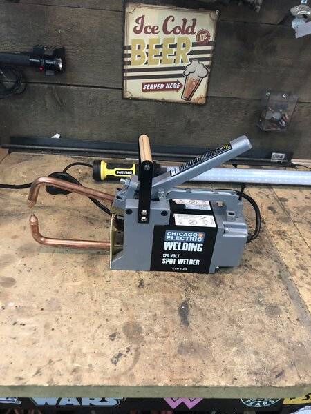

The firewall is in!! Instead of doing a million plugwelds, I decided to purchase a ChiCom spot welder form Comrades R’ Us. I’ve read a lot of good reviews on the web so I figured, what could I lose. Here’s the spot welder:
I then did a few test pieces:
I think it worked pretty good. I went with a count of 3 each time. I then tried to pry the pieces apart with a body panel separator. The metal tore around the spot weld while the weld remained:
I did learn, by trial and error, that the spot welder does not like the EDP coating. I had to sand it off, both pieces, before spot welding. I also sanded off the mating surfaces and gave two coats of copper weld through. And, the firewall in!!:
There were a few spots where the spot welder couldn’t reach, I plugged those. I also had a few holes from AMD that I had to plug and a few spots where I held the trigger on the welder for a second too long. All in all, it worked really well and will save me a ton of time. I also purchased a set of longer & wider tongs from a guy who makes them and sells on EBay.

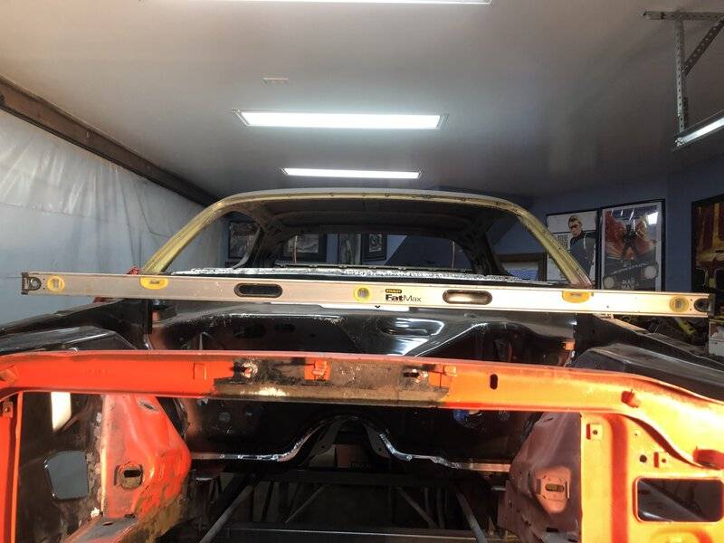

More progress: This weekend I started working on getting the inner fenders installed. I left the right inner fender on as reference. I also used my old firewall to measure for the cowl to fender bracket placement as well. Before welding in the driver’s side, I checked for level across several places from let to right inner fender:
I then welded in the driver’s side and removed and installed the passenger’s side. I used my references and level about a thousand times before welding in:
And make the noise:
I was able to get both inner fenders in:

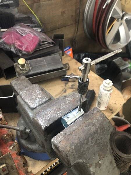

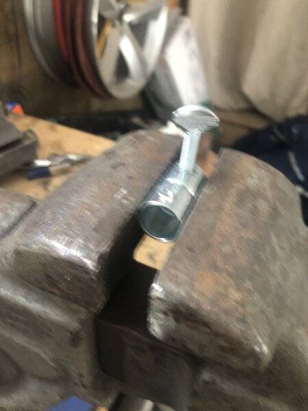

Having to measure frame datums alone really sucks and is pretty much impossible. I usually have to wait until my wife or one of my kids is free to help me. Then I stumbled across a tram gauge. Not being in the business, I’ve never heard of one. Not wanting to pay $150.00-$300.00 for one, I decided to build one myself. I got the idea off of a hot rodders forum. I purchased a 5’ section of 1/2” metal conduit from Home Depot (i originally wanted to use 3/4” but they only had a box of 25 3/4” couplings, which I will never use/need), a small bag of 1/2” couplings, 1/2”x1/4”-20 thumb screws and a couple of 6” nails. I retapped the coupling for 1/4”-20 and then cut it in half so I would have two mounts. I then welded on the 6” nails to the coupling halves. Not too shabby. I may buy a longer piece of conduit if need be.
Supplies:
Re-tapping the screw holes:
Thumbscrew test fit:
Nails welded on:
Voila:
Total cost: $7.36!!

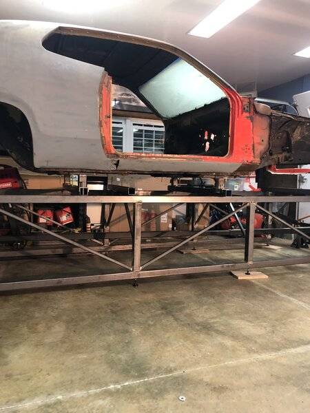

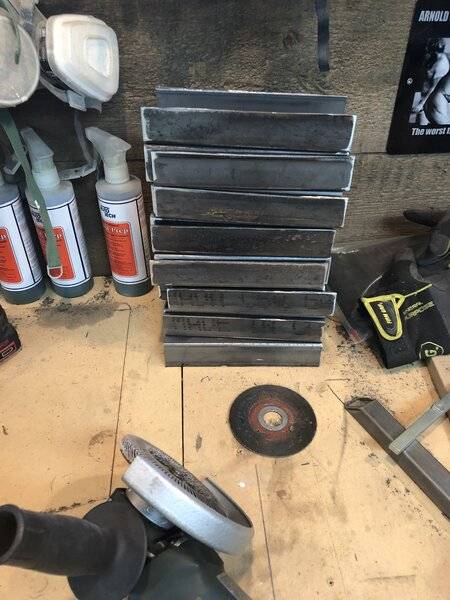

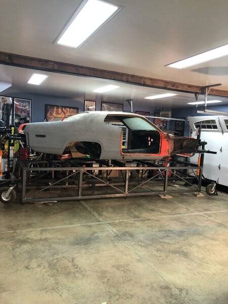

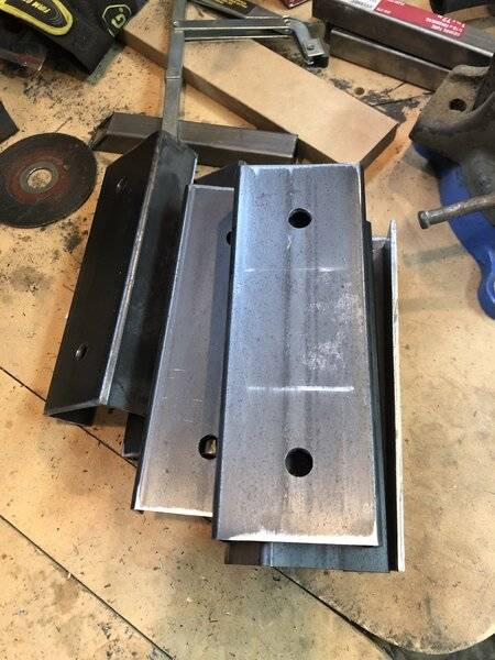

Making some progress. Cut a bunch of saddles for mounting RR to jig. Also drilled some holes too.
I then mounted the RR to the jig at four points that are level, according to engineering sheet. In retrospect, I probably should have made the jig about a 10-12” lower.
View attachment 1018458 View attachment 1018459
I just need to add mounting points to the rear and front. The RR is resting on the saddles but still attached to my rotisserie. And, of course, my welder stopped working half way through for some reason...super!

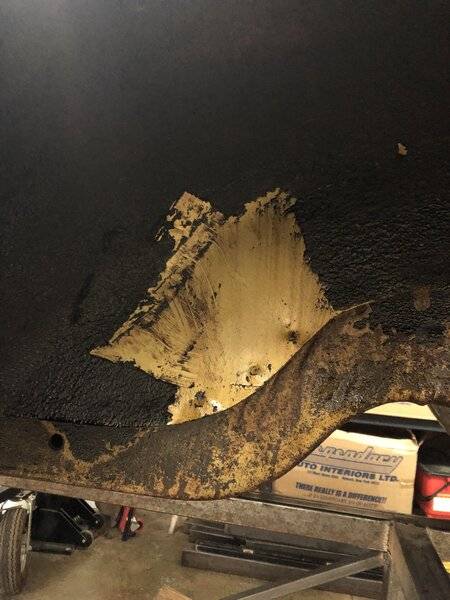

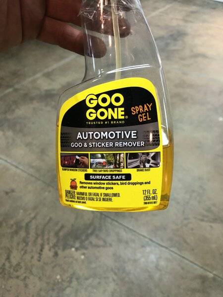

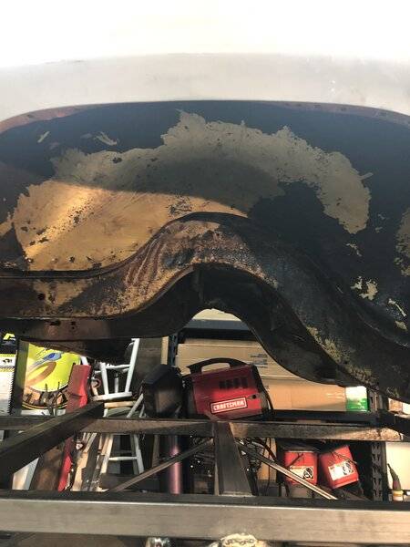

For shits and giggles, I also started removing the rest of the undercoating. I read somewhere, maybe here, that Goo Gone Automotive works well. So, I hosed one of the wheel wells down and let it sit overnight. I was able to scrape off a pretty good area with a plastic scraper with relative ease.
I soaked it again and let it sit overnight. I was able to get even more off with ease. All of the undercoating that I sprayed is soft now as apposed to hard as a rock when I started. And the citrus smell is quite pleasing.
Wow That works great! I wished I had known about that when I did mine, I used a paint stripper and putty knife. I have a 72 RR also

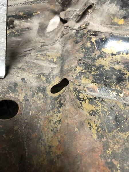

I started on the removal of the left rear frame rail. I’m also going to replace the trunk pan and rear panel, as well. I figured it would be easier to remove the trunk pan before the rail so, that’s where I began. As you can see from the image below, my car has damage from being struck in the left rear corner at some point in its life. The strike bent the left rear frame rail and caused the floor pan to pucker.
It also caused the back half of the left rail to be about 1/2” lower in relation to the right rail:
You can see that the trunk opening is off (1/2”) from left to right. You can see how much the rear was pushed (area between arrows) by holding a straight edge against the trunk opening:

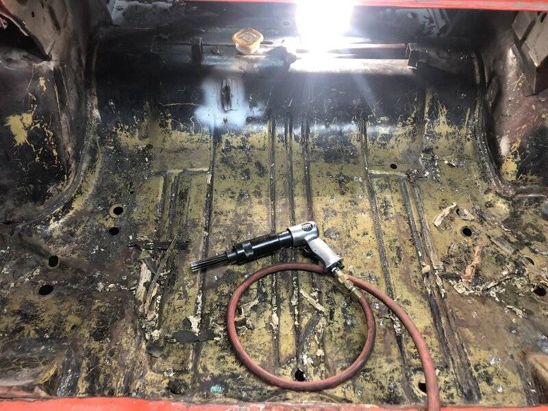

I drilled the spot welds first. Holy crap there’s a lot of them holding the trunk in! I also used a needle scaler to remove the old seam sealer. It blasted right through the sealer.
I then pulled the trunk pan out. And of course, I found another nest in the right frame rail.
You can see the damage to the rail in this picture:
