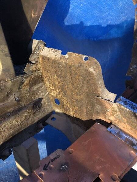

Today I decided to fix the flanges on the pieces that are on the sides of the firewall. I’m not sure what they’re called. The flanges on both sides were pretty much toast:
I did the right side first:
New flange in:
I have to add a small piece to the top. And a few small patches to the side.
And then the left:
I have to add a small patch to this side too.

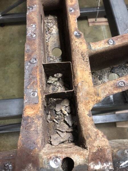

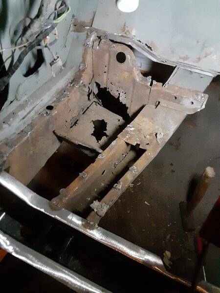

After doing so, I found a lot of pieces of rust piled up in the torsion crossbar member. Not good:
I poked around a little bit with my pick and uncovered this, the hole to the right of the circular hole:
Pretty good sized hole and looking closer at the entire torsion bar, it’s pretty crusty. So, i’ll Be replacing this, as well. Super...i guess it’s only money :).

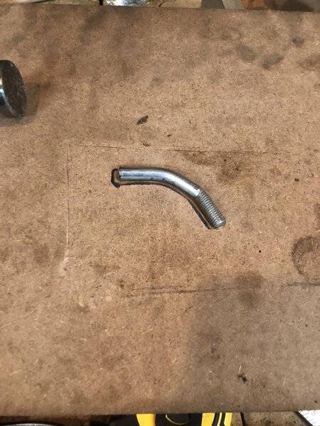

I had some time after work today so I decided to try my hand at fabrication. The left corner of my cowl was destroyed by rust. As you can see from the images below, there is a radius that runs along the cowl. I had to figure out a way to recreate this radius. I used an extra bolt I had. First, I bent the bolt to match the downturn in the radius. Then I cut the head off of it. I then used my dremmel and small sanding drum to hollow out a piece of MDF to use as a buck:
This is the radius i’m trying to recreate:
Then I clamped a piece of sheet metal over the bolt and beat the hell out of it.
I then cut the metal to size and ended up with this:
After welding in place:
I still have a lot of cleanup to do but, I’m thinking this didn’t come out too bad for my first attempt at something like this.

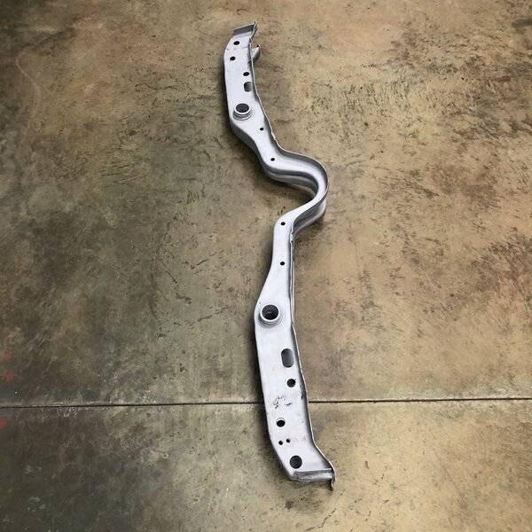

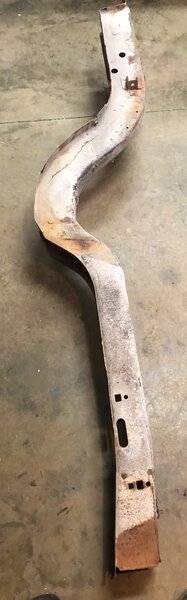

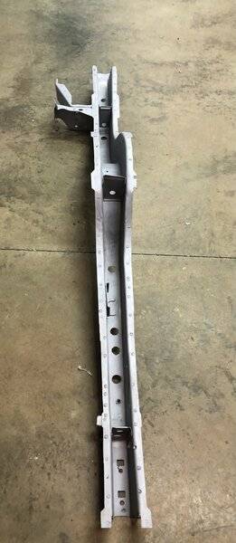

I got a few things done today. I received my donor torsion bar crossmember from Moparmarks, thank you Mark, on Friday. I then put together my HF 10 gallon sand blaster that I bought about 10 years ago. Most of it was “pre-assembled” but, of course, whoever assembled it forgot teflon tape on one of the fittings and a few of the fittings were pretty loose. This is what I started with:

After cleaning up the crossmember - grinding off spot weld remnants, etc., I added some cross-bracing and 2X4’s to support the rockers when I cut out the existing crossmember. I also put the doors back on and mocked up the lower control arms/torsion bars to take some measurements. I was going to take my time and drill out all of the spotwelds to remove it in one piece. Now I’m thinking what’s the point, its trash and will take a lot longer. I’m going to cut it out in pieces then drill out the spot welds. This wil give me better acces to them, as well.
Hopefully, I can start removing the crossmember in the next few days.

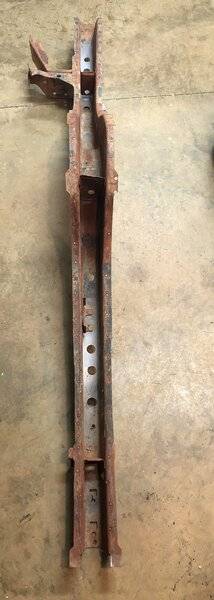

At it again. Yesterday I started removing the torsion bar crossmember. I was almost finished when fate struck me...literally. I forgot that I left my replacement firewall on the roof of the RR after I test fitted things. I had to use the air hammer a bit trying to pop a few of the spot welds I couldn’t reach with my drill. All that fibration caused the firewall to slide of the roof and onto my head. Super!
Nice little gash on the back of my head and a quick run to the ER. Thankfully, it wasn’t quite deep enough for staples so, they sent me on my way after cleaning it out. I decided to take the rest of the day off.
Today, I was able to remove the old crossmember. I then had to patch a few small tears in the rockers that I made...because I’m an idiot.

I used donor flange material from the removed crossmember:
Test fitting the donor:

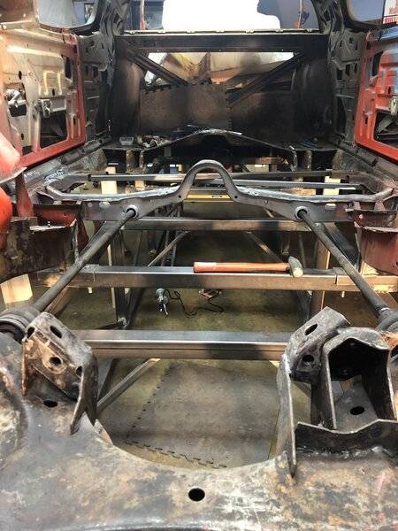

Framerails and rockers are still level. The body jig is working well.

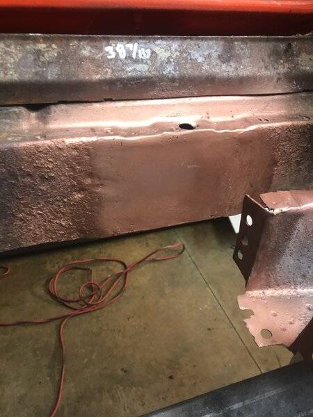

I haven’t had much time to work on the Bird. I decided to patch a small area on my rocker that sits behind where the crossmember attaches to on the driver’s side. I chewed this area up while removing the original crossmember. The donor crossmember tabs were not sitting flat against the rocker. Here’s the spot:
You can see the areas where I was heavy handed with the air hammer :cursin:
This is what I cut out:
And this is what I pulled out of the rocker:
Damn rodents. I will not tolerate infestations!!
Patch after the first round with the welder:
And the second:
A little copper primer (front and back), and Bob’s your uncle:

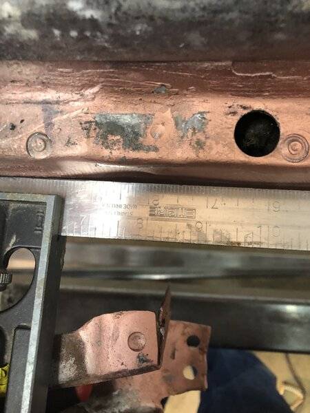

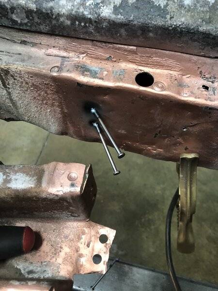

I got some work done today. I finally got the crossmember installed. I was having a bitch of a time because I didn’t take my time removing the original. I dented the rocker on both sides. It was just enough for the tabs on the crossmember to not sit flat against the rocker. You can see in this pic what I was dealing with:
I debated for a bit whether or not to run to HF to purchase a stud welder to pull this out a bit. Instead, I used some shady tree ingenuity. I welded a few common nails to the area, modified my slide hammer to accommodate the nails and had at it.
I was able to pull most of the dent out. Then I inserted a thin chisel and different size screw drivers into the hole on top of the rocker and was able to push the dent out the rest of the way.

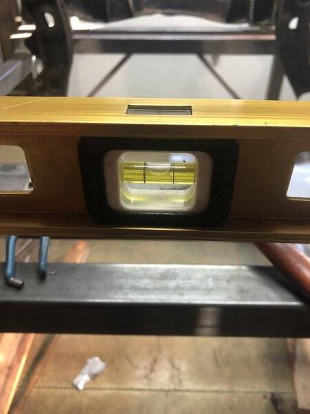

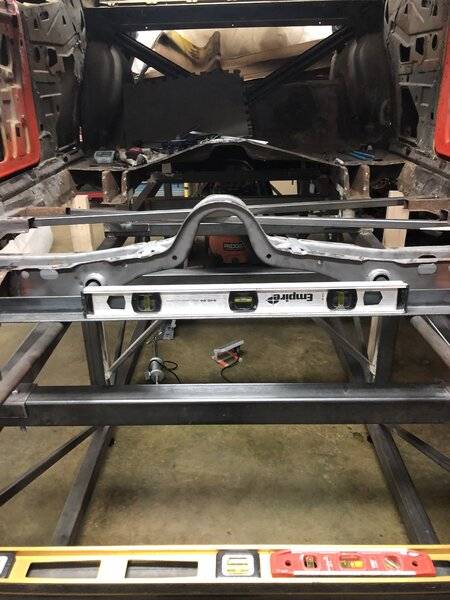

And, after triple checking all my measurements and checking everything with a level, the crossmember is in:
And make the noise:
Sorry bad pic. The crossmember is level, the frame rails are level and the torsion bars are level. Now I’m planning on either blasting or sanding all the rust in this area and then spraying epoxy on everything before the floor goes back in.

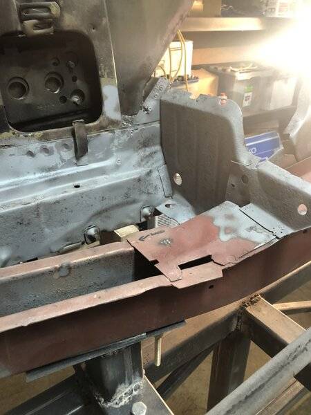

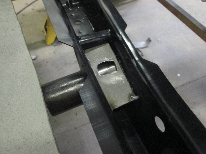

I had some time after work today to get a few things done. It was recommended on here (thank you Dadsbee!) to reinforce the torsion bar mounting area on the crossmember. I wanted to make it look kind of factory. So I made a rough template out of poster board and transferred it to some 16g metal. I then drilled some holes for plug welds and then crudely bent it up in my vice:
Then I sprayed weld-through on the back of it and inside the crossmember where I was going to be welding. I forgot to take pics of all this, of course. Here is how it looks installed:
Now I have to cleanup all the surface rust, etc. and put everything in epoxy before I start putting the floors back in.

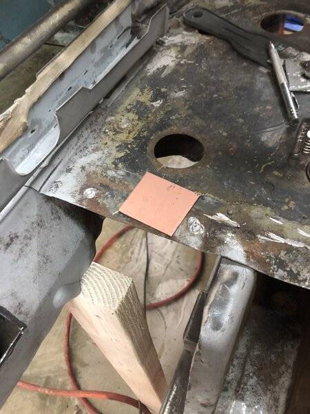

Stil plugging away. After blasting the rockers, I found another rotted area. I cut it out and patched it:
A little weld-through on the back:
And ready to be welded:
I used a stack of rare-earth magnets as a handle. After cleanup:

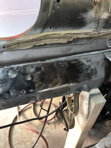

I was also planning on getting everything in epoxy but, I’m still waiting for filter cartridges for my mask that I ordered from Amazon last week that were supposed to be here this past Monday..then Tuesday...then Wednesday by 9:00 then December 24-25 now “Running Late”. So, I decided to address the pitted/thin metal on the firewall extension pieces (I forget what they’re actually called). I cut out the top portion surrounding the circle that is pressed into the metal:
You can see a lot of the pitting and holes in the metal, even after I sanded it. This is where I am now. As you’ve probably seen from previous pics, this area on the driver’s side got hammered by what appears to be years of getting soaked with mouse urine. This patch really kicked my ***. I was chasing blowthroughs in a few spots. I’ll need to cut another small patch to put to the left of the circle. Fun times!!
I called it a day because I could feel myself getting really pissed and nothing good comes of that (stupid mistakes). 1 step forward, 2 steps back :mad:
