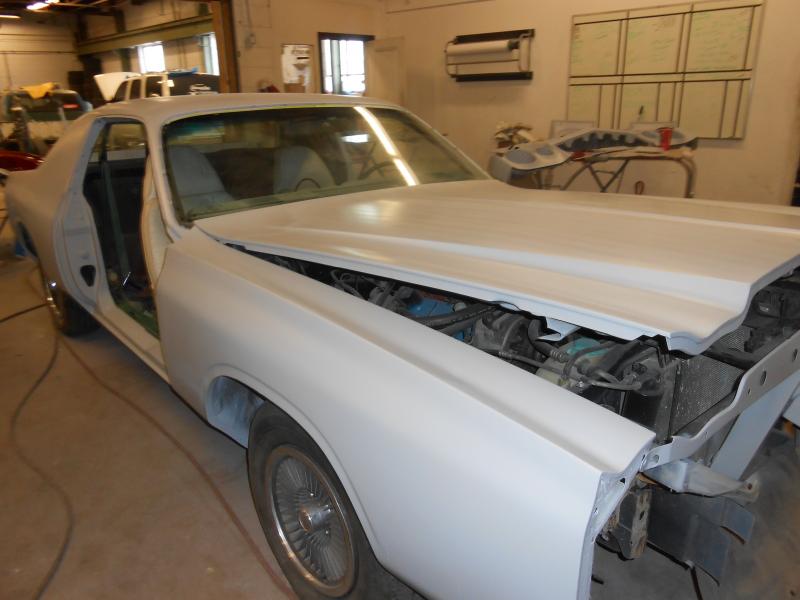

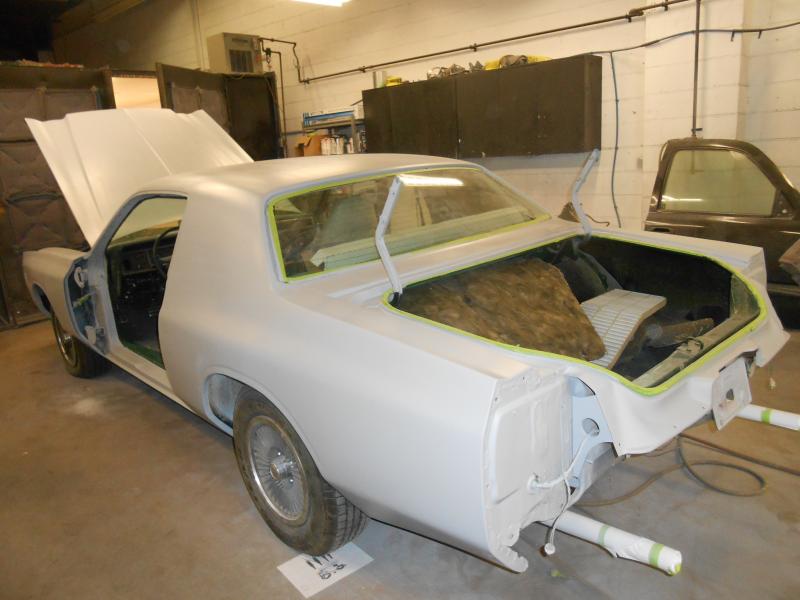

Photo update - car now has primer paint
The primer was finished on Saturday. Black paint is next.

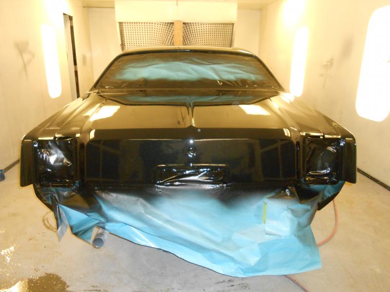

When I last posted, I indicated that we are ready to paint. In the passing time a number of issues arose:
  1. The painter rejected the prep work as unsatisfacory. He didn't like the line of the window removal on the drivers side and noticed five minor depression on the roof. When working with shiny paint imperfections are enhanced. The prep work was done over.

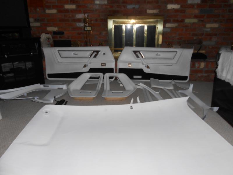

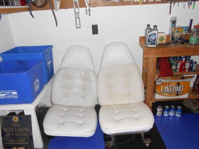

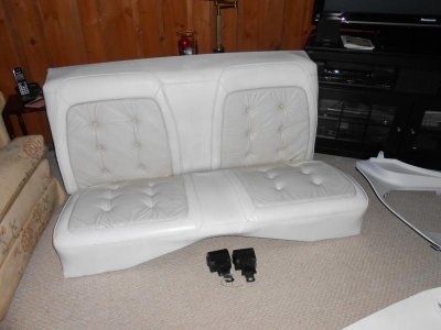

  2. We changed the interior color from green and white to black and white.. To make up for lost time, I have all the interior parts at home and am restoring them one piece at a time.
  3. My wife passed and i went into a funk which I'm working my way thru now. I'm dedicating this car to her and making sure everything is first class.

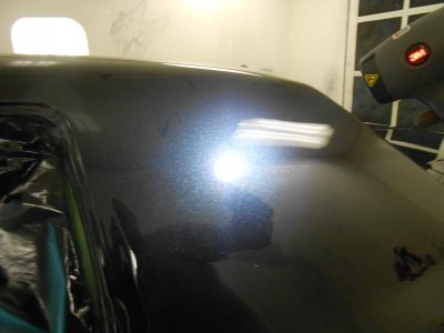

The paint work consisted of a sealer coat, three applications or paint and three clear coat application. The car will sit for 5+ days and then undergo a five stage wet sanding process. Hoping to get it to really pop. The third photo is taken from close up under bright light to show the effect of the metal flake in the bright sun.

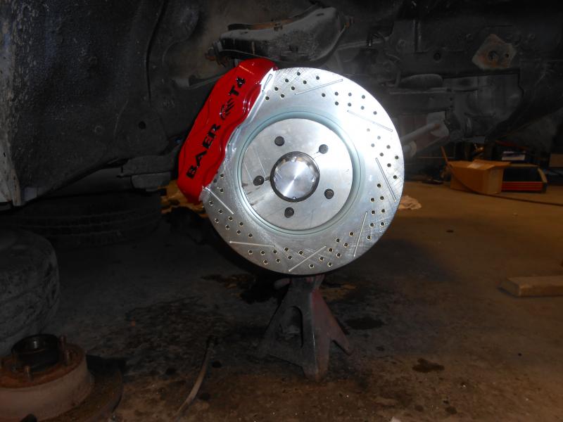

While the car was being prepped the second time, the brakes were done. A disc conversion at the rear and big Baer brakes all around.
On the home front, my rec room and one bay of the garage is full of restored and/or refurbished parts.

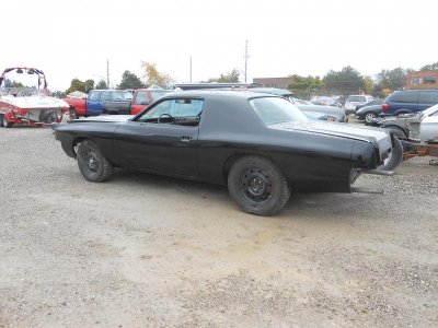

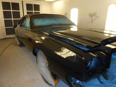

Painted doba
One more photo of the painted car provided to show the fender lines and the effect of removing the small side windows. The temporary wheels on the car are 17 in truck wheels. The original 15 in wheels do not clear the brakes.
When you reconditioned the interior plastic pieces did you encounter any pieces that were chalky, worn and faded? How did you recondition these? My 77 Cordoba has been with me for 30 years now, was my first car and is my favorite ride. I have plans on updating the interior but am stumped on how to proceed with some of the plastic pieces.
Most of the interior rear vinyl parts were sun roached. I got used maroon replacements from National Moparts in Beaverton and repainted all the interior pieces white with vinyl paint. In addition, the dash pad was cracked in two places. It so happened that National Moparts had an OEM replacement which I'll paint black.
I was not able to get a driver's side rear panel in great condition. the best I could do is one with a hole in it about the size of a toonie. The best place to get these parts repaired is a specialist in vinyl and plastic. If you can't find such a specialist in your area, the next best is a marine shop that does custom work on boats. The guy I'm working with is repairing damage on the console and rear panel. he's fixing the vinyl - I'm painting the final product to match the other pieces.

Until you pointed it out I didn't even notice you had filled in the side windows. My son and I have kicked that idea around many times but we were worried how it would look. I must say it looks awesome and I know what I'm going to do before I get it painted again.
