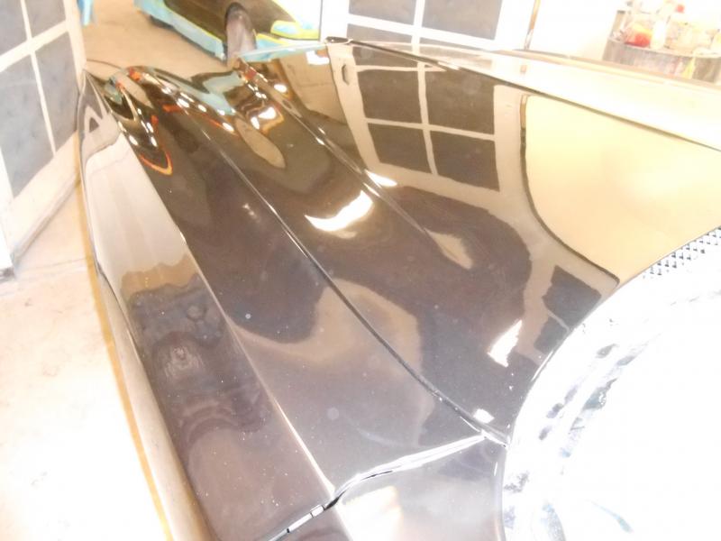

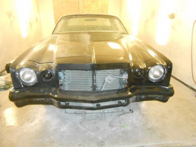

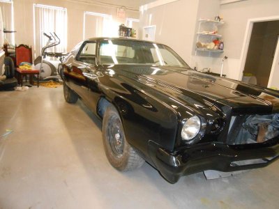

We began the cut, sand and polish in December and burned thru the clear coat. Rather than try to blend the burn in, both rear fenders and roof - about half of the car - were repainted. After sitting to cure the clear coat and the holidays the sanding process restarted this week. At the time these pictures were taken the driver's side fender and half of the hood have been sanded and polished.

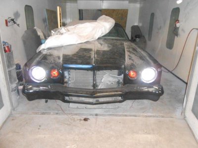

I apologize for the condition of the pictures but its hard to get good ones in a paint booth with all of the bright lights and sanding dust. The first picture gives you an idea of what the front will look like. The original bumpers are now the same black as the body colour, bumperettes, rubber protection strip and jack holes have been removed from the bumper, the trim surrounding the lights is also black and the lenses on the turns signal lights have been tinted black. To get a feel for what the front end will look like, imagine a black billet grill and modern headlights with black trim.

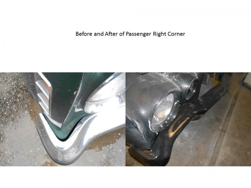

The next picture shows before and after of the passenger side right corner. While the spacing between the body and bumper is relatively unchanged, the gap is less obvious when the color is the same for both. Note also, that the side marker light is gone.

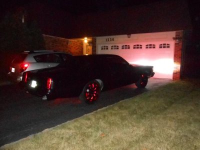

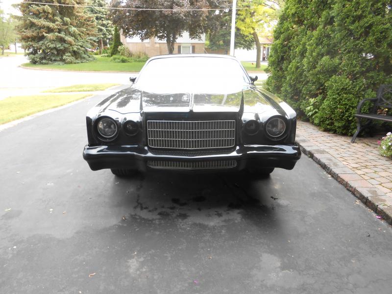

Thanks for asking. After the car was painted, it was sent to a detail shop where the clear coat was cut and polished. The following photo will give you an idea of the final colour. The headlights in this photo are the original seal beams. After detailing, the car went back to the body shop for final assembly which is still in progress. So far we have installed the LED headlights (this is a conversion package that fits the opening), installed the blackened chrome pieces and tinted the windows.

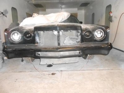

In the next image the LED lights are off.

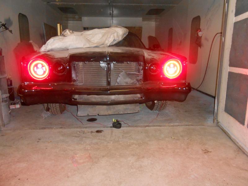

In this picture the LED headlights and orange parking lights are on.

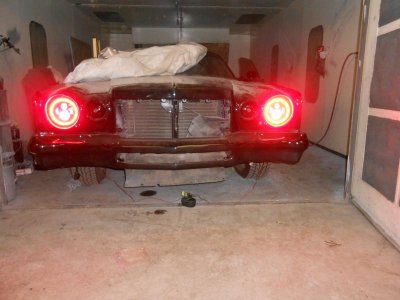

In this image, the LED red parking lights are on. The naked eye only sees red rings and not what the camera shows.IMG_110_Mar_21_2015.jpg

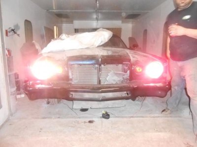

In this image the LED headlights, the orange parking lights and LED red parking lights are on. Note that you don't see any red i.e. the white light overpowers the red completely.IMG_111_Mar_21_2015.jpg

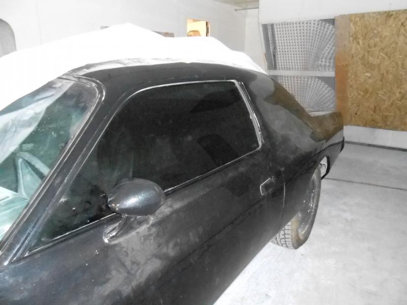

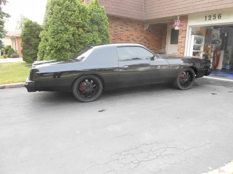

In this last image, I'm trying to show the former chrome parts (door handle, mirror and window trim) which are now the same colour as the body of the car. I leave it to you to imagine what it looks like without the dust. Lastly, notice that the windows have been tinted. I went with a 20% tint as I wanted to show the interior which will be white.IMG_108_Mar_21_2015.jpg

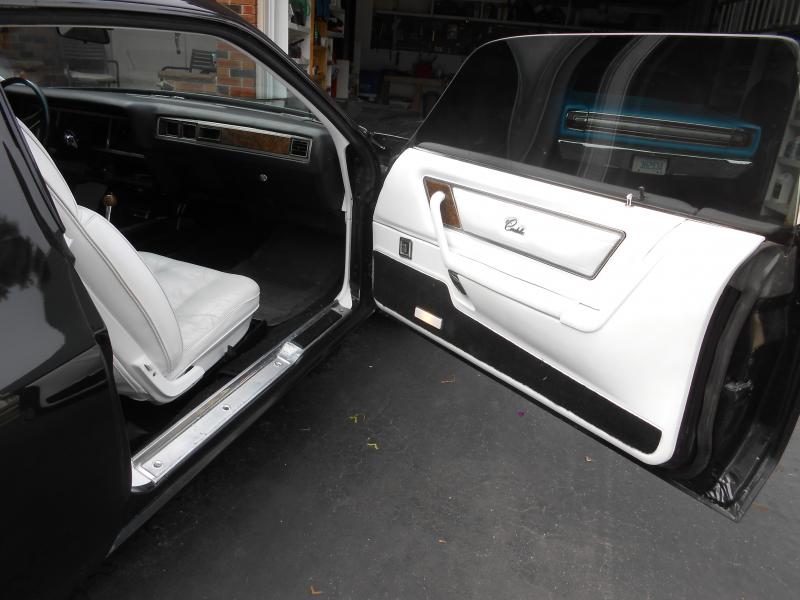

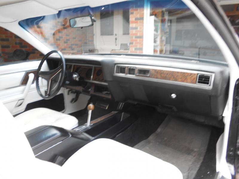

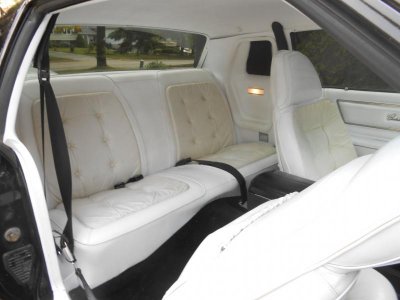

The interior has been installed. The radio was in a box in the trunk.

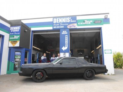

Still waiting for the wheels and have yet to hook up the halos on the brakes. In the meantime my attention has turned to smaller items. I plan on taking this car (in 2016) down route 66 (the A/C has to work), up to Vancouver and return home by an all Canadian route. It will take its maiden long distance trip to Quebec City and back and attend a family reunion in Quebec city on July 4. So I took it to Dennis' auto service to get the A/C working and find out why none of the gauges worked.
A/C was a snap conversion to the current gas in use and held the charge with no leaks. The circuit board had deteriorated at a point where all of the instrument power converges. They replaced the deteriorated section with piece from an unused section of the board, fixed the connections on the board and all of gauges powered up. Time to diagnose and fix was four hours.
A couple of things before the trip that I want done are to clean the gas tank and get a sending unit that works. I want to keep the large tank so as not to lose range between fillups on the trips I plan to make. Dennis has a sending unit from a 60's GTX that he's sure will work with minor modifications. I'm not really concerned how it might display as long as it shows empty when I'm low on fuel.

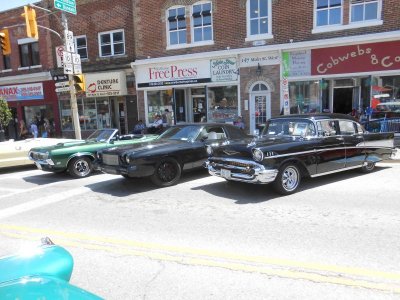

I did a 1.5 hr trip yesterday to an event in Shellburne ON as a test to see how things were working in preparation for Quebec City which is a nine hour trip. The car and the A/C worked well. We went up in a convoy with the 57 Chev in front and the Cougar at the rear. The passenger in the Chevy remarked that the Doba was a really spooky car to have following you. The ladies felt the car must have a female name.
As passers went by, we watched as they did a double take and tried to figure out what kind of car it was. The registration was of no help. The make was shown as Chevrolet and the model was shown as Doba. The ladies had fun with them and were soliciting names for the car and pushing their personal favourite "Morticia".

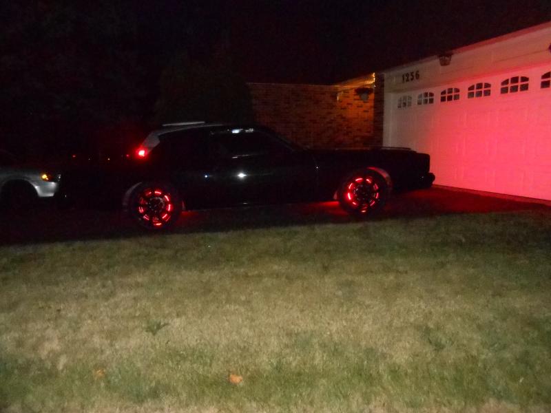

Got the wheel lights finished today. Here a couple of night time shots.
lookin' good ! I was wondering if you changed the rubber isolators to solid yet? My 79 300 are in good shape but I hear that they really make a difference in how it handles.
