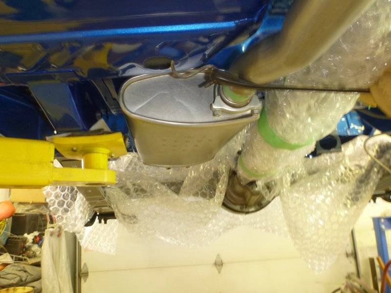

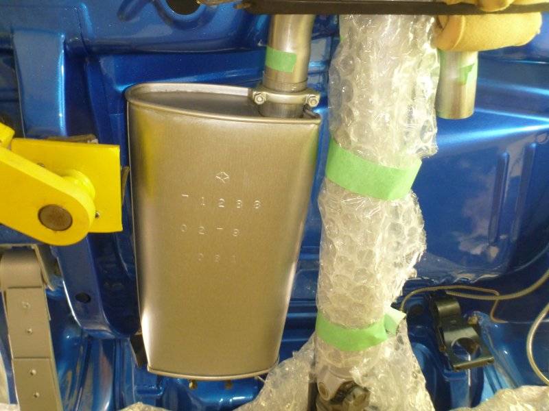

Your exhaust is a cobbled up mess. See the hangar? That is the clamp for the tailpipe to muffler also. The muffler should be in that hanger where it is now. The mufflers you had on there are way to short, and the tailpipes go to far forward because of it. The correct muffler you now have will never hook to those tailpipes.
Yes i already noticed that myself.
Do you think they also bent the tailpipe somewhat towards the muffler? (So it's closer to the muffler)
I mean i first have to take another look at the car in person but i already tend strongly towards buying all new pipes, clamps and hangars.
Basically everything except the mufflers and exhaust manifolds. (Which i already have) :D

Today we looked at the car once again and came to the conclusion that with the right pipes and hangers the mufflers should fit.
So i'm looking to buy exhaust parts TODAY.
I already have the correct mufflers and exhaust manifolds.
Before i place an order can someone confirm
A: there is nothing missing in the following list of parts im looking to buy
B: these are the correct parts for a 1969 dodge charger r/t 440/727
2x 1966-70 Mopar: B-Body Muffler Hanger (Multiple Options!)
2x 1966-71 Mopar: Saddle Clamp (2.25")
2x 1966-71 Mopar: Exhaust Flange Gasket (2.50")
1x 1968-69 B-Body (w/ 440 CID Engine) H-Pipes
1x 1968-70 B-Body Tail Pipes (for Chrome Tips) (They are sold as a pair, right?)
Could that possibly be the problem?
Also i'm thinking about buying new pipes instead of modifying the old ones.
These should be the correct ones for my car, right?

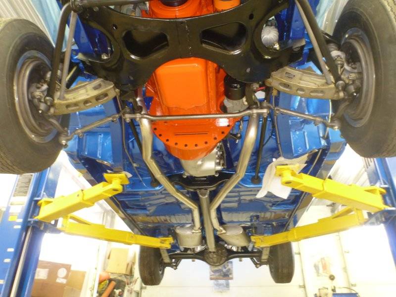

Those mufflers, H-Pipe, and tail pipes w/chrome tips and proper hangers were what went on my '69 Bee and fit just fine (33 years ago, damn I'm old now). They do fit close to the floorpans, and if installed improperly, can bang on the floor at times.
When I put mufflers on my H-pipe and tighten clamps I don't really crush connection. Crush a little then loosen muffler clamp and drill a hole for a small sheet metal screw. Put the screw in and move muffler clamp to cover screw. If you need to remove H-pipe in the future it will save you time.

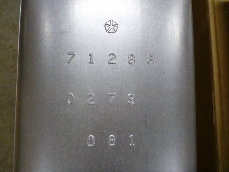

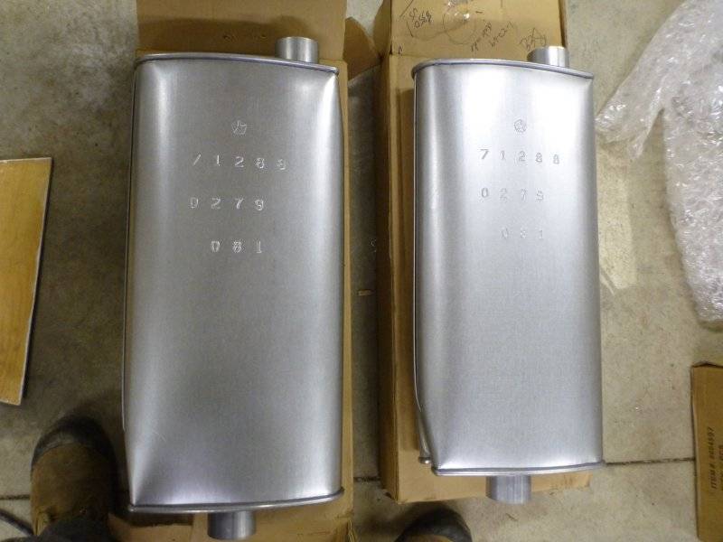

Install the mufflers you got as they are correct. No trouble to expect from that side considering the noise.
If it doesn't fit: Try to adjust it and get it working. The exhaust system is not rocket science and your Charger not on a OEM judging

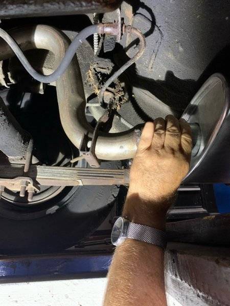

So you’re saying that boomerang pipe on the drivers side is 100% correct along with the muffler being crooked as a dogs hind leg? None of my 4 440-6 4 gear 69 bee’s ever looked like that. The mufflers were almost straight in-line with the body. My 69 383 4 gear car was also parallel with the body. Kim
